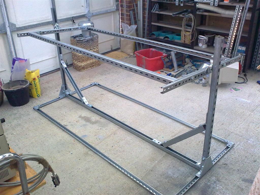

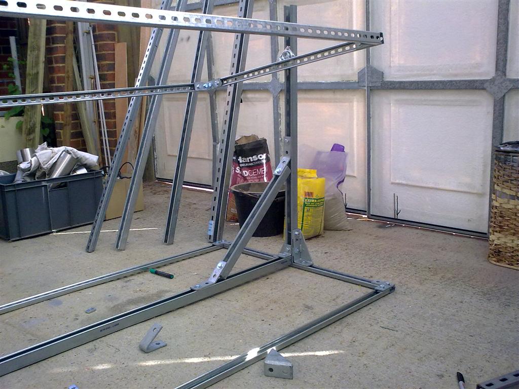

    Hi Guys,
    This is the start of a project thread for my Joyrider design simulator. The design of the simulator is based heavily on Thanos's Joyrider but will be made out of much studier parts. I will also be using Thanos's AVR and H-brdige to drive the motors.
    Obviously building the Joyrider out of studier/heavier parts means that I might need a more powerfull H-bridge / motor combination. (I'm hoping R-eng's HPMhb-150A (High powered H-bridge) will be ready in time :)). I will be using a 24 monitor and G25 wheel/pedals as the simulator will be mainly used for driving games.
    I spent most of Sunday building the frame. Here are some pics of the progress so far 8)
    Everything is fully adjustable at this stage so the height and width of the simulator can be tweaked as it progresses.
    The next step is to start work on the inner frame which will include the seat and control mounts. Have been searching ebay for a cheap bucket seat :).
    I've started creating a shopping lists of parts for the AVR which I will order from Farnell soon.
    So what do you guys think so far? Does anyone have any comments or suggestions?
    Cheers,
    Simon

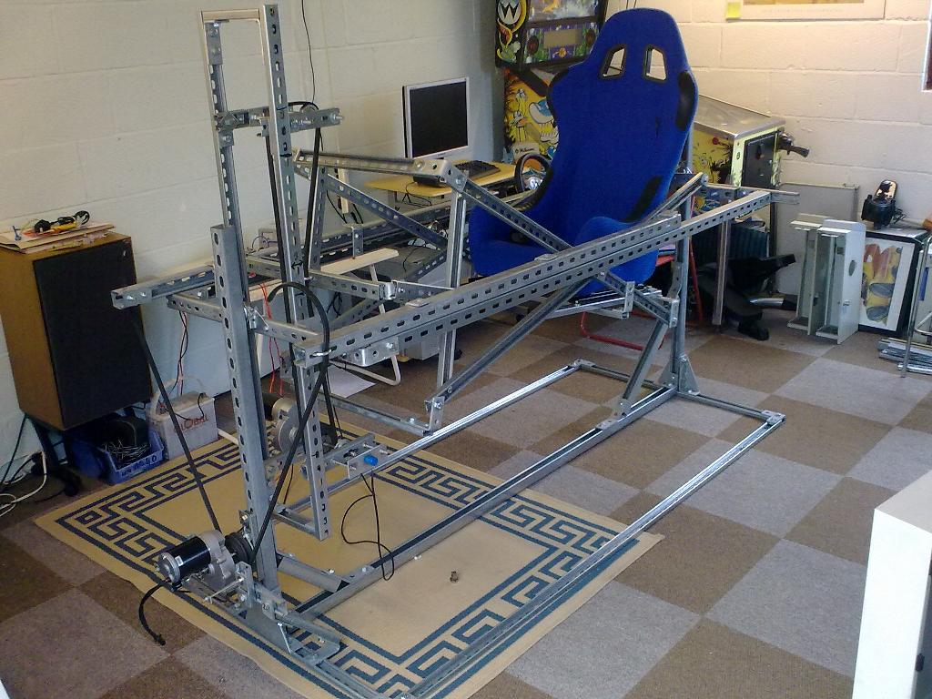

  3. tronicgr
    tronicgr
    Hi Simon,
    You need more sideways support... Doesn't look enough to me!!!
    And its good idea to start building the inner cockpit frame around the bucket seat dimensions. Also try to balance things not only in horizontal but also in vertical manner, since with rotation you will get more mass offset...!
    Thanos

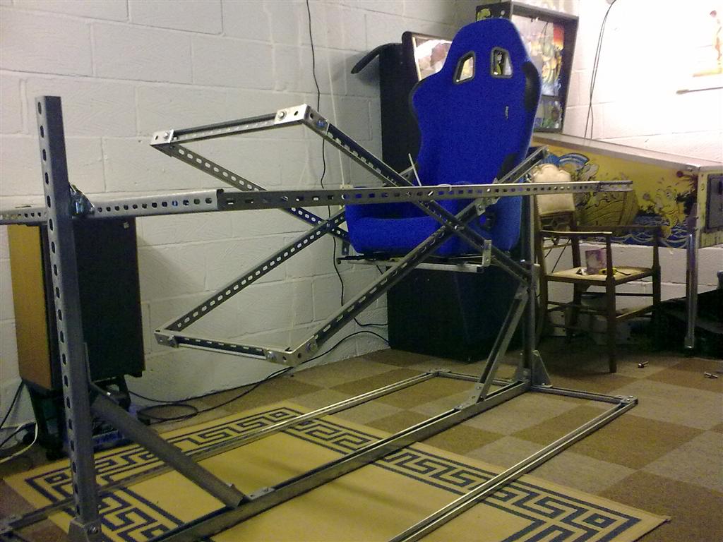

    Hi Guys,
    The simulator is progressing well and I have even made a start on the AVR and H-bridge electronics.
    Here you can see I have started work on the inner frame. The angle of the foot support and screen support will need changing and also the seat is only resting in place at the moment.
    In response to your question Thanos, the sideways support is more than enough. The base is very very solid as the metal work is so strong!

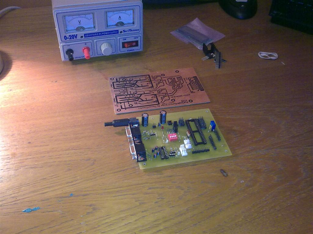

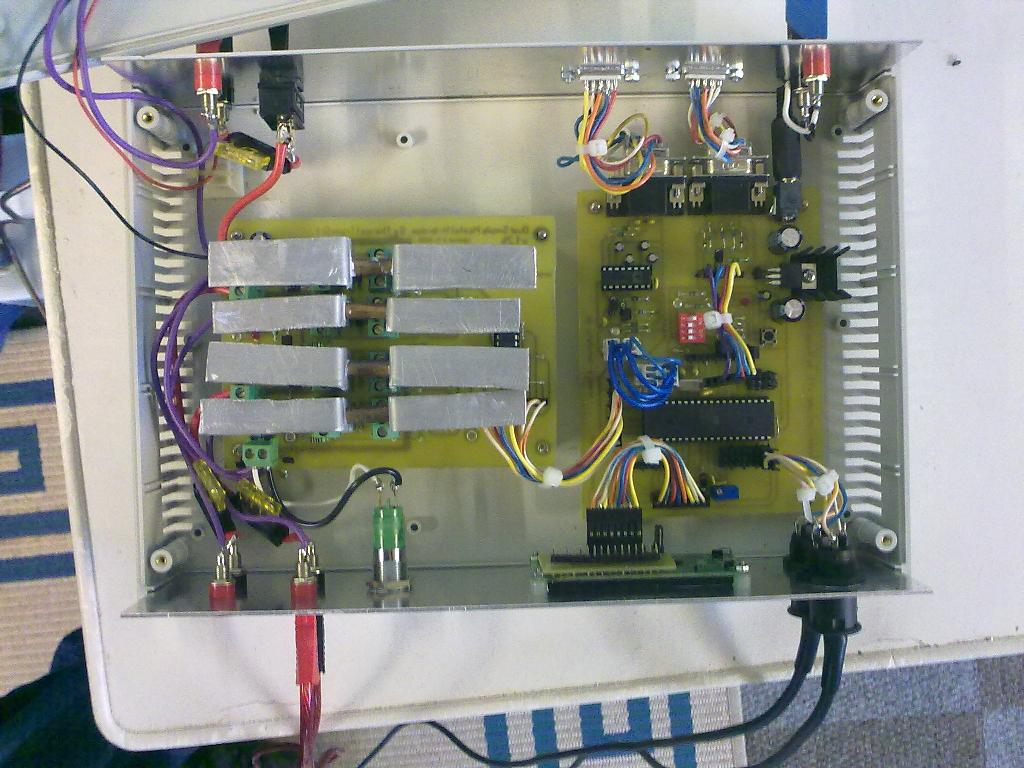

    Here is the almost complete AVR electronics and the H-bridge which is ready to be etched.
    Its my first time making PCB's at home and the've turned out quite well using the Iron on method.
    I'm hoping the DSMhb will be powerful enough to drive some 180Watt motors that I have my eye on.

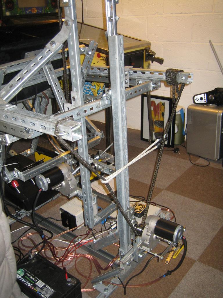

    Update
    Bit of a progress update for you guys. Have recently had some time to work on the simulator a bit more and things are coming along nicely!
    Thanos's AMC and Hbridge have been fulled assembled and tested.

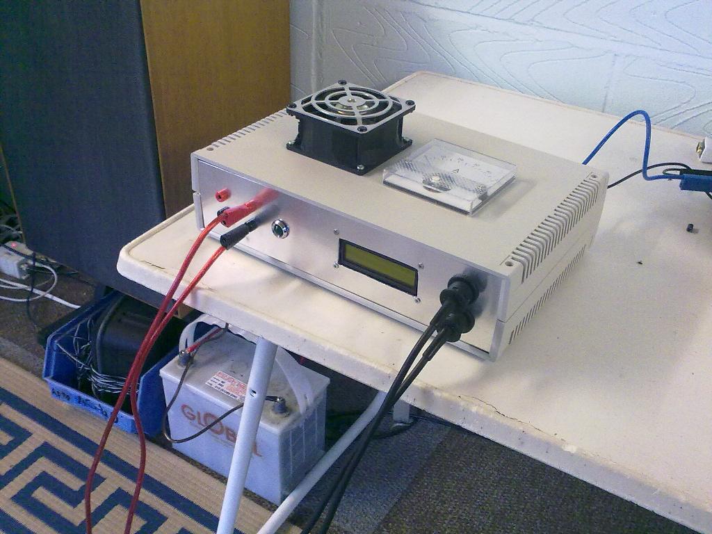

    Here is the box for the electronics:

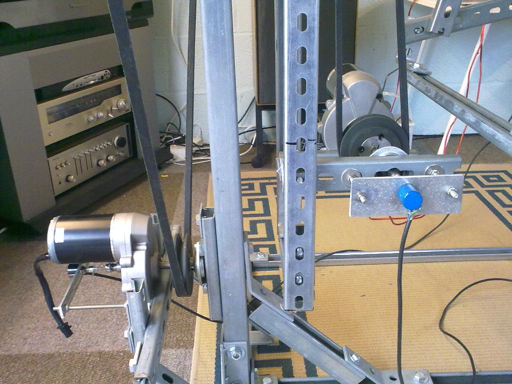

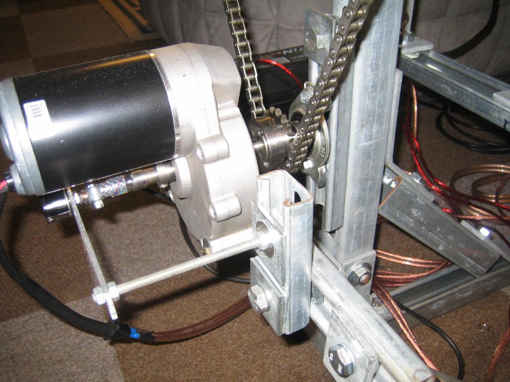

    Both motor mounts have been constructed. For the Roll axis motor I have mounted it differently to Thanos's original Joyrider. This arrangement seems to work well although at the extremes of the motor travel the tension in the belt becomes looser and the motor starts to slip. I'm currently working on a fix for this. Does anyone have any other ideas?
    Here are some more pictures:
    Next thing to do is to mount the pedals and steering wheel and then I can find the perfect balance point for the simulator.
    Simon

    To get rid of the belt slack, use some sort of adjustable tensioner.

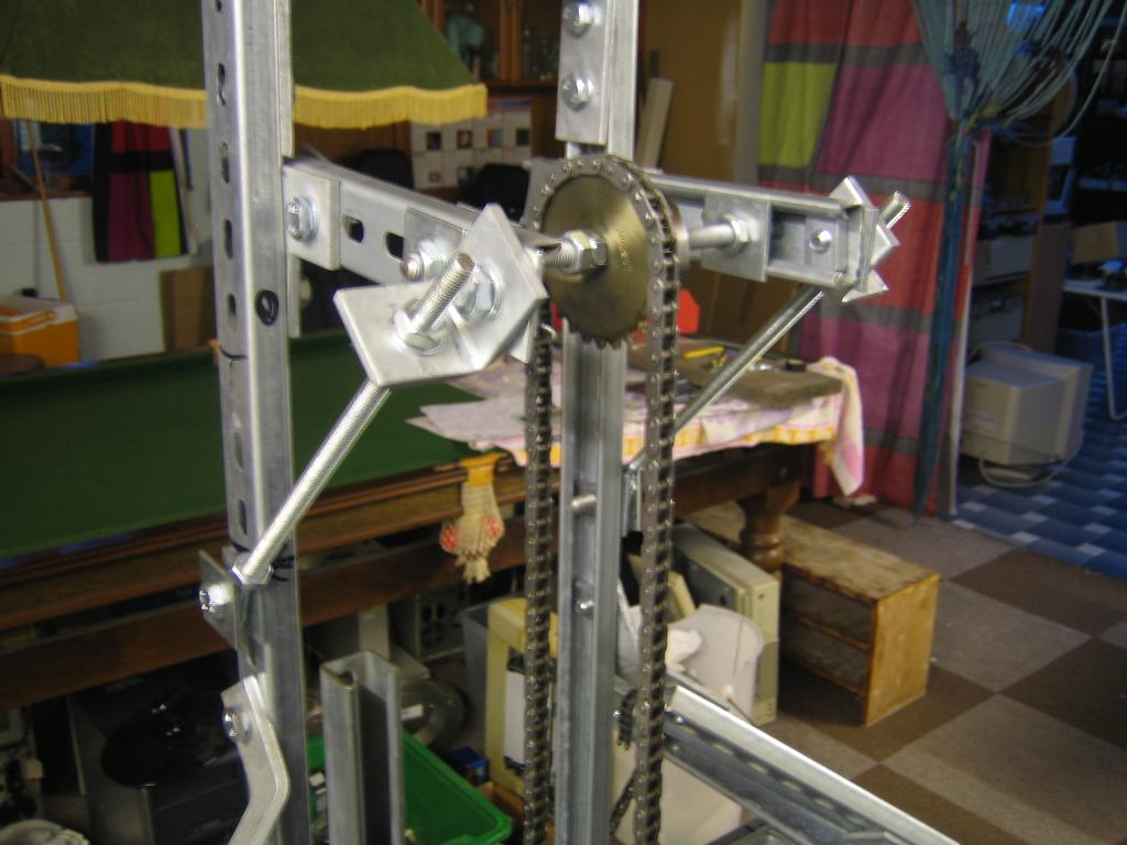

    Today I had my first proper ride in the simulator! I was having issues with the belt slipping under quick changes of direction so I have decided to get rid of the belts and use chains intead 8) . The results are much better now.
    I think I now have a problem with Thano's H-bridge circuit. One of the motor outputs gives nice smooth movements, but the other output causes the motor to be very jerky and overshoot. What could be causing this?
    There is still lots of fine tuning to go but here is a quick video so far:
    http://www.youtube.com/watch?v=_ukltGtmsP8
    Thanks for the suggestions on fixing the slack in the belt. I'm using a horizontal bungee cord to keep the chain tight and it seems to be working well!
    Simon

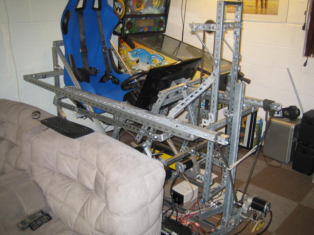

    Just a small update on the simulator.

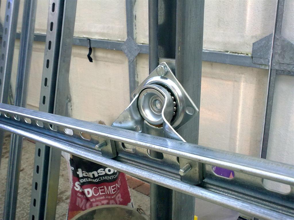

    I've attached some pictures of the new chain setup. This has greatly improved the performance of the sim as there is absolutely no belt slippage now :).
    Here you can see my bungy chain tentioner:
    I've also strengthened the top mount for the pitch motor assembly:
    Bank motor with hosepipe connection to potentiometer :)
    And finally a new video of the sim in action running Live For Speed:
