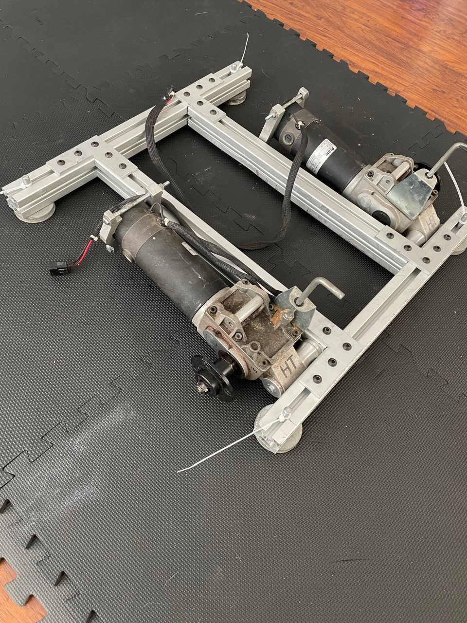

    I am using two wheel chair motors.
    Arduino with Monster Moto Shield.
    Extruded Aluminum.
    https://photos.app.goo.gl/xA4P1PPXdaCP5P9f7
    https://photos.app.goo.gl/77ZGAm5GS8mPhmmv7
    I have a steel frame made with a seat and my steering wheel but plan on rebuilding it out of the extruded aluminum.

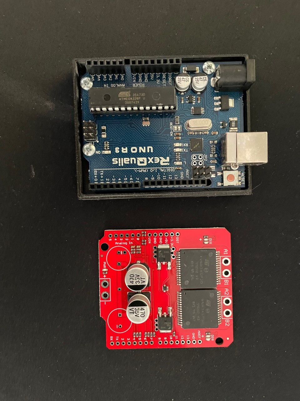

    Looking for some advice... I am using the MotoMonster shield which is 16v... I cant seem to find a 16v power supply. I would use a 12v power supply but the motors I am using have brakes built in and in order to disengage the brakes it needs 16v or greater. Should I ditch the MM shield and go with something that can handle 24v?
    21,032
    147,890Coins
    +10,880 / 54 / -2
  6. Gadget999
    1,935
    11,838Coins
    +473 / 9 / -0
    remove the brakes - you should not need them
    consider raising the motors up a bit so you can get longer crank arms fitted

    I did remove the brakes right after I posted haha... as far as longer arms how long should the arms be do you think 6 inches, 8 inches, 10 inches? I am 3d printing arms right now just for testing but will hopefully get them laser cut out of steel once everything is fitted and set up properly.
    21,032
    147,890Coins
    +10,880 / 54 / -2
    It depends a bit on the design dimensions, have a play with SimCalc: https://www.xsimulator.net/communit...e-linear-speed-and-forces-of-your-design.270/
    But for a compact design rig with those motors try about 60mm CTC on the levers.

    Has anyone used this ... turns out my moto monster shield was bad only 1 motor goes both directions the other one only goess one direction

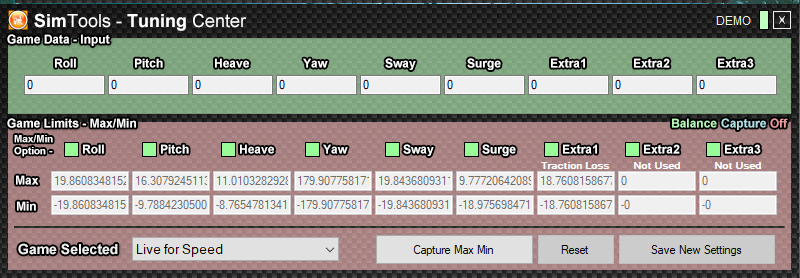

    I got my chair up and running but am having a weird issue where i almost complete a lap in LFS and one of my motors just shuts down. So I have a few questions...
    Does the max limits in SMC3 matter? For example is my chair hitting the limit and shutting down that motor?
    Every time I edit the LFS profile do I have to uninstall and reinstall the patch? Reason I ask is if I set everything to zero and just have pitch going it seems like its still making all the other motions.
    Last question I would like to get the simchair working with beamng whats my next steps? Get my free license and then download the BeamNG.drive plugin?
    21,032
    147,890Coins
    +10,880 / 54 / -2
    Yes the SMC3 limits matter and will trip if exceeded, as a safety response, see the explanation for all SMC3 settings in the second post: https://www.xsimulator.net/communit...driver-and-windows-utilities.4957/#post-48121
    No you do not need to re-patch after changing settings. You can use the button top left of Game Manager while a game is running to disconnect SimTools, make whatever setting changes you want, then use the same button to reconnect SimTools with the new settings to the already running game.

    Thank you so much for the response that will make tuning a lot easier. Im starting to think i am having a thermal shutdown issue if i feel the motor driver it is very hot. It also kills the motor random for example I was on a straight away and one of the motors just quit. Not sure what to do I could add some heatsinks and a fan and see if it corrects the issue or buy a bulkier motor driver just not sure what would be a good one.
  16. noorbeast
    21,032
    147,890Coins
    +10,880 / 54 / -2
    If you are using MMs they must have heatsinks and fans.

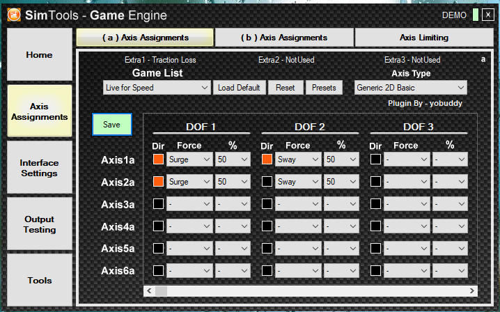

  18. zach bladow
    zach bladow New Member
    Sep 25, 2018
    17
    177Coins

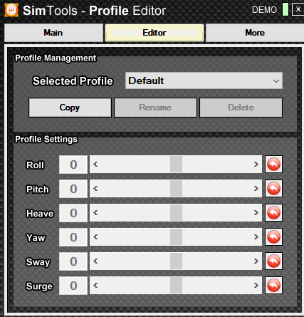

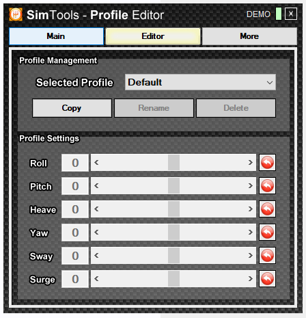

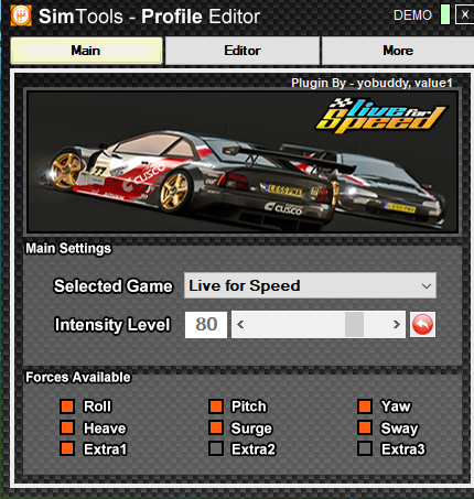

    I have everything below set to 0 but my chair is still moving is it because on the main tab I have that at 50? I am trying to get more sway when I turn but its hard to adjust when the chair is moving every direction lol.
  19. noorbeast
    21,032
    147,890Coins
    +10,880 / 54 / -2
    Please post pictures of your Axis Assignments and Tuning Center for sway.
