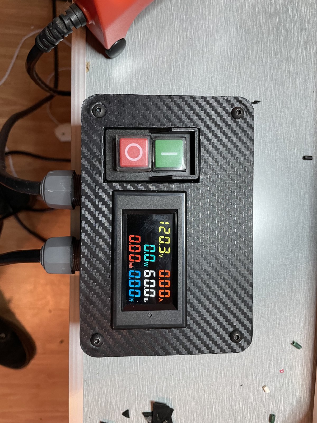

    I just wanted to update and thank you guys for the advice.
    I performed all of the changes outlined in the guide you provided Thanos, adding ferrites to my wires, and adding the EMI line filter to the actuator power loop, as well as utilizing a common ground. I am very happy to report that this has eliminated tracking issues with both my Valve Index and Vive Pro 2! They both function flawlessly now with the tracking precision you would expect from a lighthouse based system.
    I have also designed a small box similar to the one you built to house an on-off switch for the actuators, a little volt meter, and the EMI line filter in one nice little package.
    I will be uploading the files and parts list for this box to thingiverse soon so that anyone can make one if they like!

  8. Thanos
    Jul 6, 2017
    1,358
    Electronics Engineer
    United States
    2,772Coins
    +1,050 / 9 / -0
    Nice looking power box!! :cheers
