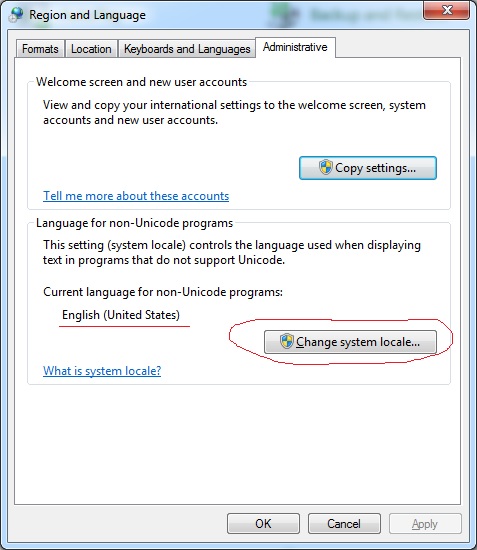

  2. yobuddy
    51,366Coins
    +5,202 / 19 / -0
    Maybe try this system local setting buddy.

    Hi @yobuddy,
    I'll test this soon, but I don't think this will resolve the problem because I have no problem when I use other codes on the Arduino. I'll keep you updated.

    I changed the thread title to "Resolved" because I don't have issues anymore. I didn't change the "system local setting" but it works perfectly well. The problem was coming from, I think, the Arduino library...
