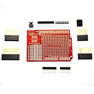

    3. protoshield (Free $4 amazon)

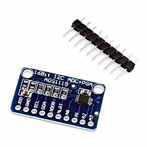

    5. ADS1115 16bit ADC converter ($6.99 amazon)

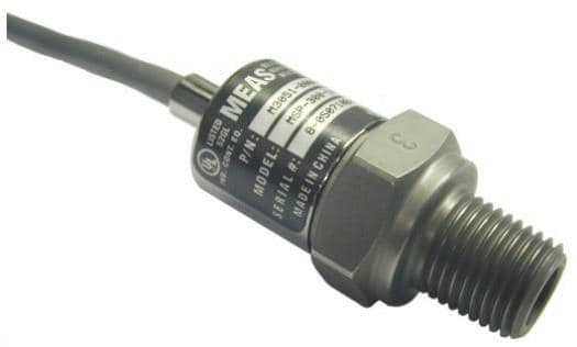

    6. TE M3031-000005-05KPG transducer ($68.32 mouser.com)

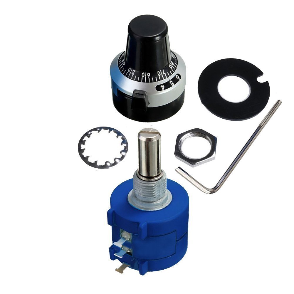

    7. 3590s-2-502L 5k 10 turn pot (11.99 amazon
    8. Retractable reel with metal clip (Free or 5.99 amazon)

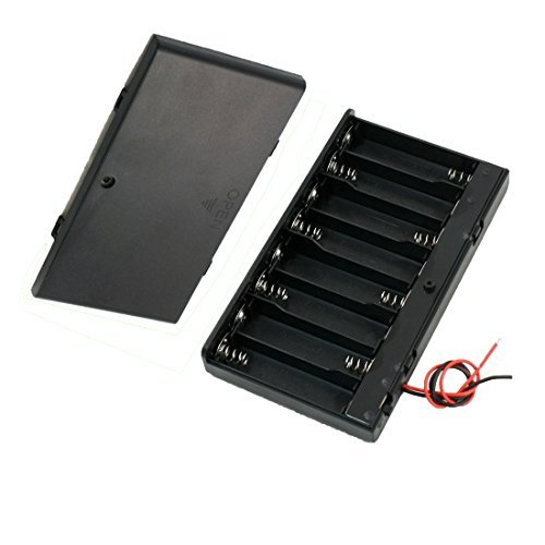

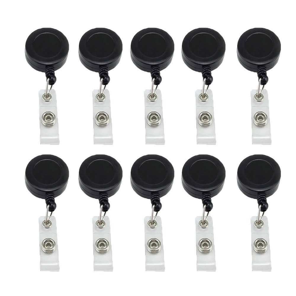

    9. 8 x AA battery box with on/off switch (Free or $4 amazon)
    I picked up the press a few days ago and have that already assembled, I did my first test just to see and I was quite surprised. This was a PLA part printed nearly solid and when it failed it did so very violently. Luckily I was protected and anticipating the failure, but a safety guard will be a must for future testing.
    ADS1115.jpg Proto.jpg Batt.jpg Sensor.jpg Reels.jpg Pot.jpg press.jpg TFT.jpg uno.jpg

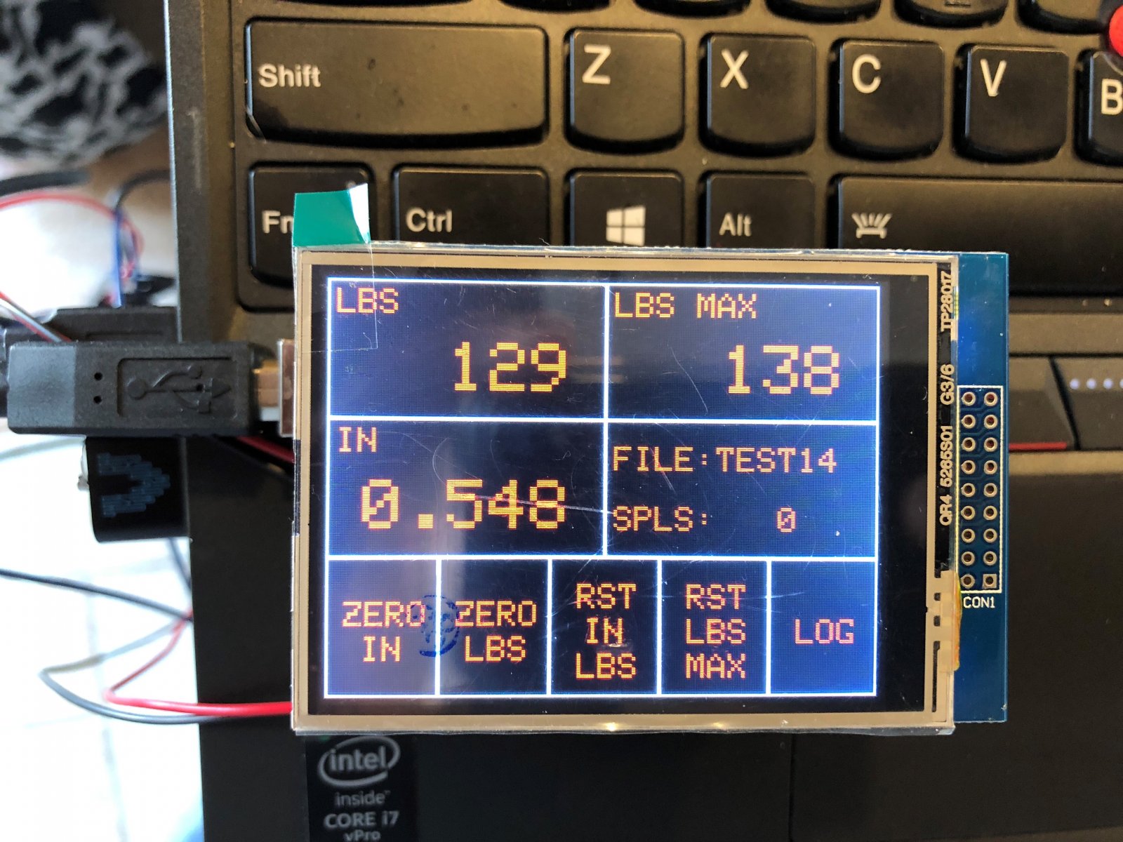

    I got the first batch of parts today and started writing the arduino code. I just did a quick mock-up with the ASD1115 and a couple of 1/4 turn 5k pots. I'm not a programmer so I worked through the sample sketches for each function I will be using (LCD,Touch, SD Card, ASD1115). Each worked well enough on there own, however when I tried to merge the LCD sketch and the ASD1115 sketch I had some problems. turns out that the ASD1115 uses analog pins 4 and 5 and the lcd used analog pin 4 as the reset pin. so every time I try to read the values from the ASD1115 the lcd resets. I ended up clipping the lead on the LCD and rewiring it to the arduino reset pin. I also had to change the reset pin in the lcd sketch. Other then that everything is going pretty well, just working through some formatting issues before I merge in the touch and SD logging.
    Here is what the screen will look like. Black background and red text, its hard to tell in the picture.
    I am still waiting for a few parts (mainly the pressure sensor), in the mean time I will clean up all of my wiring on the arduino and keep plugging away at the code.

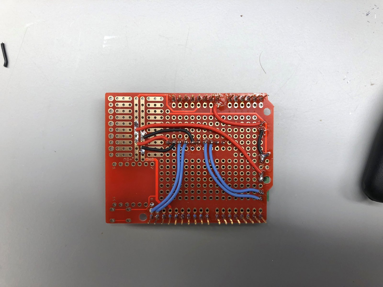

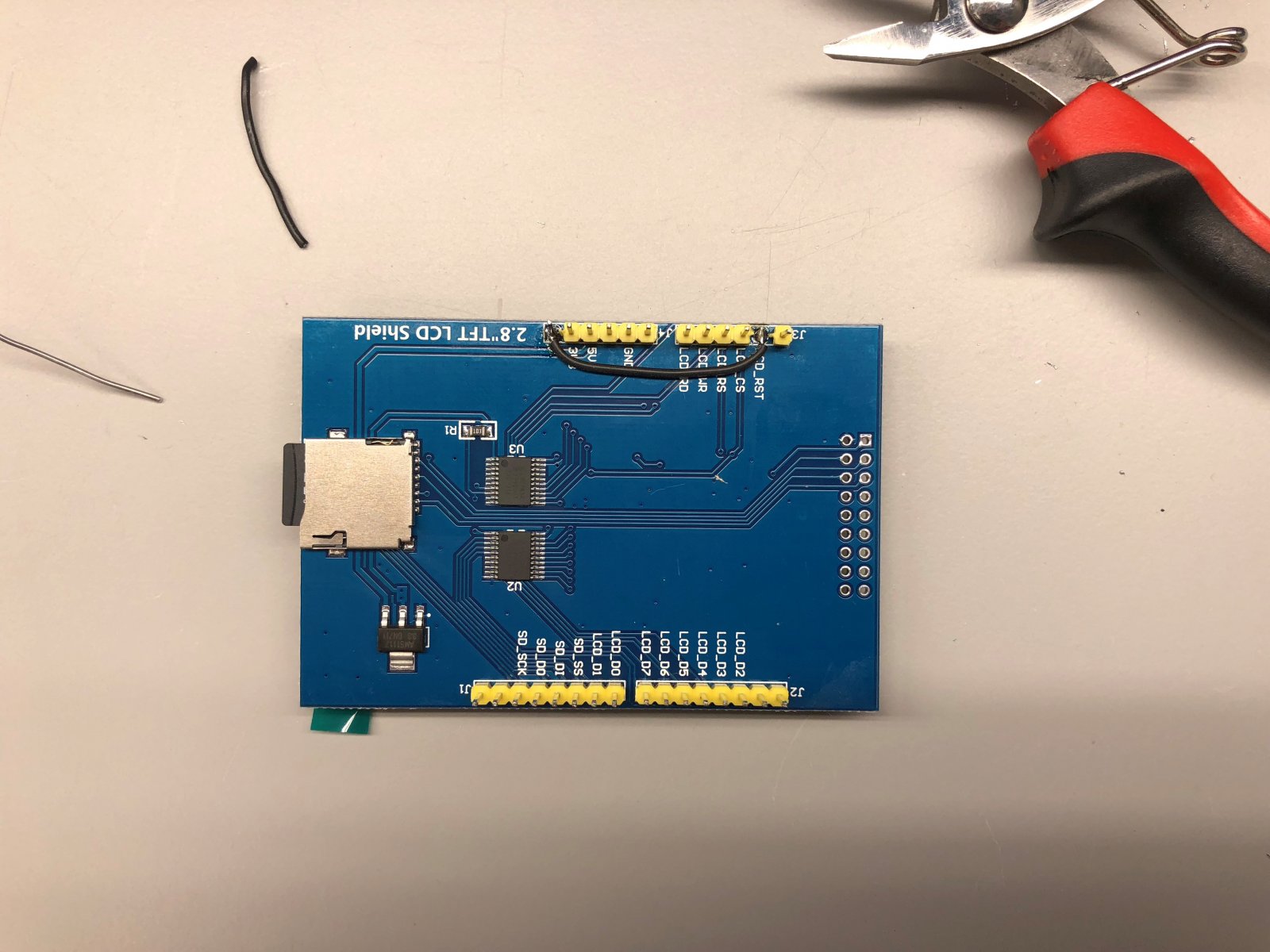

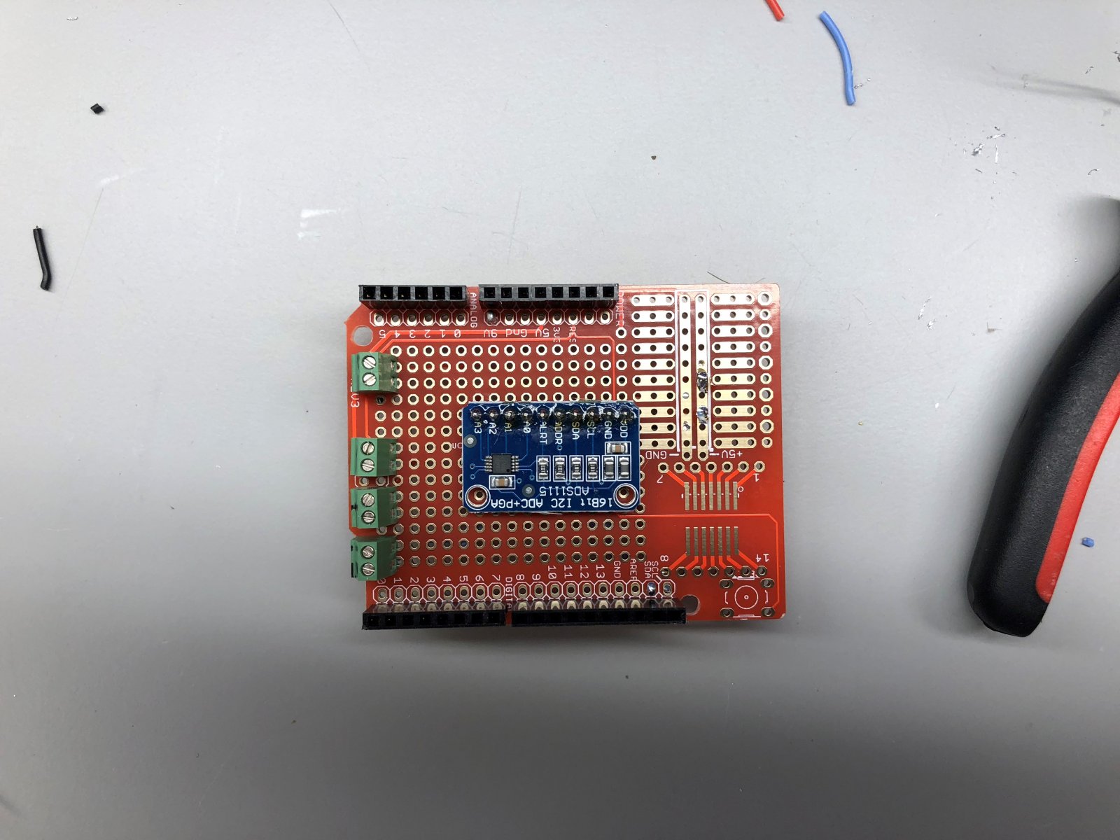

    I have all of my parts now so I soldered up my uno shield to accept the ADS1115 board. I also added some screw terminals for the battery box and the two sensors.
    I also made the final modification to the LCD shield to eliminate the reset pin issue.
    I think I have the software side finished up, not going to lie it was a struggle over several nights. Here is the final display configuration.
    When the log button is pushed a text file is created on the SD card and Time, Pressure, Max Pressure and Inches are all logged every .1 seconds. A second push stops logging and a third will start again with a new file and so on. The files are easy enough to bring into excel so that I can plot the data for future use.
    This was the part of the build I had planned on struggling with, the rest is mostly mechanical stuff so if I can find the time it should go pretty smooth.

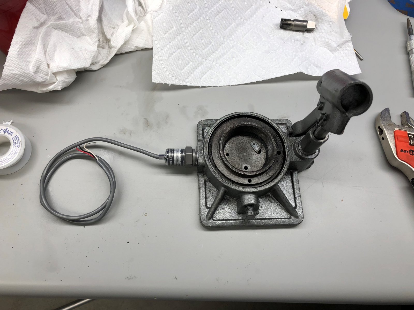

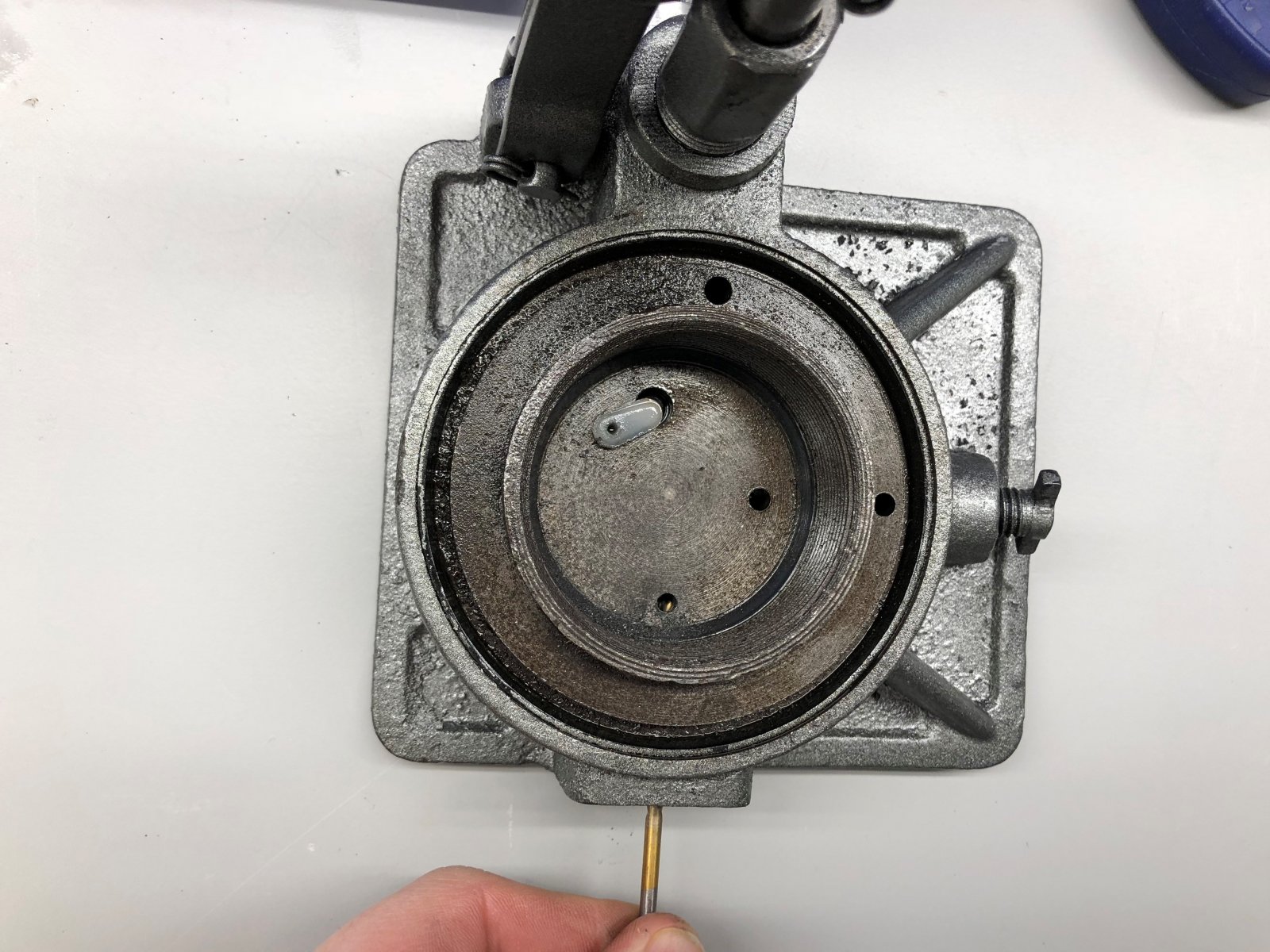

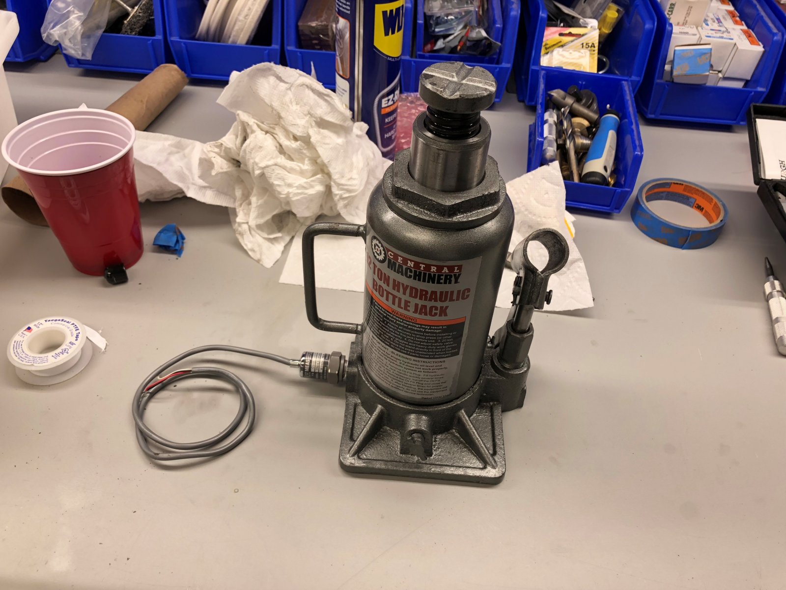

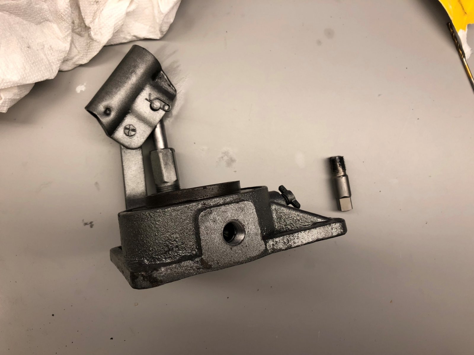

    I completed the dirtiest part for project, installing the pressure sensor.

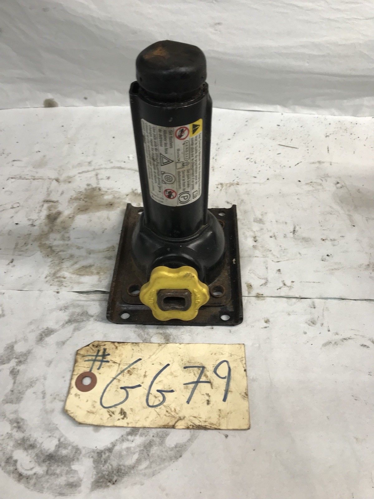

    First I disassembled the jack by removing the large nut on the top. It was on pretty good, but I have 24" pipe wrench that made short work if it. This is with the piston, cylinder and housing removed. I drained as much of the oil out as possible before disassemble.
    Then I drilled a port with a 1/8" drill bit, I had to drill down about 1/4" from the top and then drill in from the side to get a clean hole from the pressure chamber out to where the pressure traducer will be. I did pretty good for hand tools, but I missed the mark by about 1/6" of an inch. In the picture you can see the gold of the drill bit showing that the holes overlap.
    Next I chased the outer hole with a 7/16 drill bit and then ran my 1/4 npt tap through. My tap was too long so I had to shorten it after each run, one time use now.
    Here is the pressure transducer installed, I used Teflon tape on the threads prior to assembly.

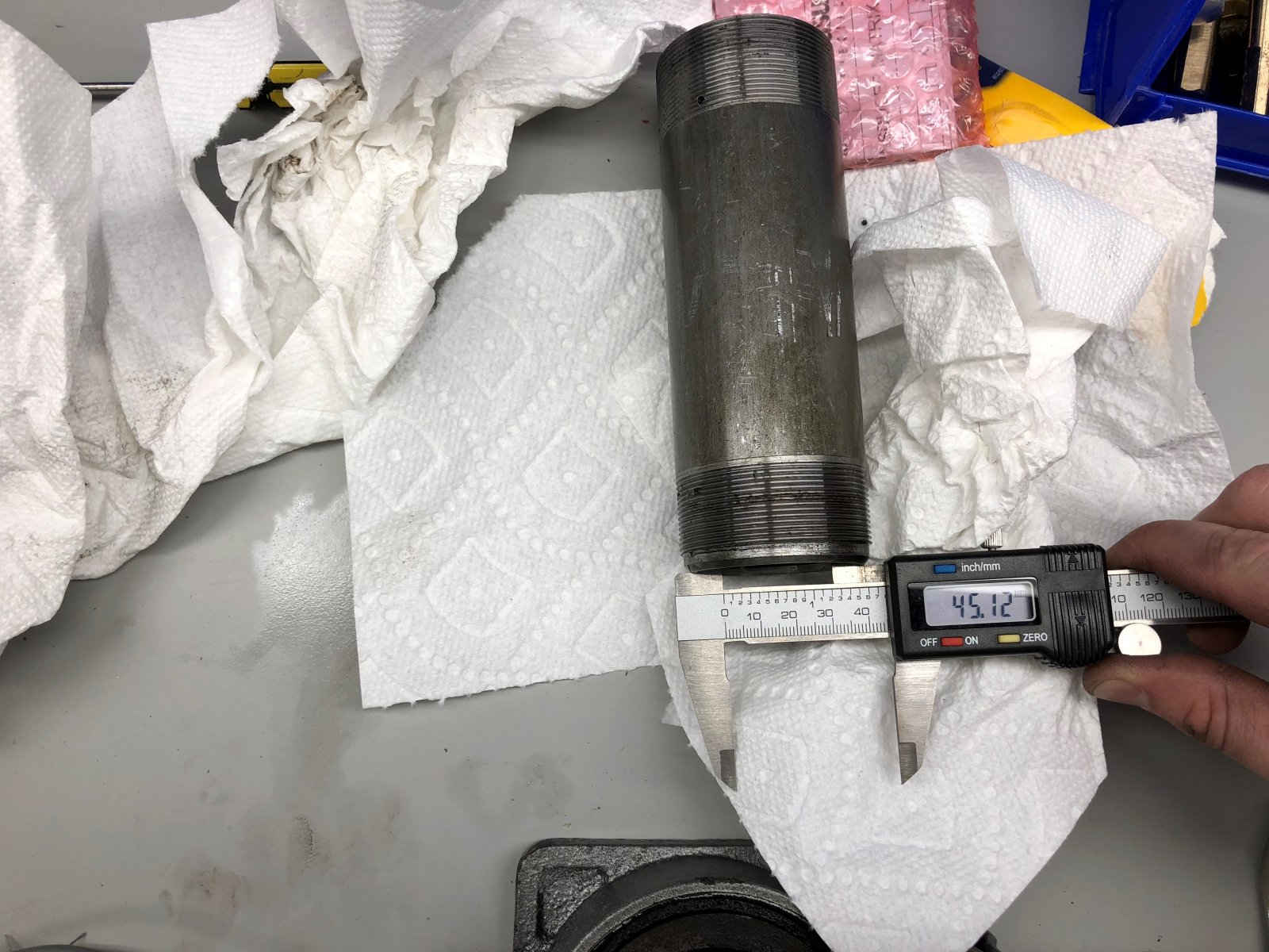

    Before re-assembly I needed to measure the inside of the cylinder so I can do conversion calculations from pressure t0 lbs. I took several measurements and they all ranged from 45.09mm to 45.12mm
    Finally here is the finished assembled jack, I haven't had a chance to test yet because I need to put the oil back in and bleed it. when I re-assembled it I moved the jack handle to the side, that will give me a good location to mount my string pot and a guide for the pressure transducer wires.
    Here are my calculations for the conversion from PSI to LBS in the arduino.

    @Hoddem that's a quality job, you did well to line the holes up so well. But what made you choose to use a fluid pressure transducer instead of a piezoelectric transducer? The latter would have been more simple to install.

    That’s a good question, like most projects this one evolved rather quickly in my head. The original plan was to use a hydraulic pressure gauge and just tap into the jack. No electronics were to be involved and I planned on just converting the psi reading to lbs in my head. Once I had that idea I couldn’t get it out of my head and it kept growing until I ended up with a display and a pressure transducer ("Scope Creep"). I really liked the idea of taking a cheapo bottle jack and converting it to read out in lbs. in fact that was actually the part of the project that got me to pull the trigger.
    I did look at using a load cell, but the cost from my quick search was pretty high.

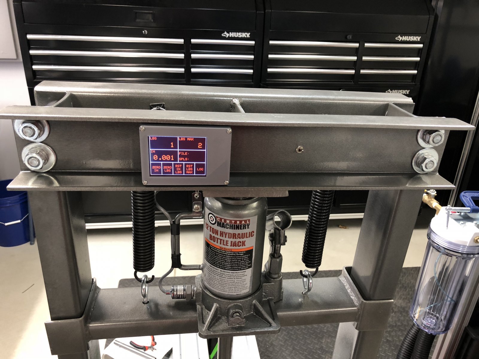

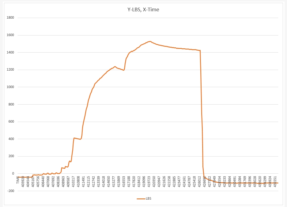

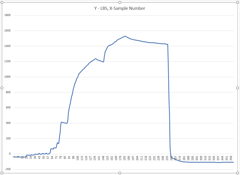

    Tested the jack and all seems good, It looks like the jack naturally has some leakage and when under pressure it slowly creeps back.
    Here is a test with only the pressure transducer hooked up.
    The arduino updates all of the values and logs every .1 seconds, each quadrant of the screen is updated every 4th cycle. That's why the max pressure seems to lag behind the current pressure and values jump a little bit. Turns out the screen is pretty slow so if I try to update everything at once it takes almost half a second, in order keep my logging cycles up I had to split the screen updates into quadrants.
    I had my multi-meter hooked up and the values are tracking according to the datasheet, I will need to come up with a way to sanity check the values.
    I did a second test and tested the logging function. Here are the two graphs from that run, one is using the sample number as the X axis and the other is using the time as the X-axis. Once I get the string pot hooked up the values will be plotted using travel as the x axis.

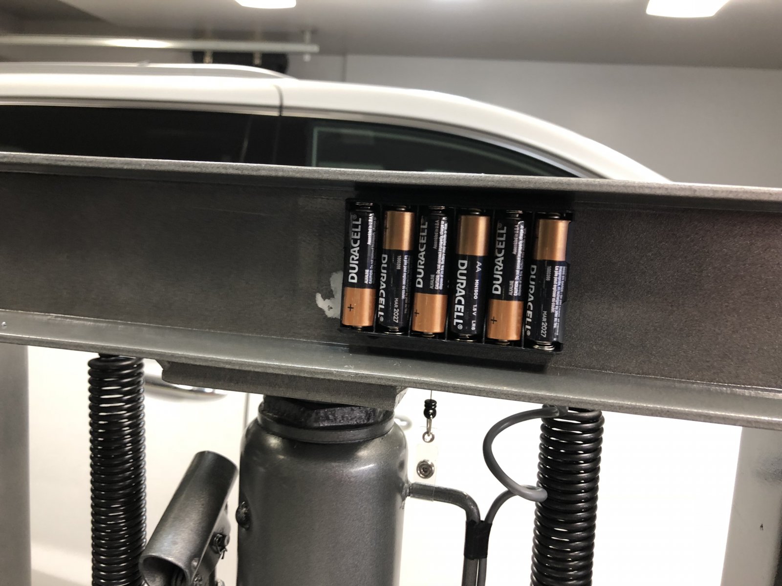

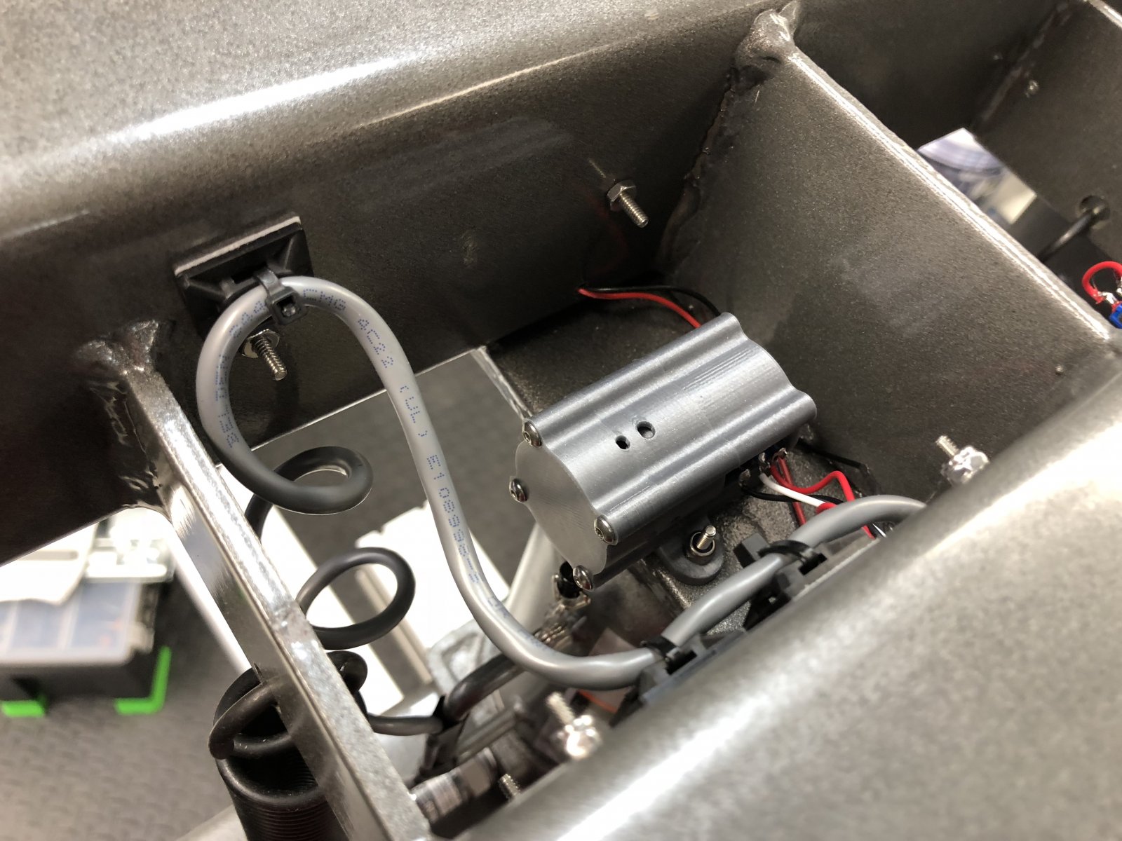

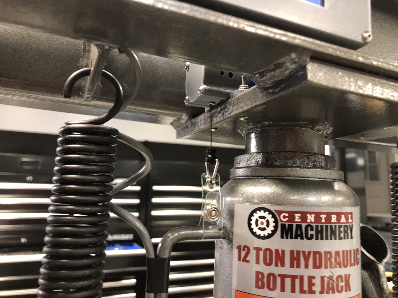

    I finished up the assembly and electronics.
    Battery pack mounted, I had to ditch the nice battery pack with a switch and cover because it was just a hair too large. luckily I had this one in my pile of stuff.
    Electronics and box are mounted to the front of the display with wires running in from the back. I also added a little toggle switch to turn whole system on.
    My custom designed string pot mounted and calibrated.
    So far everything works as expected.
    A couple of issues that I am working on are
    1. Running the arduino off battery gives me different ADC values than using USB power from the computer. I need to measure the 5v supply when using each source to see what the difference is and compensate for it.
    2. The return springs are counter-acting the jack so I need to add distance based compensation to overcome that.
    3. There are losses and creep within the bottle jack due to the pump valve and friction. I have a floor scale that reads up to 400lbs, so I am going to try to "calibrate" the system, but that is a relatively small portion of the scale.
    In hindsight as @RandomCoder pointed out a more common scale method may have been a better direction. I have been looking at that option a little bit more, but there are complications associated with that method also.

    So after a long hiatus I am finally getting back to this project. I ended up admitting defeat with the bottle jack and switched gears to good old load cells. I picked up a couple of 2,000KG load cells and some HX711 ACD converters. My plan is to build a stage that will sit in the jack frame, The touch screen interface will be the same just utilizing the load cells instead of the pressure sensor.
    I also picked up screw drive jack, my thinking is that the bottle jack will still exhibit the pulsing output where as the screw drive bottle jack should be a much more steady load.
