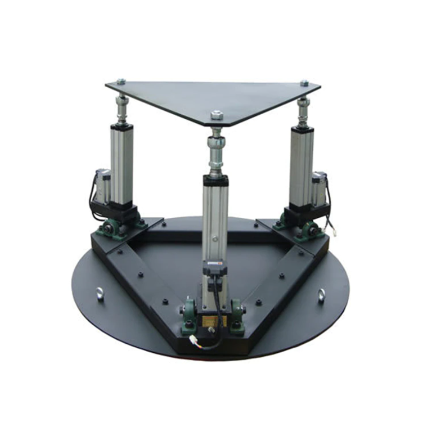

    Hello everyone,
    Years ago I got into simulator building with the help of this community.
    I have a 3DOF stewart platform system with linear actuators. I am using both actuators and motors imported from China. Right now I am having problems with the default platform height due to the linear motors being relatively too big. I would like a motion platform with considerably less default platform height.
    I would like to use a new type of actuator that I believe is called a "rotary actuator". However, I am very unknowledgable about these parts.
    I would kindly ask for some information, link dumps, videos, correct terminology to use about these actuators. Also if these actuators come as a set or I have to put the parts together?
    Also, are these systems cheaper than the usual linear systems?

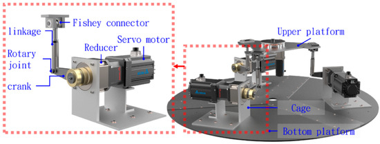

    A 'Rotary Actuator' is simply a controlled motor with a lever and rod attached, that produce movement that while not as linear or accurate as a linear actuator, is generally at a lower cost and quieter operation.

    A linear actuator is more precise than a wormdrive gearbox, which has a certain amount of play for lubrication purposes: https://www.xsimulator.net/community/faq/wormdrive-backlash.293/
    Cost is a bit of a difficult question, depending on DIY Vs commercial linear actuators, but in general a rotary approach simply relies on the bolt on gearbox, an attached lever and pot/hall sensor, with a rod with spherical ends connecting to the platform, so in may respects is simpler and much cheaper.

    Ok - I have done some preliminary research and I feel like I already have a better understanding of worm gearboxes. I can use the same motor that I have and use a coupler to attach it to a fitting worm gearbox.
    A lot of the worm gearboxes I saw online seemingly have 2 output shafts, and they connect a lever from both sides which merges into one fisheye joint? Or am I not seeing it clearly?
