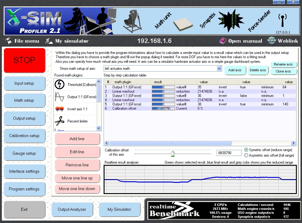

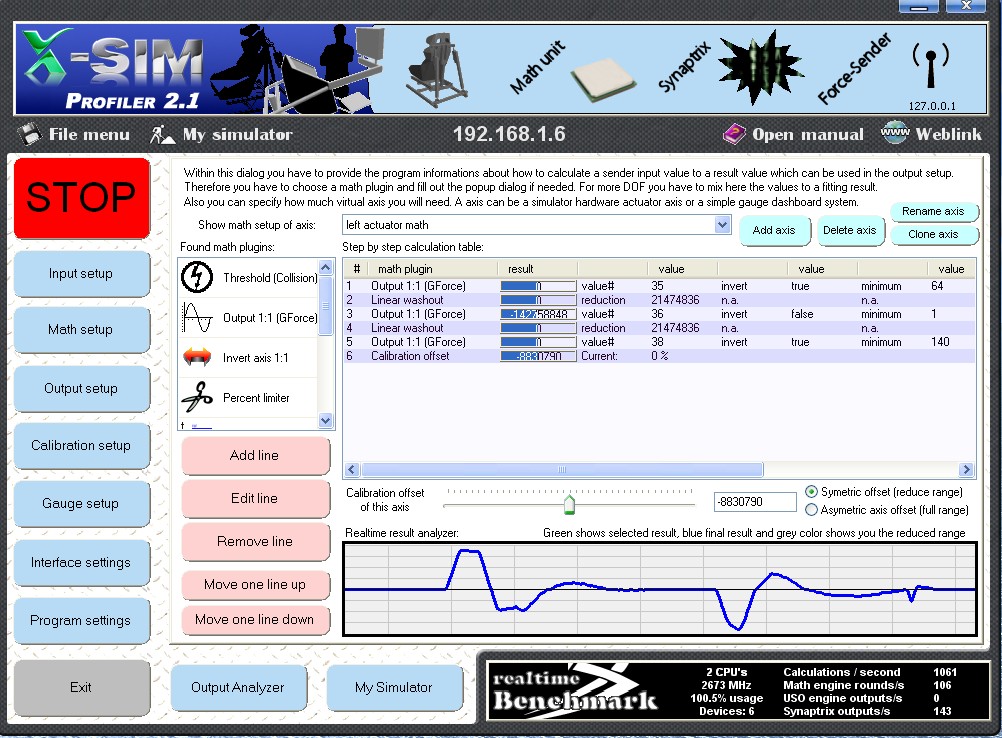

    I am at the moment endeavouring to tweak a profile for FSX Flightsim which Chris has very kindly put me on the right road to create for two SCN5 actuators.The platform is based on Bernards motion platform the info. for which he provided and for which I am also most grateful. To insure when I completed the platform that it was up and running perfectly I borrowed a Logitech G25 car racing gear, used one of Bernards car profiles and the performace was fantastic. Then I was ready to create a FSX profile but there was not one available in the Forums Profile section that I could load load up and tweak. This is where Chris’s help was invaluble. I have also received a lot of help from Bernard,Sirnoname,Egoexpress,Rene and a lot lot more, thanks a lot guys I am most grateful. I am now on the most important part of tweaking and that is to try and sync. the movements between seat and aircraft.
    Just to let you know how far I have progressed with it I have attached a copy of one of my profiles which has been updated no later than today and the relative analyzer info. of same . I have created several profiles for various planes which like the cars have got completely different characteristics and I have adjusted the combinations of values which suit each plane individually and the planes are all corrusponding very much the same. As far as I can follow in the tweaking of the profiles a lot depends on the cruising speed of the aircraft. I am at the moment getting approx 20 degree full forward and backward movements, I am also getting full 20 degree left and right banking movements, I am also getting where you have a combination of lets say a forward pitch and a left bank a movement which I would say could be better but this is due I feel to more improvment needed to the profile.
    Now you might say how can I be sure of all this, I will tell you, I take my B737 up to lets say 5000 ft. at a speed of 200 and use my AP to hold her at this, this leaves that the only manual control available is to bank her at whatever degree I want. Now I have my X-SIM ForceProfiler operating on my fourth monitor at the side wall of my cabin and it is on Math Input selection which enables me to watch the analyzer. This enables me as I fly to feel the movement and also to watch and check the actual movement on the monitor which is recording. I do exactly the same with appropriate settings to check all other movements e.g pitch etc.etc.
    One strange thing that happens and I can not understand it , I will try to outline it. If you imagine you are flying at a given fixed altitude in a straight line and you turn the Yoke to bank lets say 50 degrees to the left, the motion platform will lean to the left until it gets to approx 20 degrees fairly following the angle of the plane but when it gets to the end of its full span it does not hold in that position but then starts to return to its center position even though the plane may not have accomplished its full desired 50 degrees direction and is still on a bank. Why is the seat dictating the movement direction after it reaches its maximum reach and returning to center while the plane is still turning on its selected course and I have the yoke still held in the same position ? If I can describe a simular situaton with a car at very slow speed. You turn the steering wheel to turn a long slow bend ( remember it is a hearse you are driving , not an F1 car !! the speed and acceleration are down to 100 and 7 resp. ) half way round the bend the seat starts to return to center position while you still have a lock on the wheel to finish getting round the rest of the bend.
    Now I have found a way around this which may indicate something but it not the right way to correct the problem. If the initial speed that you allocate is in accordance with the amount of change of direction that you request the motion platform movement will syncronize perfectly with the planes movement, i.e. Initial Speed 100 : 25 Degree turn or Initial Speed 150 : 50 Degree turn, in other words the greater the turn the greater the initial speed required to keep the two in unison, the acceleration can remain the same. I realise that this is an impossable way to get proper sync..The profile has to be adjusted to syncronize properly but I am afraidI have not found the answer. I have attached the analyzer sheets which might indicate something.
    I would like to say that I am picking up bits and pieces around the various sections of the Forum from you guys for which again I am sincerely grateful and I can assure that without this I could not have progressed as far as I have.
    I am delighted with the performance of the platform so far and realise that any improvement lies in utilizing the software more than I am. Naturally at the moment to try and get a proper movement sync. between the plane and the seat is my No.1.
    If any of you can help me in this area my sincere thanks.
    Kind regards
    Toni

    I think your seat is returning to center due to a linear washout effect that is either improperly set, or should not be there at all. That's what a washout effect does, it gradually returns the seat to the center position so that some actuator stroke will be abvailable for other effects (maybe turbulence in your case). The trick is to set the washout so that it isn't noticable.

    As you may have seen I had two Linear washouts located in sequence immediatly behind the two GForce effects, the one to bank and the one to pitch and these were set at the lowest level of 1%.The settings for these washouts go from 1 to 40% and from trial and error I had found that it was best to set them at there lowest. From my reading I had found that they should be Used mainly in Flight Simulators to increase movement that was why I used them at all. Are there any other adjustments canbe made to these washouts ? Is there any alternative way that can hold the movement in its position until the turn is complete ?
    Now since I got your post I have tried again changing the percentage value of same to 20% and 40% and also tried removing them completely but I am afraid that I am still getting that return to center.
    Any chance you would elaborate on that Trick you mention in setting them so that they are not noticable or does the fact that I have tried removing them completely and still get the return to center remove the theory that they are causing the problem ?

    Math lines are cumulative. Therefore a washout effect will washoult ALL previous effects, not just the preceding math line. You may need to reconsider the order of your math lines and washouts.

    On reading your post I changed around my Math Lines in every possable order and also put in and removed the two washouts putting them in every sequence available. I then repeated all of this with the three different washouts ,Linear,Smooth and Sine with different values between 1 and 40% and again changinging the sequence without any luck. All of this I tried with just one effect which was the banking effect and with nothing only this effect in it returned to center as before.
    I then decided to start from scratch with a new profile with just one effect but this time I tried a different effect to try and produce the banking . I tried another FSUIPC effect No.29 which is called X Lateral Acceleration ( The one that I had been using was No.35 the standard X Acceleration effect ).
    Now with this Effect it actually holds in the max. left or right position for some time which the other one did not do at all. The only problem is that it returns too soon when it is on the right side and not soon enough from the left side but it does hold on both sides which is a big improvement.
    Now I have tried various combinations of Speed and Acceleration values and even though they make a difference in the speed etc. it still has the same lack of sync. as above.
    Nearly there Bernard !! any reason why this is happening ? To me I get the impression that something is out of alignment.

    I believe that you are using the wrong effect. I don't know what the number is, but it should be named Roll. Lateral G-Forces and lateral G acceleration by nature will taper off once you've reached a position that you are holding. Roll on the other hand should represent your position vs. the horizon. It sounds to me like that's what you're looking for.

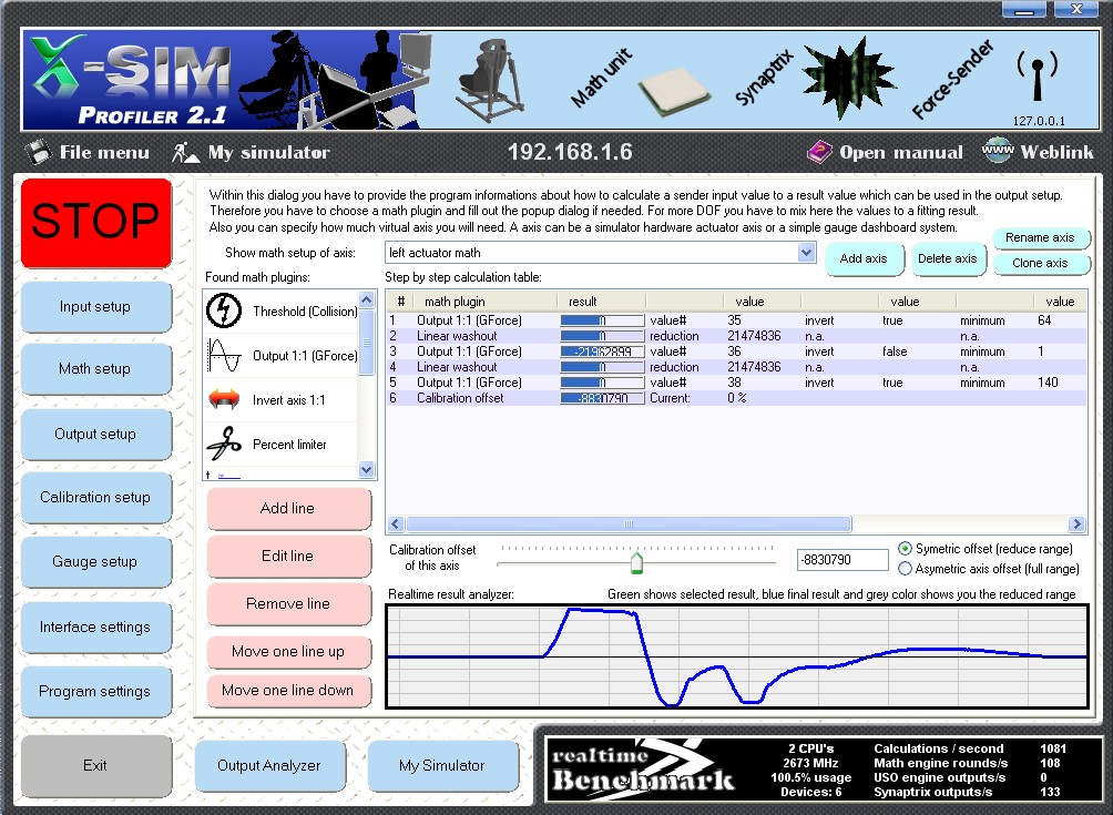

    I eventually located the effect which you referred to which is called “Roll Acceleration” and carried out the various tests to see if it would sort out the problem of Sync. ,however , no matter which way I tried it the results were not as we would have hoped. Initally I could not get any sort of acceptable motion from it and eventually found that this efect as far as I can make out is meant to be used for literally “roll” as it says, the action seems to be braught about by the movement of the Yoke in small dozes. I will explain, If you are travelling in a straight course and waggle your yoke left,right,left,right,etc.etc., ( same as the racing drivers do before a race ) you will get a regular motion movement to corruspond but if you leave your Yoke locked to go left or right the motion stops completely. I have illustrated this below from the analyzer.
    So far I can only find three possible effects in FSUIPC that will provide banking and they are as follows;
    EFFECT No. CODE No. DESCRIPTION GIVEN IN FSUIPC
    37 3080 Roll Acceleration - Rel to body axes in rads / sec / sec
    35 3060 X Lateral Acceleration - Right / Left Rel to body axes in ft / sec / sec
    29 31C0 X Lateral Acceleration - Right / Left Rel to world axes in ft / sec / sec
    NOTE No. 29 [ BERNARD THIS STATES WORLD AXES WHICH I TAKE IT CAN BE TAKEN AS HORIZON]

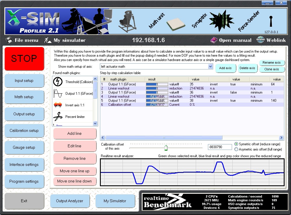

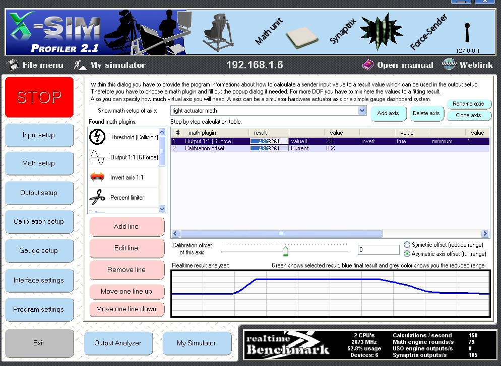

    I have found that No.29 is the one that seems to be the best of them ,the problem with it is, as explained in previous post, the sync. is out but the movements are perfect. Find below the analyzer
    diagrams of the three effects.
    One last thing which may be of no significance, when I am switching on or off the Force Profiler, that is the “START” “STOP” button in the top left hand corner , I get a very quick “CENTER 1s” message on the same button, does this mean anything ?
    Kind regards
    Toni
    Diagram 1. This is the Roll Acceleration Effect (No.37)which is the last one tried that seems to be more to illustrate fast left / right movements.
    Diagram 2. This is the first of the X Lateral Acceleration effects ( NO.35) which returns immediately before the turn is completed.
    Diagram 3. This is the second of the X Lateral Acceleration effects ( NO.29 ) which as pointed out above, and in previous post, even though it does not stay in Sync. does carry out the movements better than the other two.
