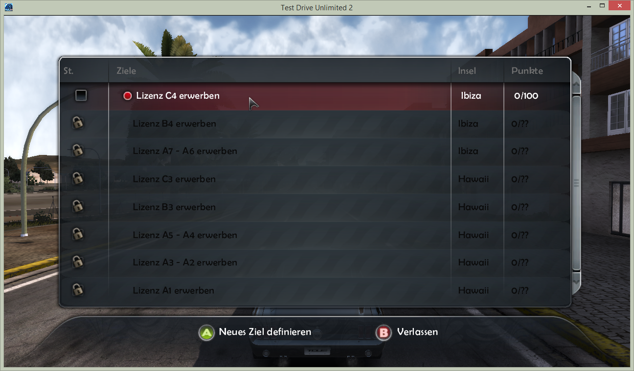

    @value1 My happyness was only short.....its not working on my simulator, is that because I have the normal cd version of this game and not the steam one ?

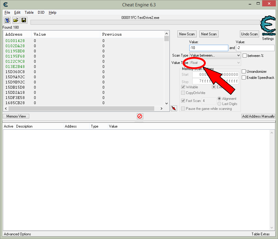

    @Al.Bundy

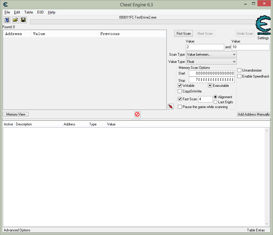

    Make sure you run GameManager in Admin mode! If this doesn't help try this:
    Download and install CheatEngine. During the installation do not accept the installation of additional crapware ;-)
    Connect CheatEngine to TDU2.

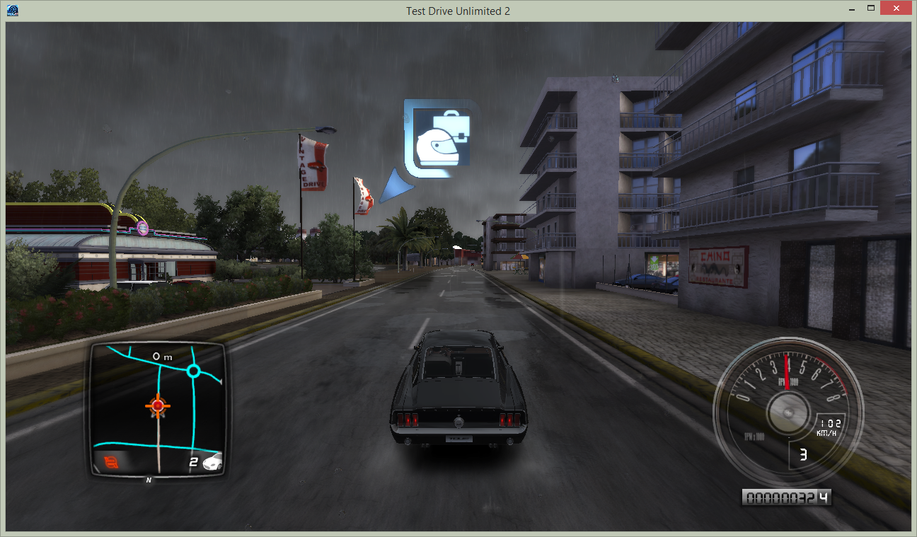

    In TDU2 enter the drive academy into the GPS
    Drive to the academy
    Enter 2 and 10 into CheatEngine:
    Drive along this road at a speed between 10 and 35 km/h direction south and press First Scan.

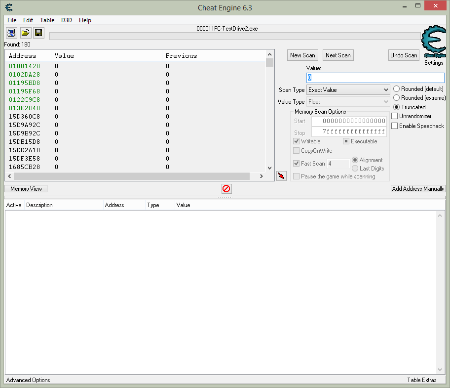

    Turn your car and drive backwards at a speed between 10 and 35 km/h in direction south. Press Next Scan.
    Stop the car and enter ExactValue 0 in CheatEngine. Press Next Scan

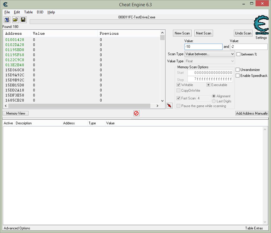

    Enter -10 and -2 into CheatEngine:
    Drive foreward at a speed between 10 and 35 km/h in direction north. Press Next Scan.
    There will be a few green addresses.
    Send me these or better a printscreen.

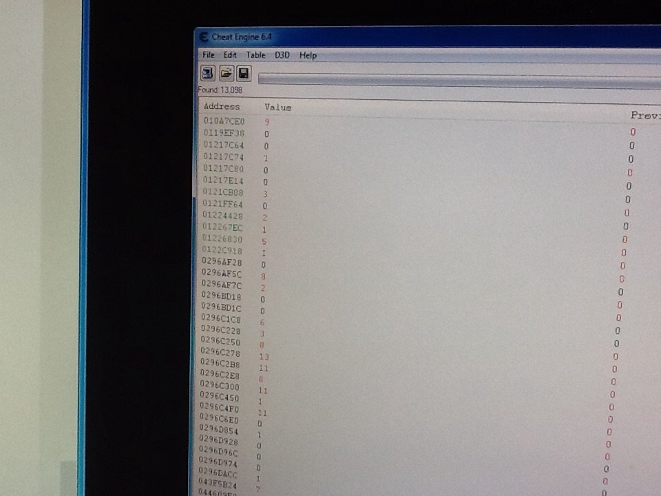

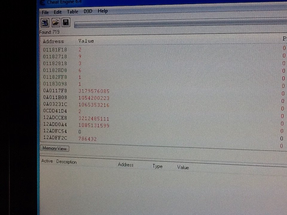

    @value1 , let me start with thanking you for trying to help !
    The last 3 hours I have been busy to follow your guide....the real problem is that my mouse will not work when the game is playing in a window so that makes it extra hard to do, also after pushing first scan in cheat engine and then two times next scan there is no more working button to push the last time next scan...if you know what I mean ???
    Anyway I managed to get these two screens after doing my best....i really hope this is something you can work with.
    If not I can always send the CD to you ;)

    Hi @Al.Bundy
    You can switch out of the game window with <alt><tab> and then use the mouse as normal.
    When you run the car up to 50 km/h you can switch out and press the button, when the speed is between 10 and 30 km/h.
    The few green addresses should all show the same value.
    It appears to me that you have been looking for "4 Bytes" values instead of floats.

    @value1 I tried again on float, but i just do not seem to get that last step.....then I saw that you use the cheatengine 6.3, while I am using the newer 6.4, so I downloaded 6.3 and tried again and again with no succes, it seems like the last step does not give me those green numbers you are looking for :( I guess I do not have the skills for programming ?
