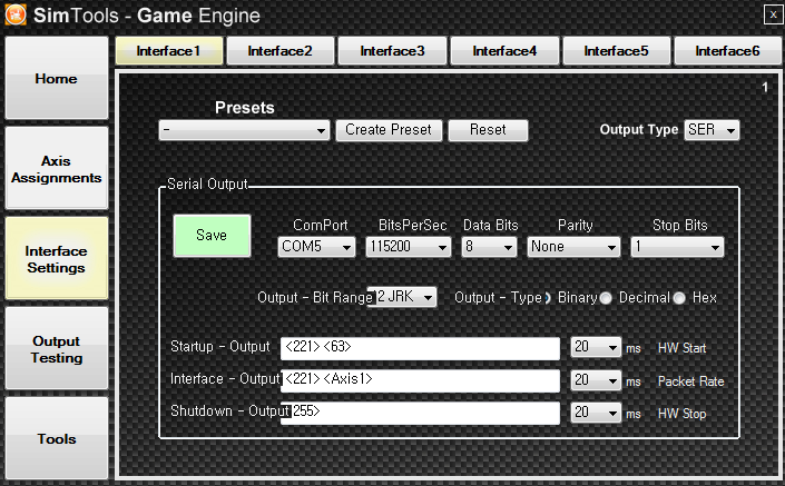

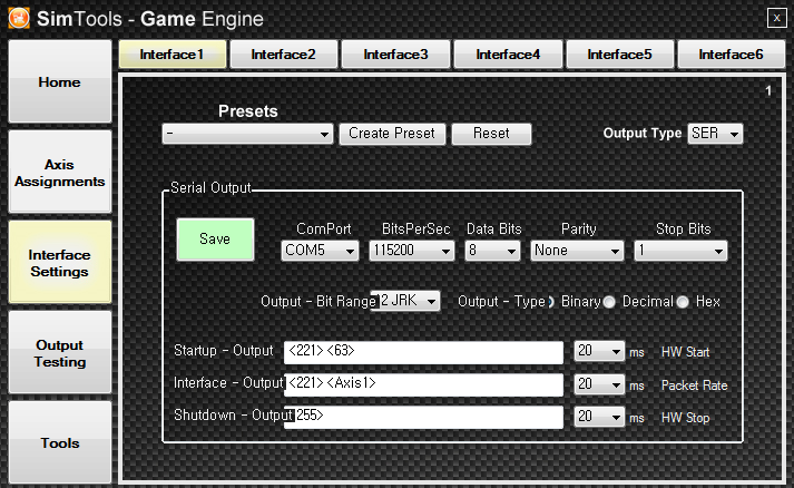

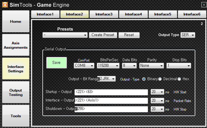

    Hello All. :)
    I just started testing with Simtool.
    It is still not moved... I just adjust and test then again and test.
    When I take by in the Jrk Configuration Utility, It is moved. anyway...
    first, there is texts some had problems. :(
    second, I use to Pololu JRK 12V12, so there is being to Command Port(COMx) and TTL Port(COMx).
    but I don't work any ports for output testing section. It is normal?
    P.S : I added for my SimTools Game Engine Settings.
    Simtool_text_1.png Simtool_text_2.png Simtool_text_3.png Simtools_setting_1.png Simtools_setting_2.png Simtools_setting_3.png Simtools_setting_4.png

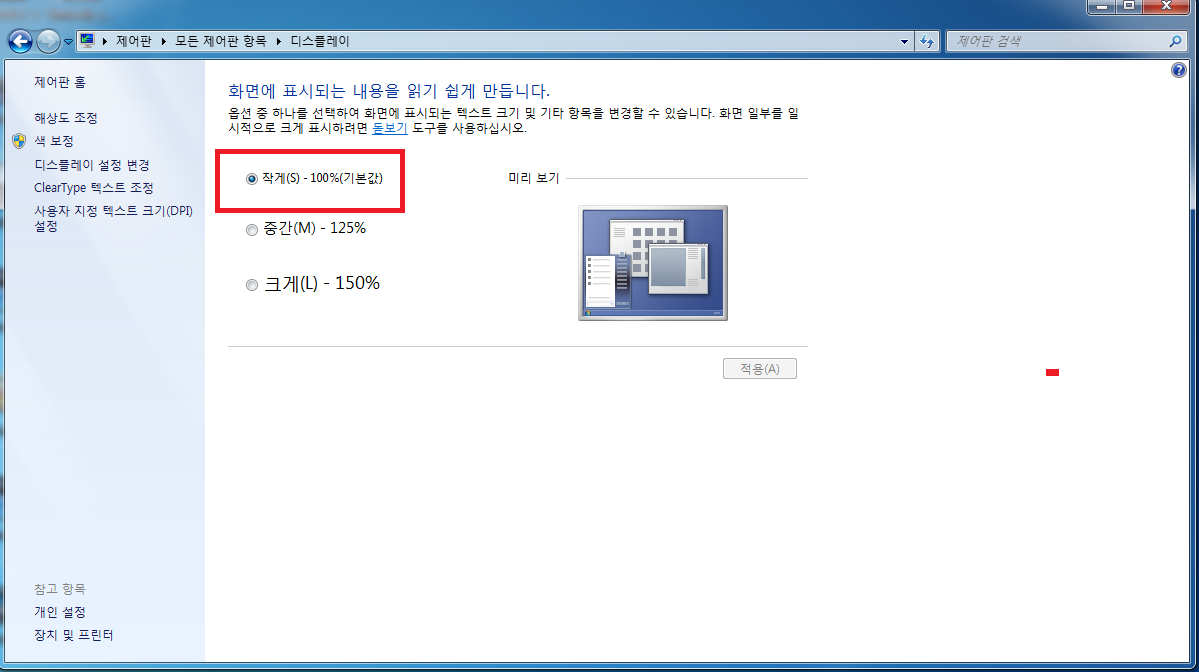

    Hello, @noorbeast :)
    Thanks your answer.
    but I already checked it display options for 100% text size and not working. I use to Windows 7 Home Premium K 64bit.
    ah My Game Engine Interface output is not all the Axis1.(Interface 1 : <221><Axis1>, 2 : <221><Axis2>, 3 : <221><Axis3>) so Please disregard this in the setting pictures. :oops:
    and What I mean, Port is the in the device manager and there is some difference of the named. ex) Command Port and TTL Port, so I will setup to the only Command port in the SimTools Game Engine Interface settings?
    yes, I downloaded it by bsft's Jrk Guide
    21,030
    147,878Coins
    +10,879 / 54 / -2
    Try setting English as the default language, SimTools does not do so well with other language settings.
    Yes command port.

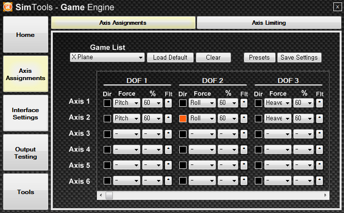

  13. eaorobbie
    20,431Coins
    +1,684 / 23 / -2
    OK with the testing issue , have you set the default axis setting as I could not see a picture for this.
    The Output tests section only works with the default axis assignment and not a game assignment.
    When setting SimTools up for the first time this is clearly stated in the main docs, but I don't have a step to step method as its designed for diy simulator builders not newbies. Sorry a better manual is on the horizon and Im open to adding more to it if needed.

  15. yobuddy
    5,282
    49,198Coins
    +5,093 / 18 / -0
    @hunijjang
    It looks like you have spaces in your interface settings...
    Try this "<221><63>" and not this "<221> <63>" - remove the spaces.
    let me know how it goes...
  16. hunijjang
    hunijjang She is my wife :) Gold Contributor
    Jan 30, 2015
    90
    Operator
    Seoul, Korea
    1,164Coins
    +17 / 0 / -0
    Hello @yobuddy :)
    but It is not added spaces. :rolleyes:
    by the way, that is working well and sorry for be tardy a answering a reply to you.

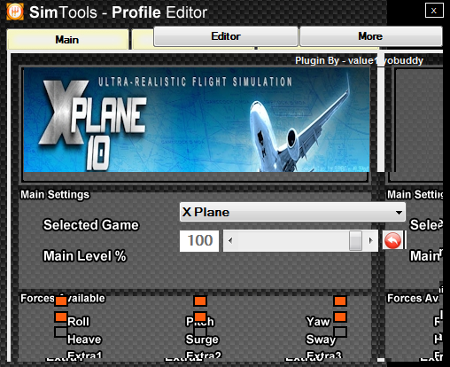

  19. noorbeast
    21,030
    147,878Coins
    +10,879 / 54 / -2
    The plugin for Prepar3D had the additional functionality added which allows for settings as per that guide, X-Plane has not.
  20. hunijjang
    Jan 30, 2015
    90
    Operator
    Seoul, Korea
    1,164Coins
    +17 / 0 / -0
    Hello @noorbeast
    I tested for 1~3 axis and includes roll, pitch, heave, sway, surge with X-Plane.
    I did use to Tuning Center and roll and pitch axis max values is looks well but heave, sway, surge values very low. e.x) heave is below about 5% and sway, surge is about 1-2% for max values.
    I think that of values something wrong maybe...
    @value1 It is normal? :(
