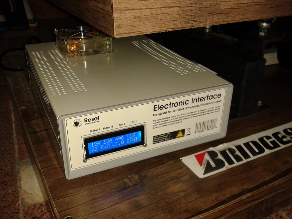

    i am using Thanos AMC 1.5 along with pololu VNH2SP30 and 2 wiper motors
    in my project.i have problem of my pololu turning off(just motor 1)and getting
    stop sometimes during operation while the second one work smoothly nonstop,
    when i just plug off the whole system and turning on after a couple of seconds
    it just works well again. i just mixed up what and where is the problem :?
    thank you for any help or guide...
    regards
    Hooshang

    Is the tronic card working properly?
    Did you email pololu service?

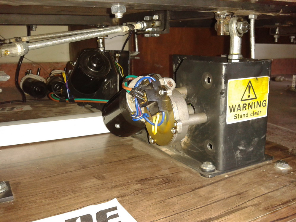

    hello freinds and thank you for quick reply
    i have heatsink and there is no overheating
    motors installed on the wood...
    ?... :? think so

    Hello Hoosang, firstly with your motors. Even though they are on wood, the metal case is still connected to the rod end and unless you have isolated the earth off the motor, there is a good chance you are running 12 volts through the sim chassis. It may not sound like a problem, but you may be feeding back 12 volts through the power wires to the boards and upsetting them.
    Secondly, I think I can see a potentiometer bolted to the metal bracket that the motor is on. This also could be feeding a 12 volt signal back to the control boards if yo have not isolated the earth off the motors.
    Suggestion is, isolate the earth of the motors so you cannot use the motor housing as an earth, unless you have already done so. Check this first before telling pololu the problem.
    Also email pololu service with your issue, and they maybe able to help.
    Go with that. However, feel free to try another board if you have it.
    Cheers, David.
