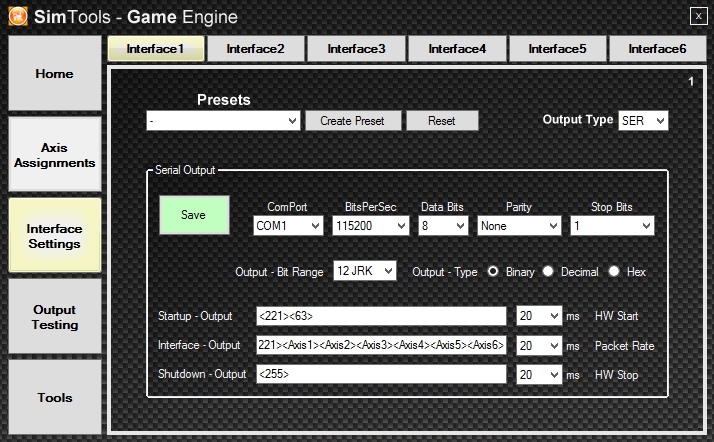

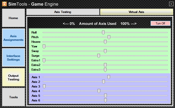

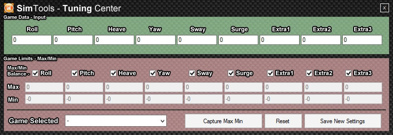

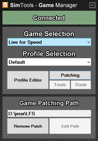

    I have carefully followed the steps above in different threads, but I still can not get anything happening in simtools
    The tuning center returns desperately to 0
    I run the two modules of simtools in administrator mode, I patched the LFS game twice, the corresponding Cfg file contains the path of the game.
    Can you help me, because I would like to wait until the end of manufacture simulator to run simtools correctly
    Not to waste time once everything is in place
    21,030
    147,878Coins
    +10,880 / 54 / -2
    LFS needs to have been run at least once before patching.
    If it had not been run then unpatch LFS, start LFS, drive some laps, close LFS and re-patch.

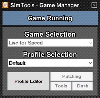

    When you start LFS Game Manager should turn blue at the top and say Game Running. Does it do that?

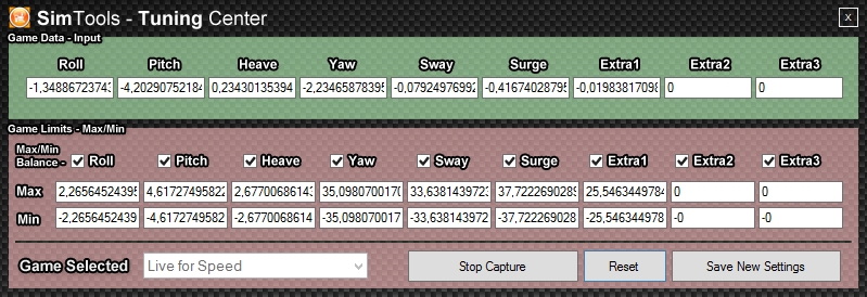

    You're really too strong !!
    I had not thought of launching LFS and patching it only after the first races
    Now i have simtools that works and i would not waste time stupidly !! game engine3.jpg game manager 2.jpg tuning center 2.jpg
