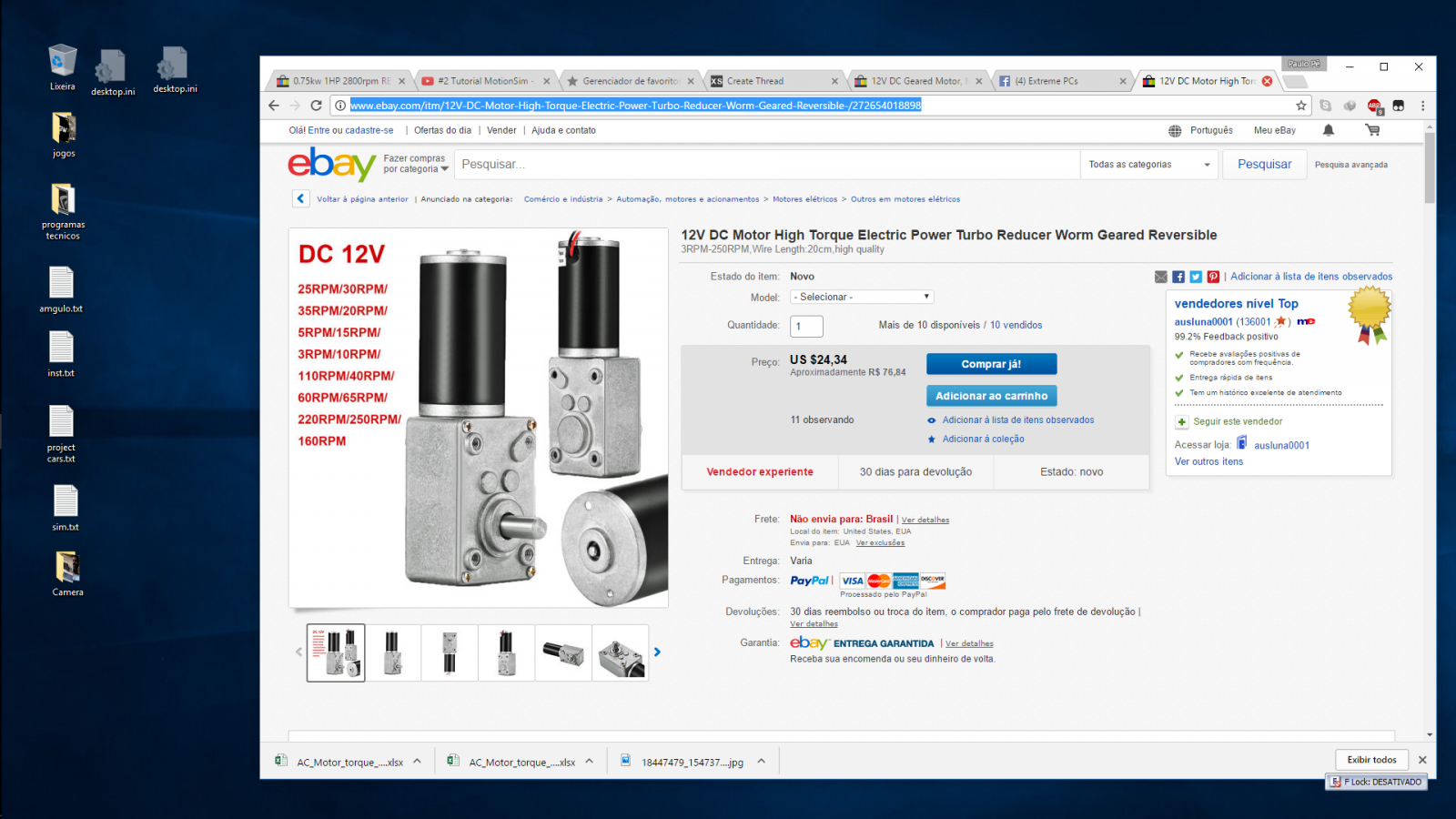

    high rpm but dont show NM !!
    21,176
    148,736Coins
    +10,915 / 54 / -2
    Those are miniature DC motors and are only suitable for a model sim, not the real thing.
  3. paulopsx2
    paulopsx2 Active Member
    Apr 2, 2016
    615
    brasil
    635Coins
    +163 / 2 / -0
    hummmm i see.. thanks.
    What is the best and strongest possible for a 2 DOF? Example 80 rpm, 50 NM ... 12 or 24v?

    no its the gearbox ratio, you can also get 25:1 which has less torque
  7. paulopsx2
    Apr 2, 2016
    615
    brasil
    635Coins
    +163 / 2 / -0
    right.. 50:1 sounds me better for 150kg.
  8. SilentChill
    2,643
    20,562Coins
    +3,489 / 34 / -0
    LOAD BETWEEN 50-60 N.M

    well... i dont know.. maybe an sabertooth or pololu?
  12. SilentChill
    2,643
    20,562Coins
    +3,489 / 34 / -0
    Me personally would go with a Sabertooth 2x32 they are well worth the money and if you wanna go overkill get a 2x60 :)

    Well, continuing my saga, I discovered that these 12v or 24v engines do not last very long and can not push a lot of weight ... talking to a friend, told me that stepper is much stronger, working on 220v. is a good idea? Even if they are more expensive? And this can be used with arduino and sabertooth as well or from what I understand, sabertooth control only DC motors?
    ( my intention is 200kg + platform )
    And I am seriously thinking of going from 2 to 3 dof, the difference is great, and with the central spring, it seems to force less the engines besides giving me better result in height
  15. noorbeast
    21,176
    148,736Coins
    +10,915 / 54 / -2
  16. SilentChill
    2,643
    20,562Coins
    +3,489 / 34 / -0
    I've been using 12v motors for 2 years on my 6DOF and they have lasted fine. If you want to go AC you can but you will probably need a thanos board or something like that sabertooth and arduinos are a no go. Plenty of people here using 12v/24v for 6DOF

    well.. 2 months after some searchs and a lot money rs.. my 2 dof are done. use 2 250watts, 50nm 80 rp
    m motors !! tks
