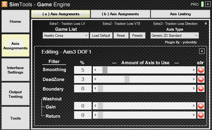

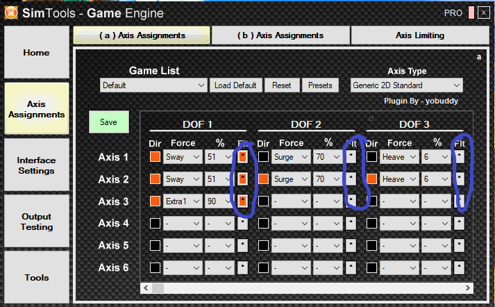

    I'm finally implementing my "nose down" breaking mod to simulate negative g-force and so far I really enjoy the outcome.
    But since I'm not yet familiar with all the simtools tuning windows and possibilities:
    Where can I raise the threshold for surge (or any other dof for that matter)?
    Just smoothing doesn't accomplish it.
    Very grateful for your help

    Take a peek at Game Engine's tuning center buddy.

    Where can I access this (image below)? In the tuning center the is only the min/max values from what the DOF preset or capture enters...
    I want to filter the signals. There is constant tiny ozscillation

    2DOF, 6DOF

    Okay, from a different post I understood that you need the Generic 2D STANDARD not the BASIC setting...
