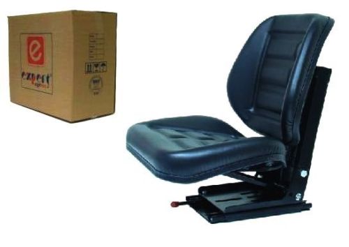

    I've been toying with the thought of using the suspension seats they use on Tractors and Farm vehicles for Heave. They are spring loaded for a fair bit of movement up and down.
    Anyone ever tried one of these for a Motion Sim?
    (Of course, seat would be removed for a proper race seat.)

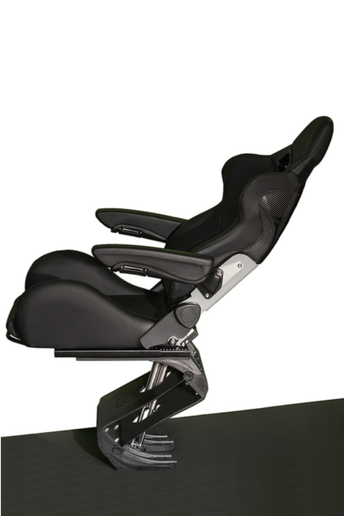

  7. bsft
    Why not use some dayton pucks or some bass shaker? Saves a lot of hassle and you get shaken up.
    moving the seat up and down moves weight balance and for correct setup, springs can soften motion .

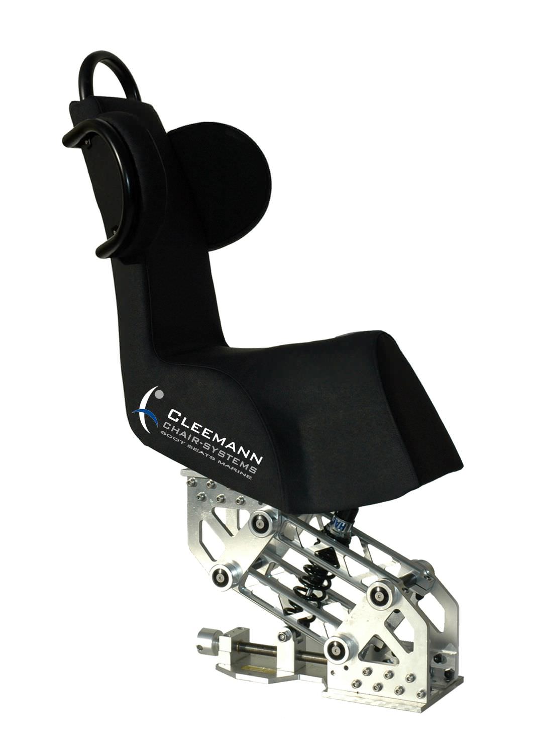

    Do you mean the photos @RacingMat added...they are designed for a different purpose so if using something like that then you would not necessarily plan to use the full axis movement.
    My comments related to my heave setup and what I have experienced regarding COG changes and motor stress.

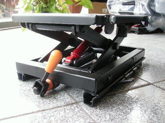

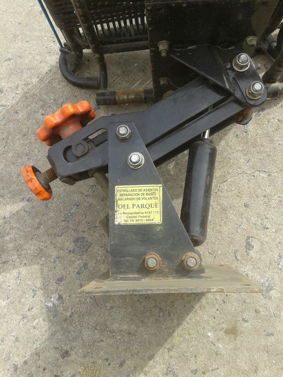

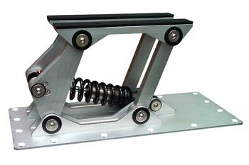

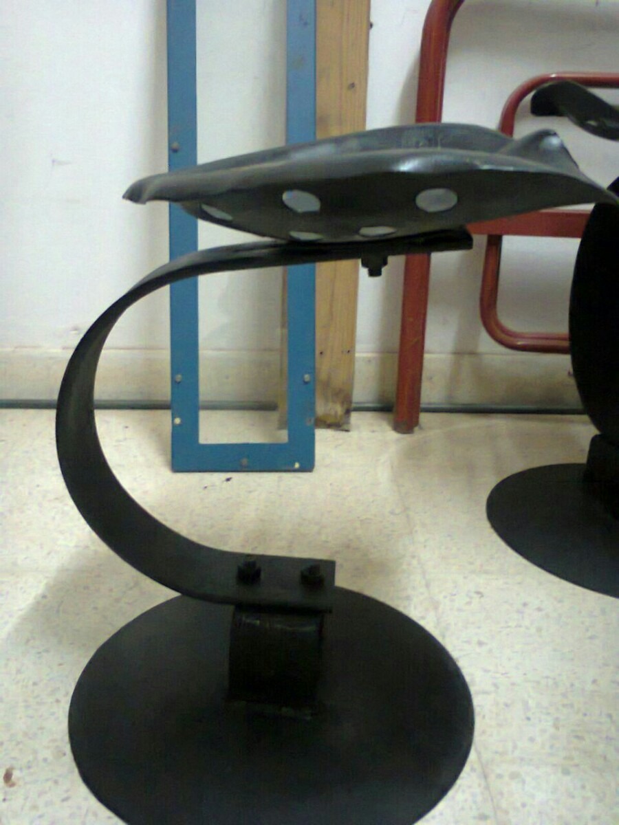

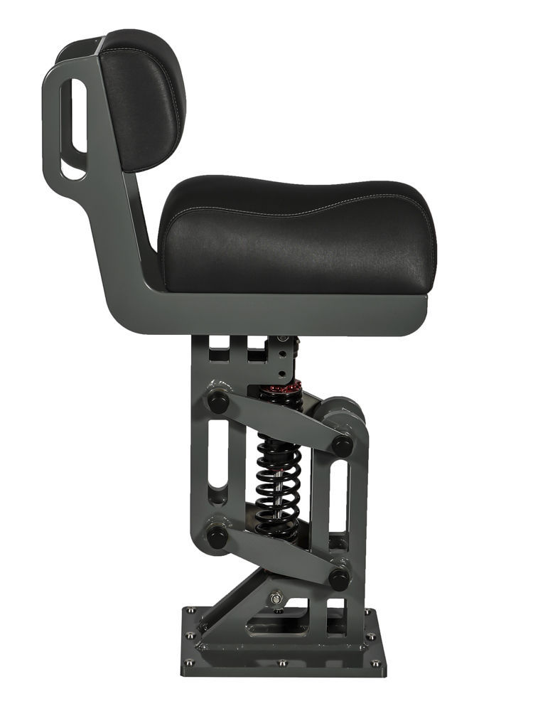

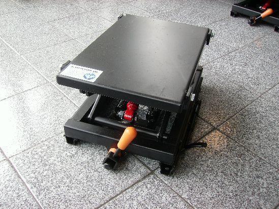

    I did some research...
    You can get this kind of hydraulic or pneumatic bases for seats alone, I will call next wednesday to get a quote (no labor days monday and tuesday here)

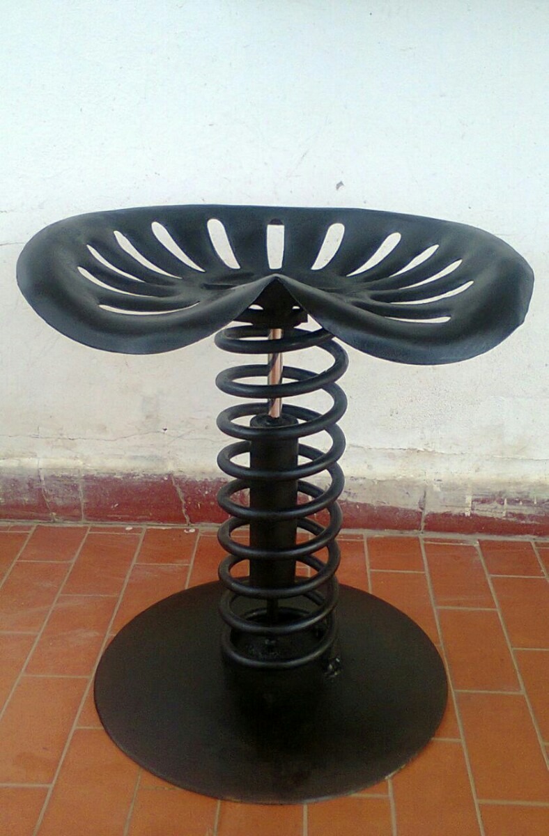

    Also, and on the cheap and maybe funny side (I think) you can get other kind of bases ready for heave:
    suspension asiento1.jpg suspension asiento2.jpg :p

    I'm happy to report that these seats will indeed work well for Heave. I took the plunge and bought one from Ebay. Thankfully, it actually arrives with the seat in pieces so it's easy to see the mechanism and how it works.
    The only drawback is the weight of the base is very heavy. It's plate steel. I may need to look at a making a different enclosure. I guess the upside is that it will cope with the forces of the sim in a lateral sense.
    When sat on the seat it actually needs very little pressure to make the seat "pop up". I can sit my 100kg self on it and push up with my fingers from the ground. The Motor will easily cope with that.
    The question now is, do I set the heave for the midpoint of the seats neutral movement, so I can have + and - heave sensation, or just set to the lowest, so it's always an upward movement?
