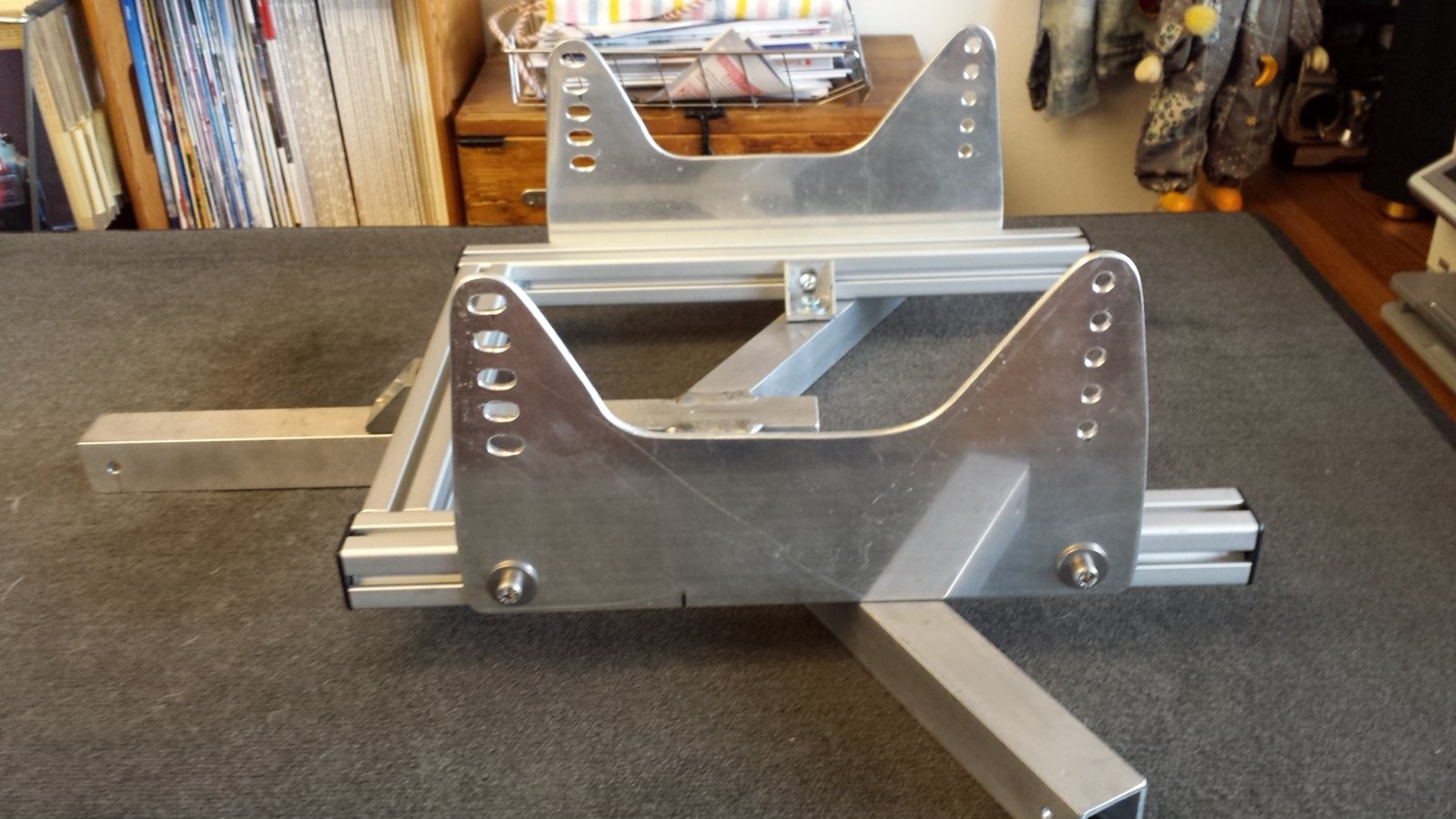

    In December 2016, I built a Tri-Motion with Hyperaxis as DIY.

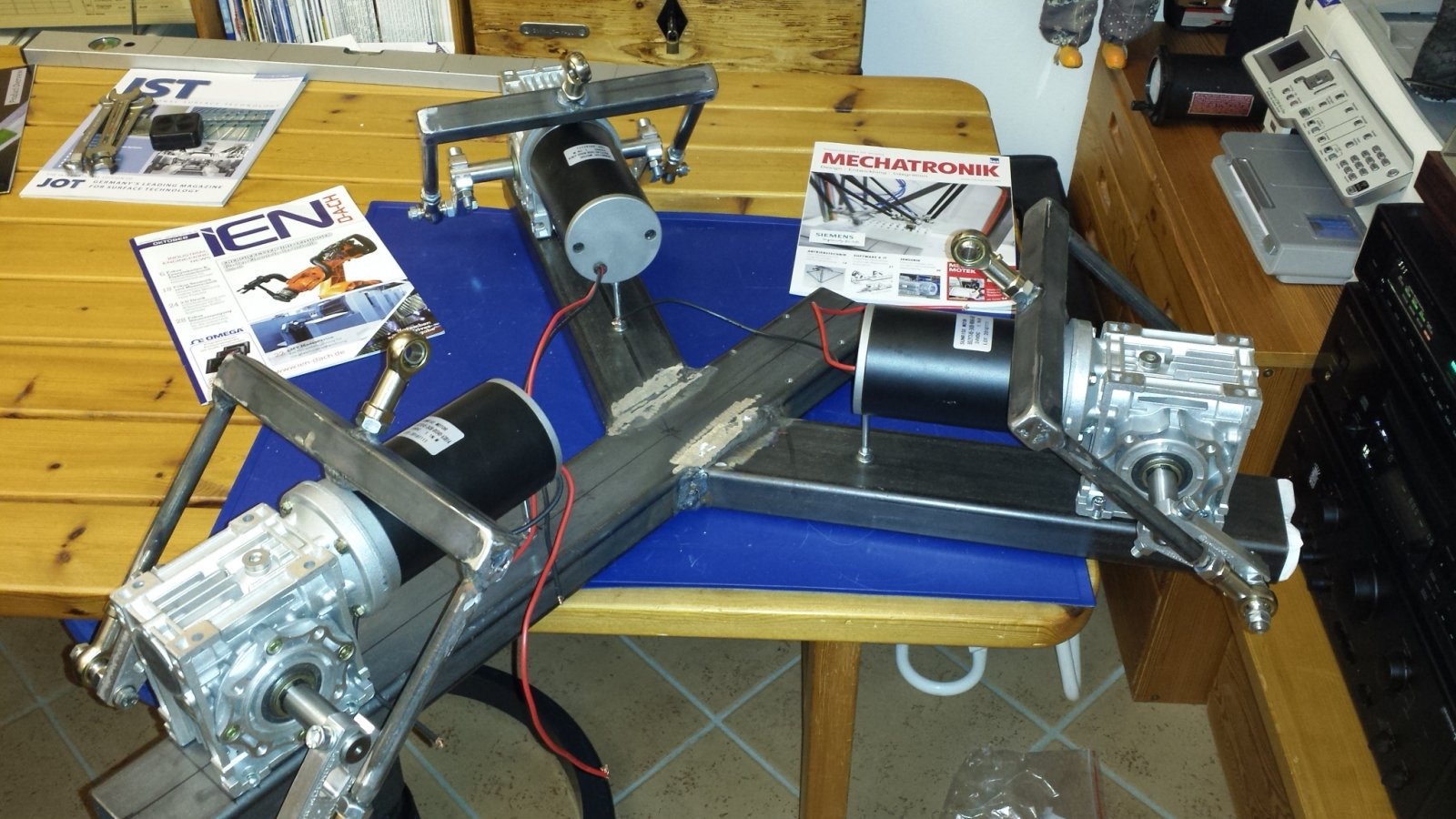

    I am currently building a tri-motion system with three wiper motors 350 watts from SimuKit
    After completion, I would like to compare both systems side by side and report my driving and / or simulation impressions here.

    Motors are sold by https://simukit.com/
    The motors are tailo made to build motion rig but we are currently out of stock. We have an order that should be available in early March.

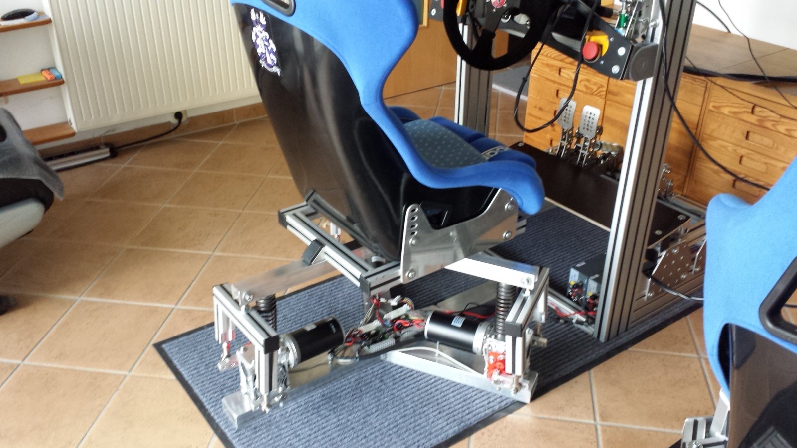

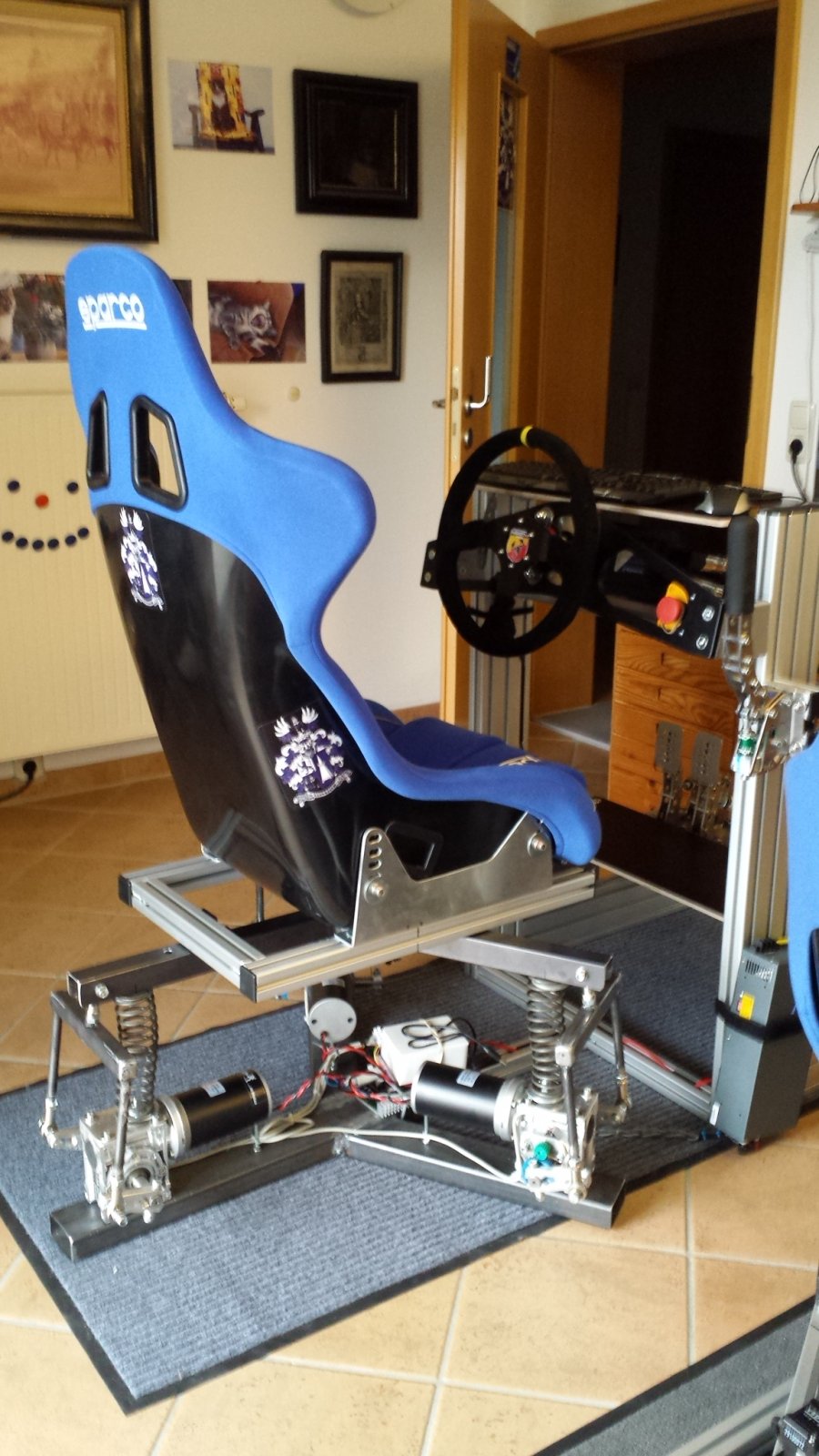

    20170206_133018.jpg vsp Tri-Motion
    with Gear-Engine 350 watt plus Springs from SimuKit
    With too long and too strong springs
    With these springs the motion has felt like a catapult

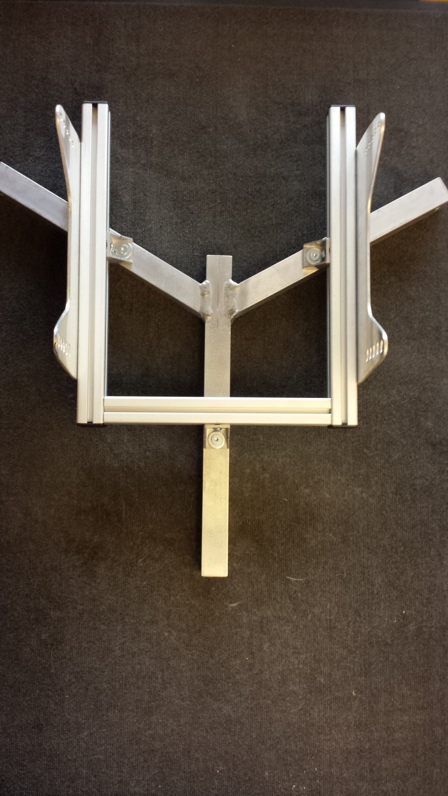

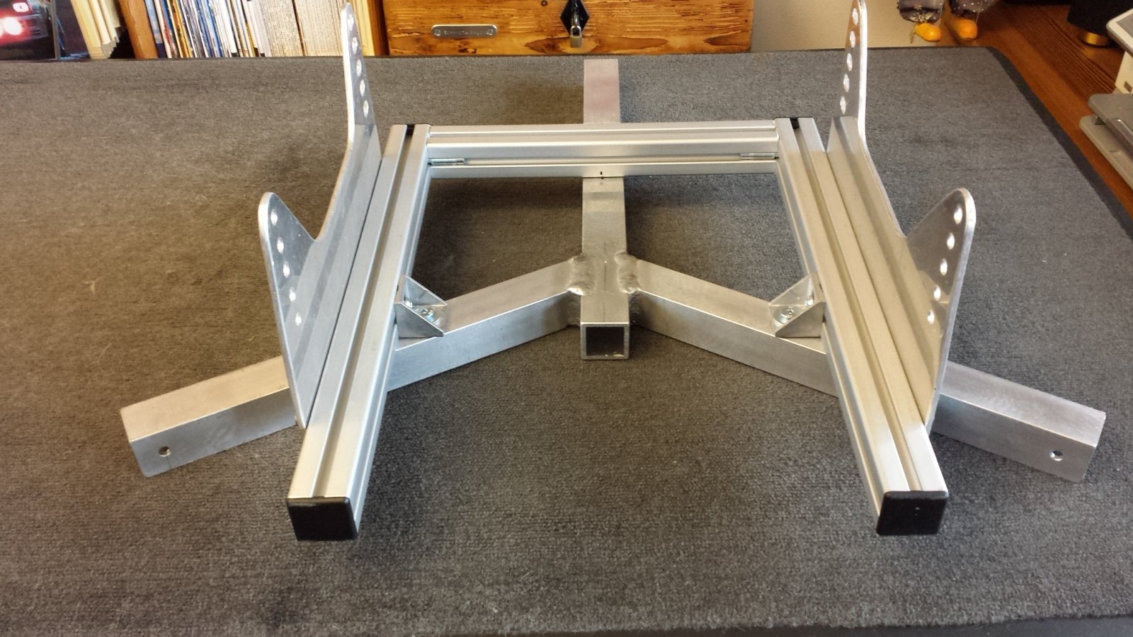

    the new Tri-Motion Alu Rig with 350 Watt Gear Engine and low Springs
    I created this Tri-Motion myself in aluminum
    The engines are from SimuKit
    The necessary power can only be achieved with springs
    The springs are adjusted to my design and weight
    and the Motion-Profile is optimized with PID settings

    Side by side comparison
    with my two tri-motion systems I designed
    vsp Tri-Motion with 350 watt geared motors
    versus
    vsp Tri-Motion with HyperAxis Linear Drive
  12. vsp19
    vsp19 keep Sim-Racing Gold Contributor
    Nov 17, 2016
    46
    170Coins
    +27 / 0 / -0
    2DOF, 3DOF, SCN6
    Conclusion
    side by side test
    and building experience
    The Tri-Motion with the geared motors from SimuKit
    is a cost-effective motion solution with a material insert of approx. 2.000, - € and my DIY construction time of approx. 20 hours.
    But I prefer my Tri-Motion system with the HyperAxis linear motors from Frex. This motion system has significantly more power and is significantly more sensitive.
    However, you have to reckon with a material insert of 4,000, - €.
    The DIY construction time is however significantly shorter with approx. 5 hours
