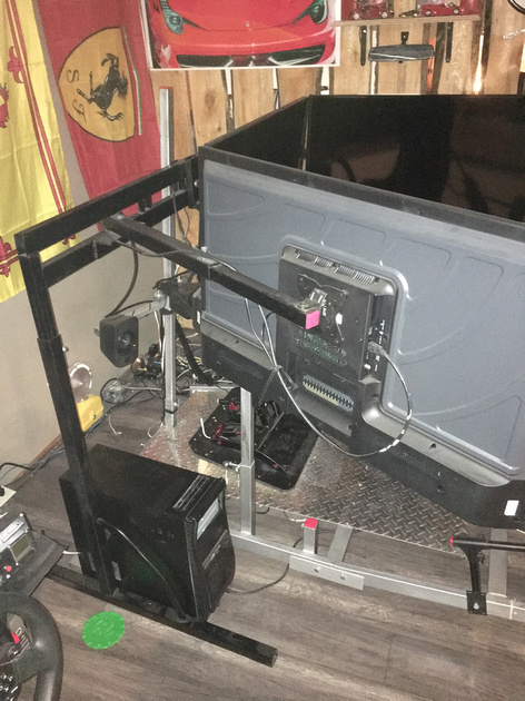

    Looking for ideas how to make triple 50" TV stand so it is solid AND adjustable as much as possible.
    Will make it from STEEL only.
    Ideas, please?
    Thanks:)

    Here is mine. Made mostly from 1.5" and 1.25" square tubing. A 3/8" nut welded onto the 1.5" sections with a tightened bolt gives lots of holding power[​IMG]
