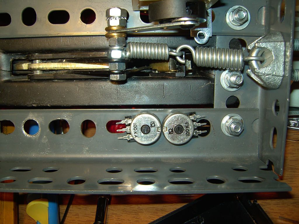

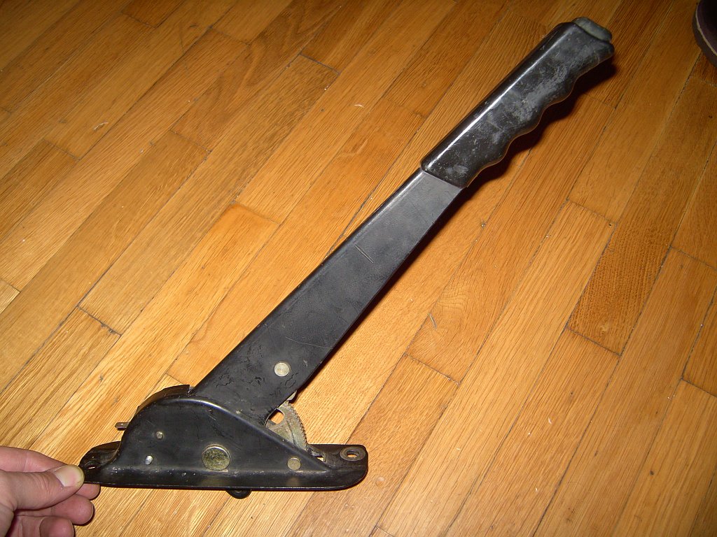

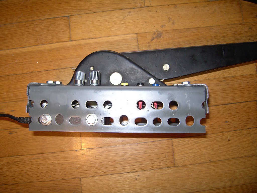

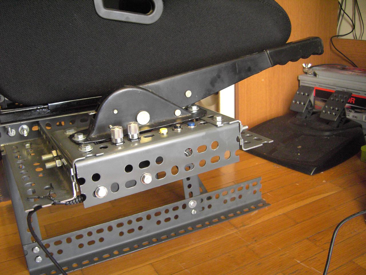

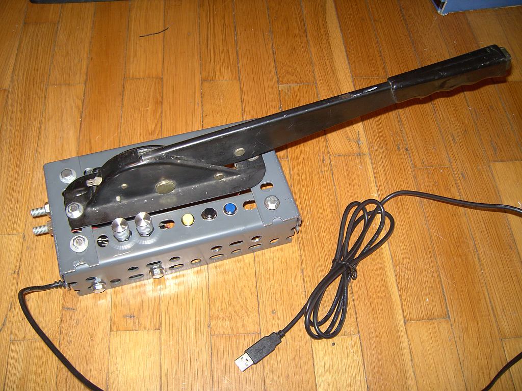

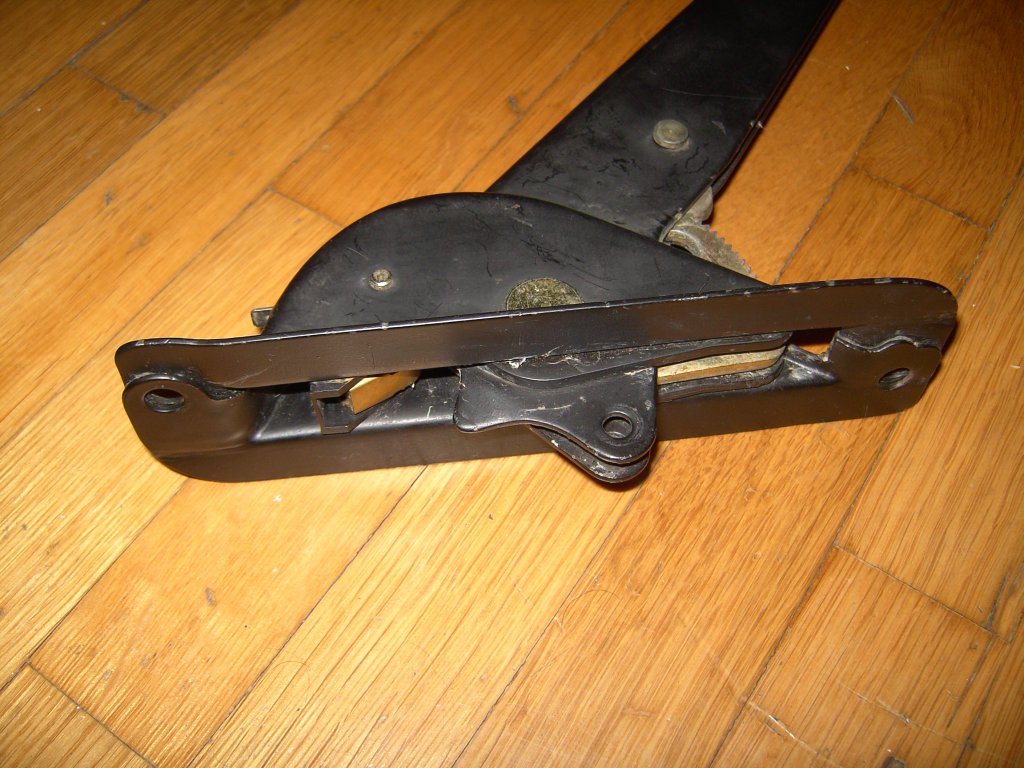

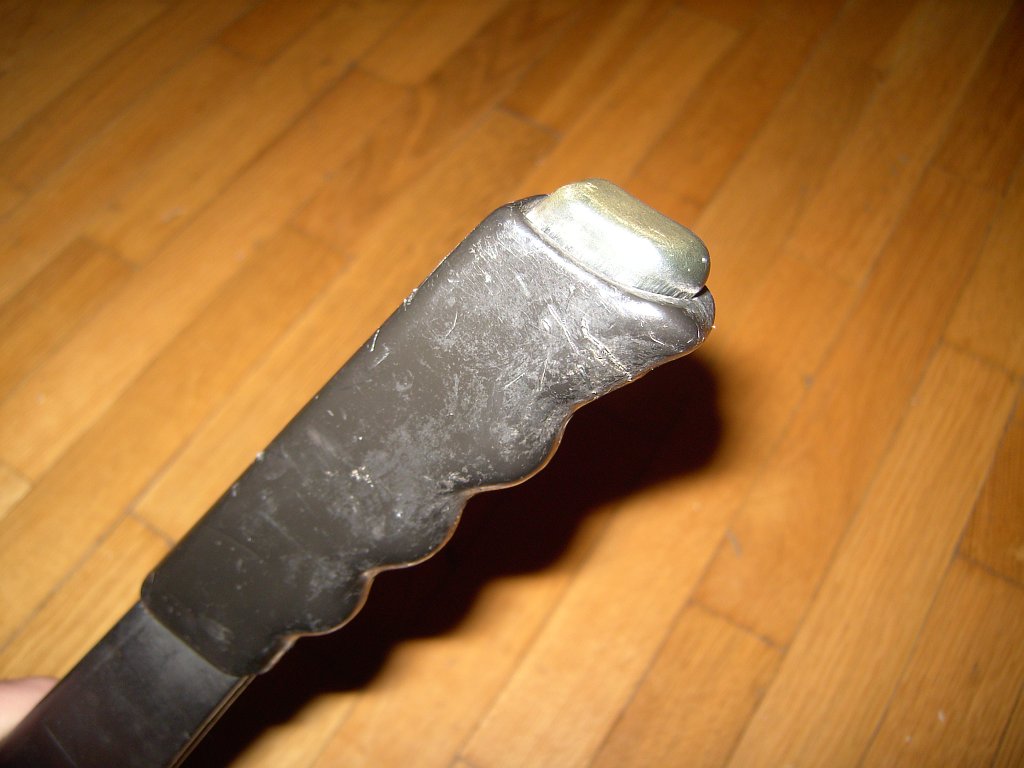

    Instead of using a piece of plastic stick or wood for the handle I decided to use the real thing. A real handbrake handle and its mechanism from an old Renault Clio.

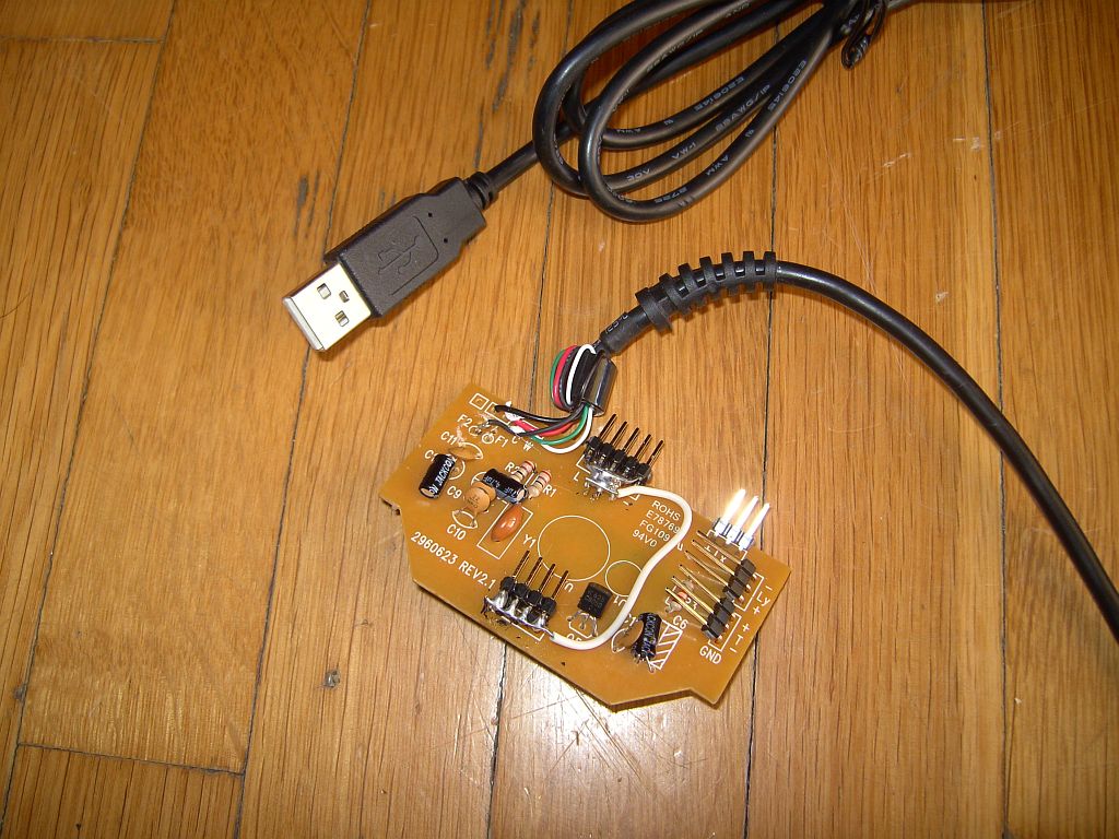

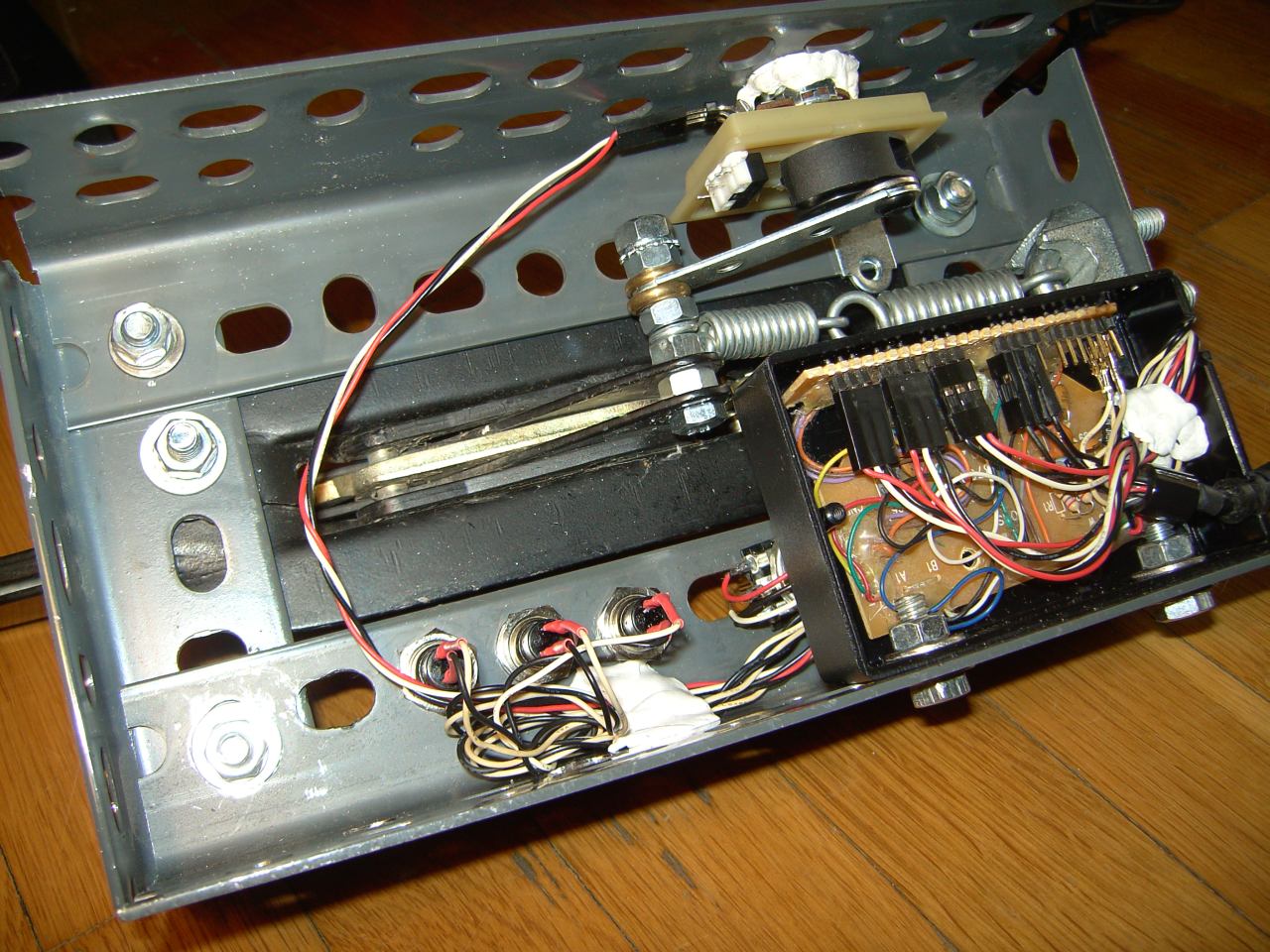

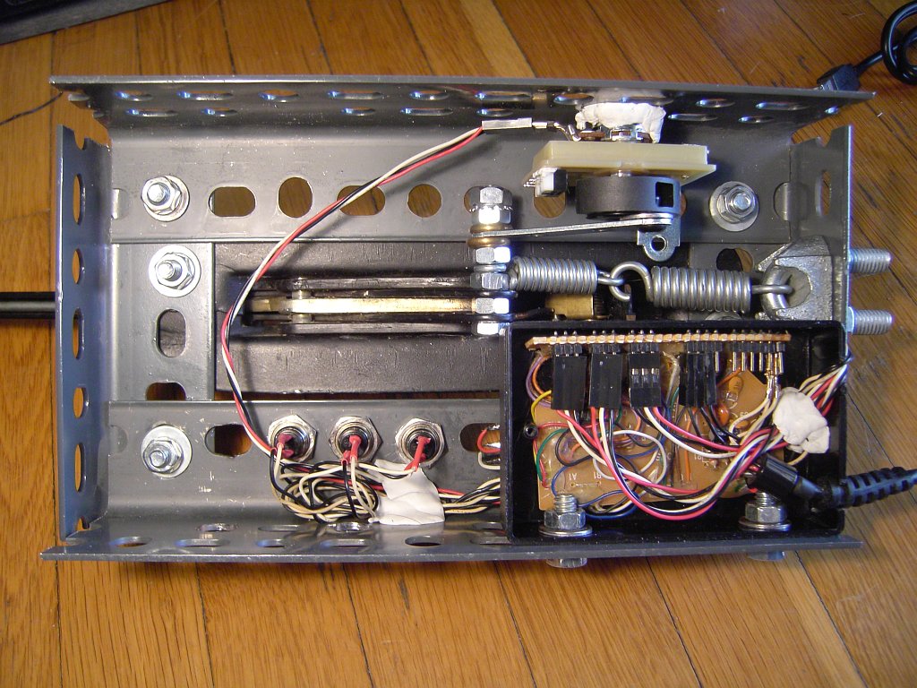

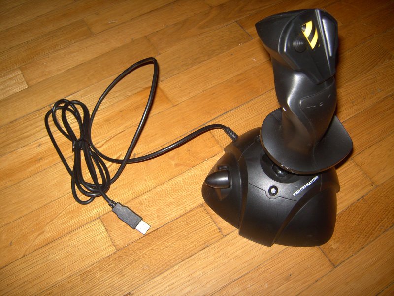

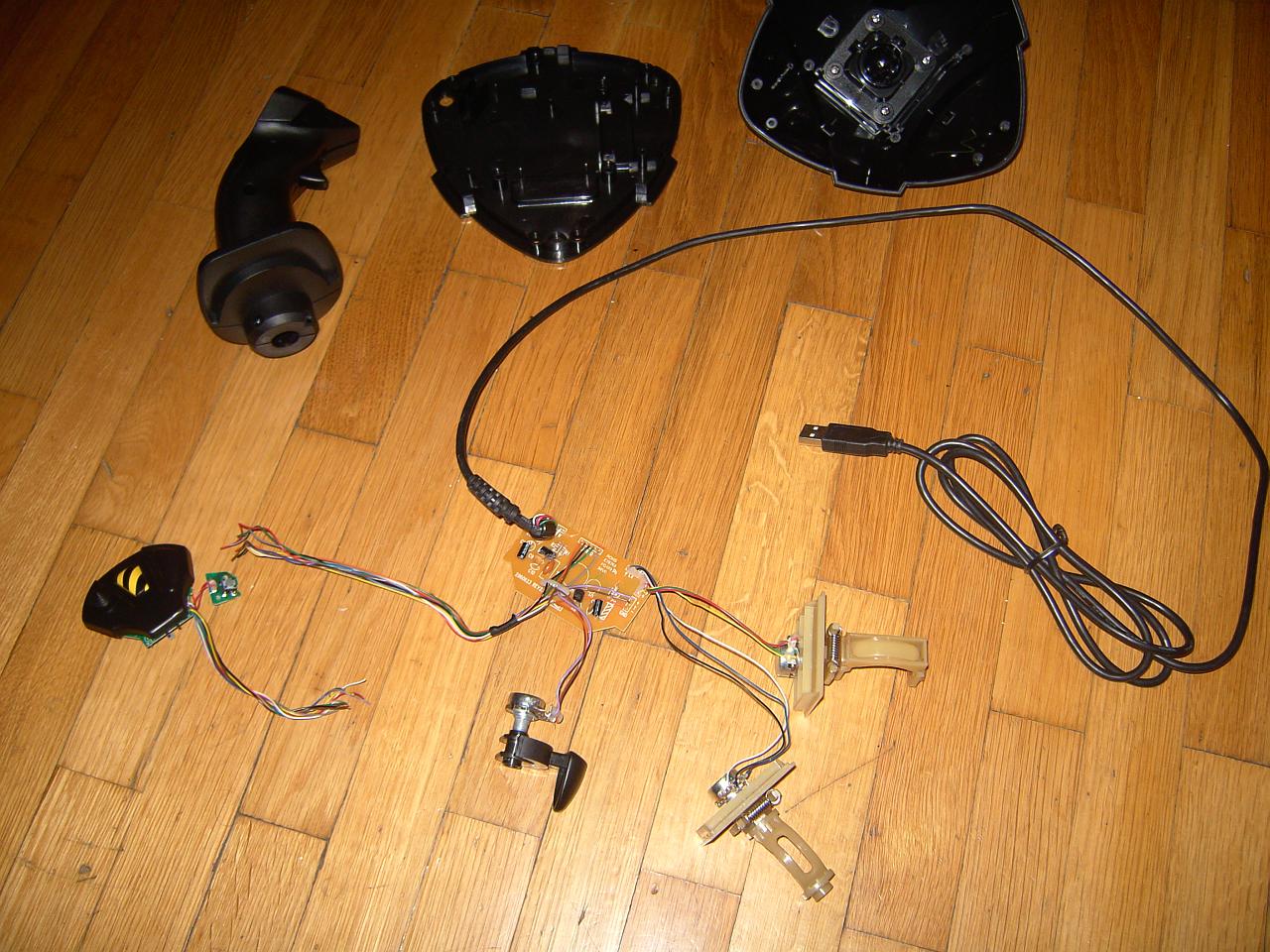

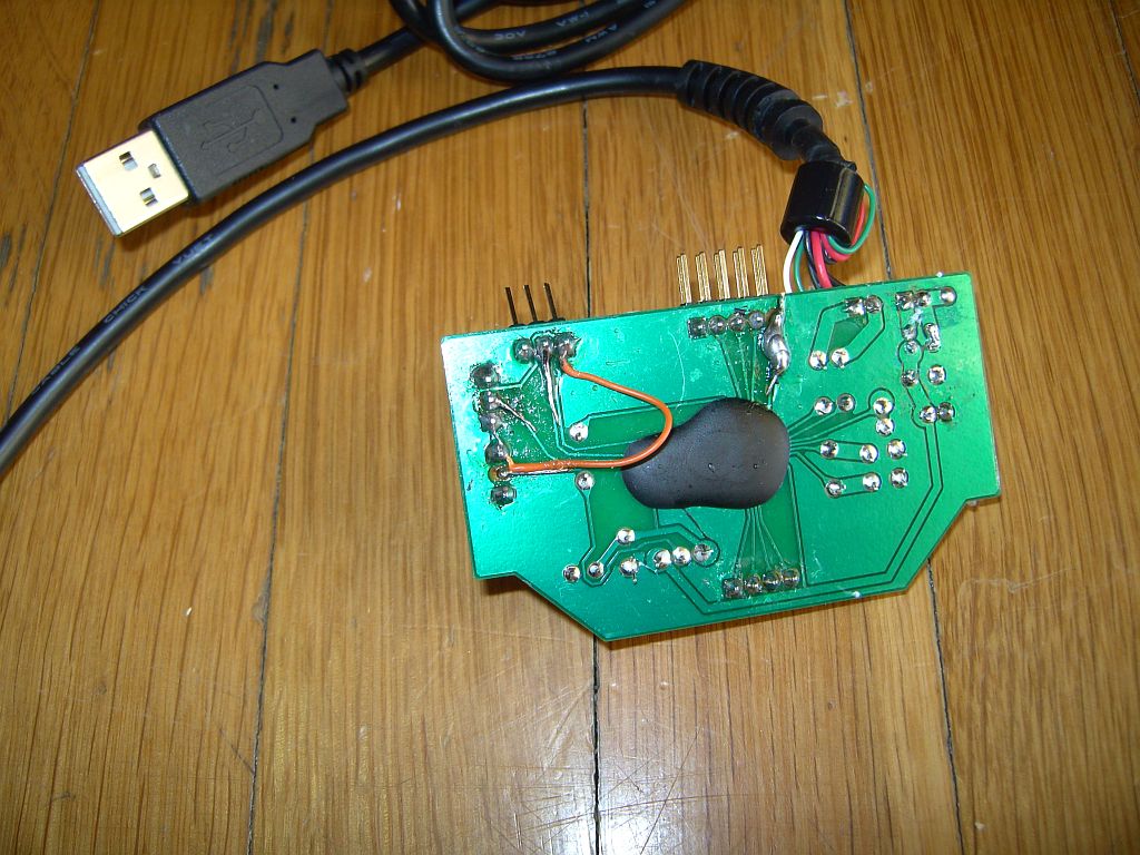

    To interface to the computer I could used the internals of an old unused Thrustmaster flightstick I had around:

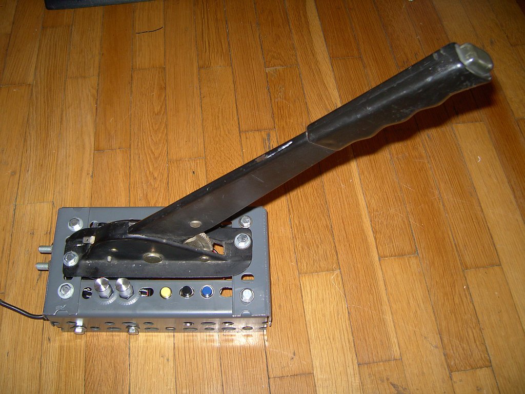

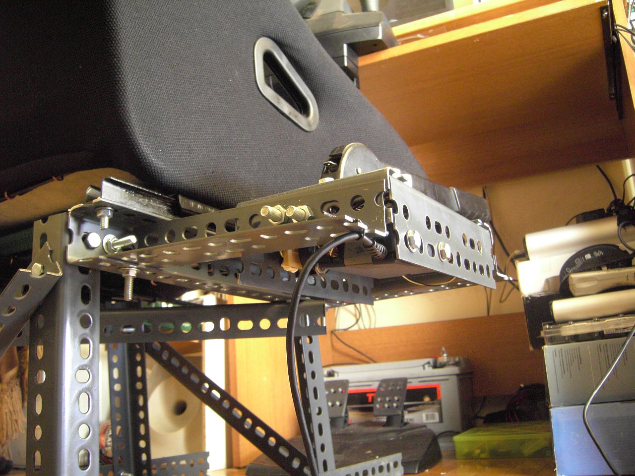

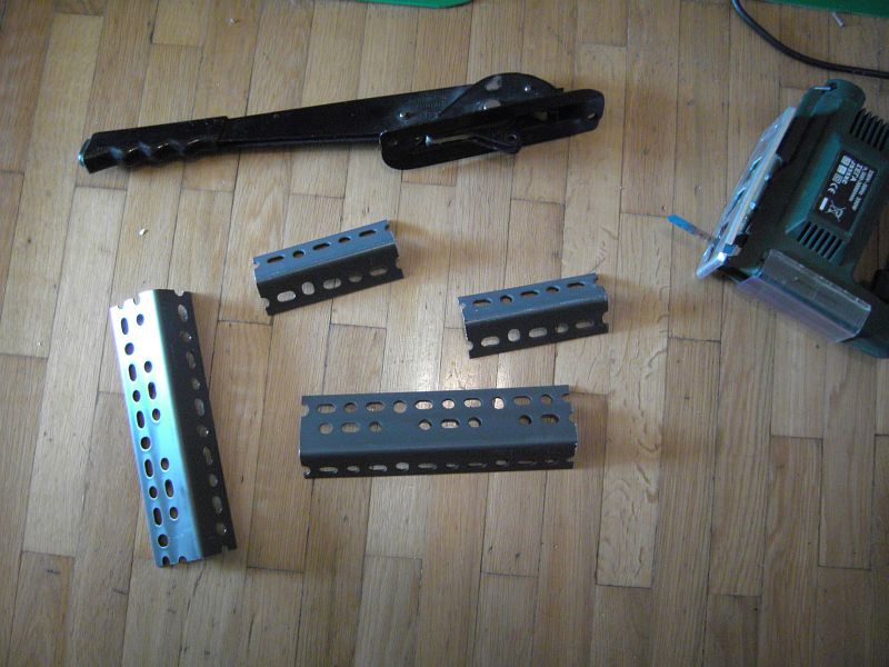

    Now I had to make a case that would host the handbrake and its electronics. For this reason I used my trusty Dexion parts that are already predrilled and easy to bolt together.

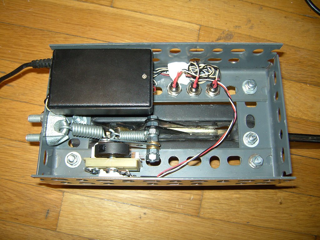

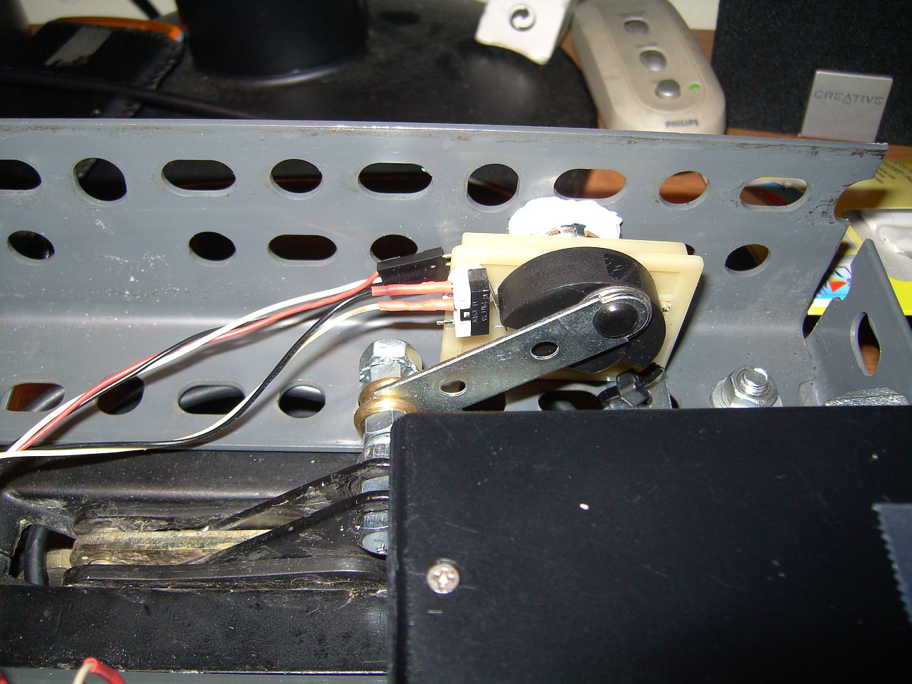

    The mechanism of the handbrake doesn't have resistance as in the real car so I had to add some springs to make seem more real in the feel when you pull the handle.

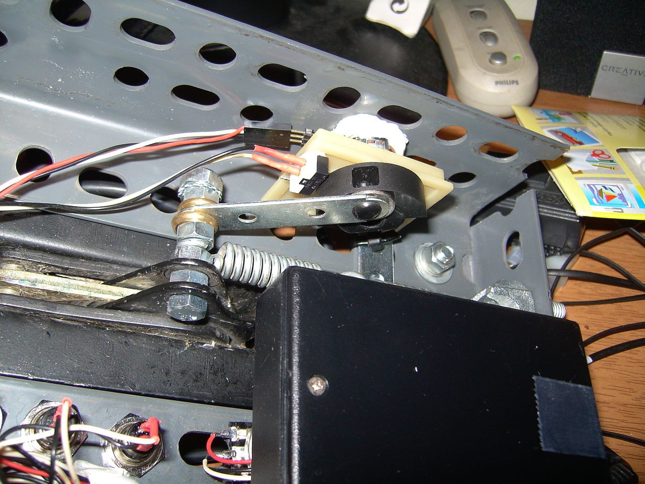

    Also attached the mechanism of the handbrake to the rotary mechanism of the pot that was inside the joystick with a piece of metal link.
    As you can see I placed the electronics in a small box with all cables secured in place with UHU patafix (in case I wanted to rearrange something later). Also used the rest of the axis of the joystick and most of its buttons, placed on the case. Its handy to have these extra controls in reach during a race to setup your car easily.

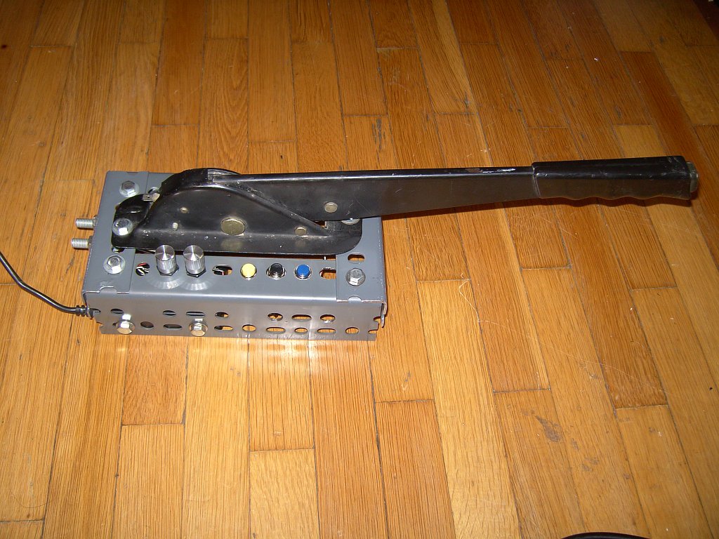

    And here are some photos fully retracted and fully expanded:
    Total cost to build: Less than 40euro!!!
    Time to build: A few hours
    Best regards, Thanos

    I'd like to place a warning about the handling of those cheap USB joystick PCB's. I tried to desolder the cables it had and solder header pins rows to directly plug the cables from the potetiometers and the switches on it, but the process was destroyed the pad connections on almost every input of the joystick... I even tried to repair the tracks with no result...
    Its better to use a piece of a small pcb to place the pin header connectors, leaving untouched the original joystick PCB...
    Regards, Thanos

    On the second part of the video you can see its mechanism tripping a microswitch... This microswitch is connected now on a joystick button input, so the handbrake action can be used also as digital ON-OFF, in some games that don't support analog handbrake...

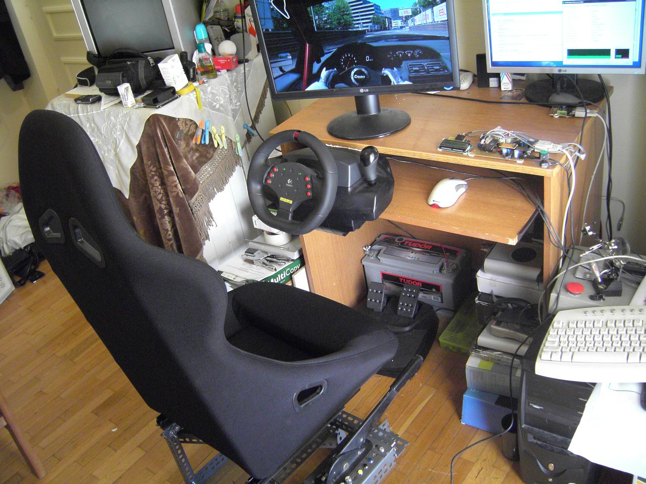

    You may have noticed the lack of my joyrider simulator on the video. Yes its still in not operative condition. I just used the bucket seat and for legs I mounted it on some dexion parts that I had spare and fixed the handbrake on it with just two bolts!!!! It works nice. I can wait to test it with motion on my joyrider too...
