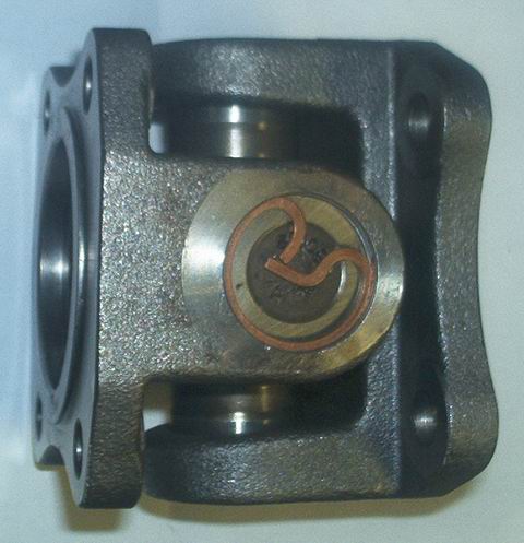

    I am starting to upgrade a Frex Simcon motion setup I purchased. I definitely want to go the U-Joint route, but trying to determine the best option since I do not have access to a torch or welder. Could I just use two of these flange yokes together with a U-joint in the middle or is that trouble?
    Thanks!

    As long as there is free movement without binding it should be fine.

    Do you have more information on those flanges? I had had a similar idea as well. I like what I have but it is very tall; it would be nice to lower my rig a bit.

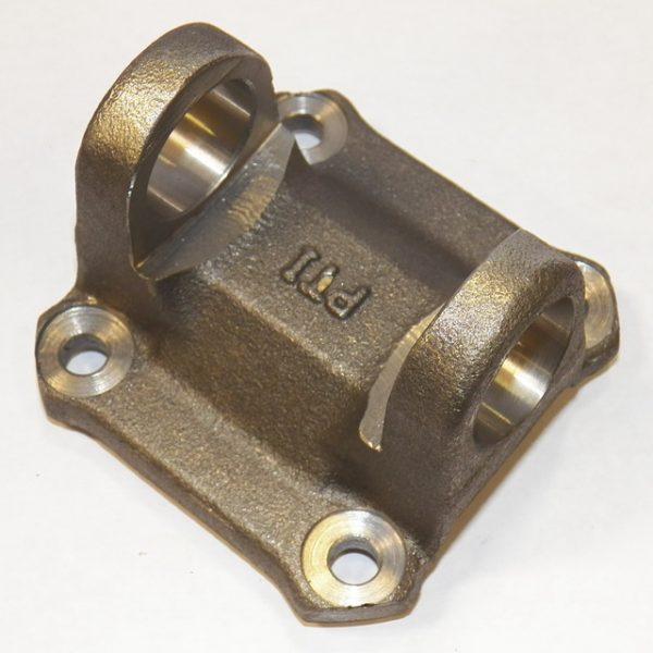

    Here is what I got. I got lucky and found a pair for $20 on ebay. It is part number 2602-35.
    Flange Yoke
    7260 series, x0.3 Tapped Holes on 3.500BC, Ø1.772M pilot
    Design Style Snap Ring Design
    U-Joint Series 7260
    Universal Joint Retaining Width 2.125
    Universal Joint Bearing Diameter D 1.078
    Flange Diameter A 0.000
    Bolt Circle Diameter B 3.500
    Horizontal Distance Between Holes (center to center) 0.000
    Vertical Distance Between Holes (center to center) 0.000
    Bolt Hole Diameter 0.335-D
    Bolt Hole Quantity 0.000
    Pilot Diameter (M-Male, F-Female) C 1.772M
    Centerline of Joint to Flange Face G 1.575
    Compatible U-Joint Kits SPI-5-1306X
    0.000
    Notes Mazda/Kia
    Cast/Forged
    This one would be perfect if you could find it. It's all one unit.
