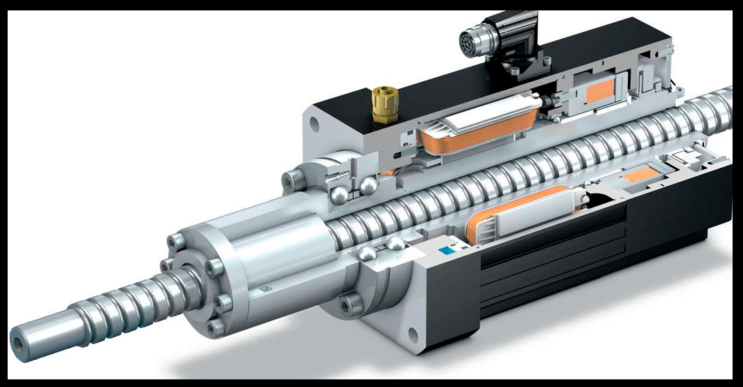

  8. pOmmi
    pOmmi New Member
    Mar 4, 2014
    26
    627Coins
    +29 / 2 / -0
    Realy nice concept !
    What about a servomotor + helicoidal stem like this :
    ... on your 3 vertical axis ?
  9. riton
    riton Active Member
    Jul 6, 2007
    600
    1,006Coins
    +103 / 3 / -0
    the price is the main reason.
    then in my concept, this is the platform that slides on the rods and not the rods that come out.
