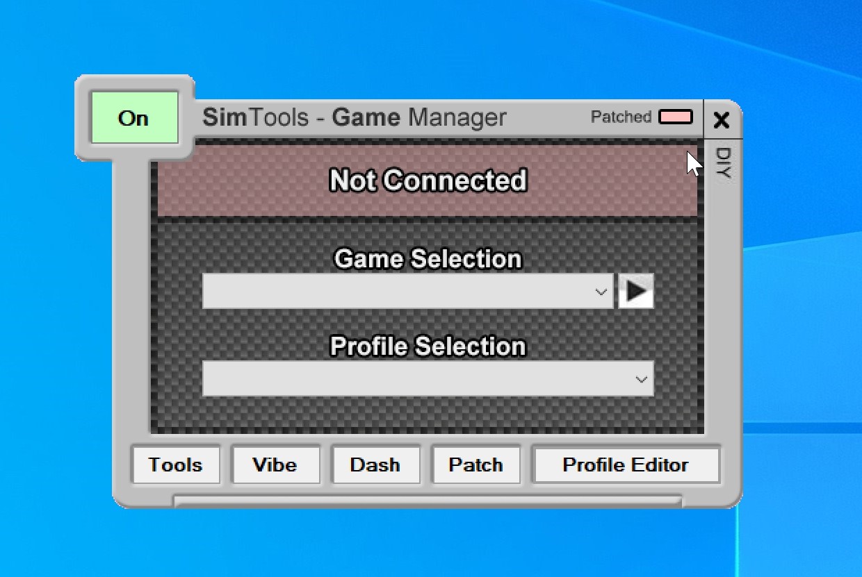

    Hello. Help me please. I am newbie. Installed the plugin from this page
    https://simtools.us/plugin/?varname=220&color=0e97dd
    and now all my settings for other games are gone. what should I do? Thank you!
    Unhandled exception has occured in your application. if you click Continue. the application will ignore this error and attempt to contine. if you click Quit. the application will close immediately.

  2. vrmall2405
    vrmall2405 New Member
    Feb 1, 2023
    - 53Coins
    Проблема решена, путь удаления
    C:\Users\GameV\AppData\Local\SimTools\GamePlugins
    in the folders all the data is located with
    Epic rollercoaster
    21,638
    151,486Coins
    +11,041 / 56 / -2
    SimTools v3 plugins are not compatible with SimTools v2.
    SimTools v2 plugins are here: https://www.xsimulator.net/community/marketplace/
