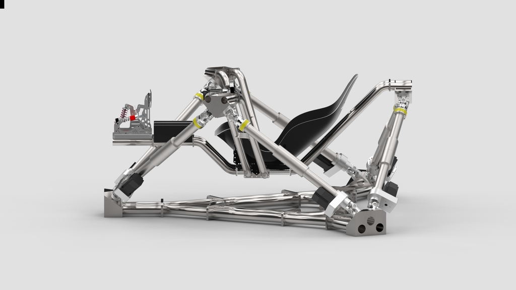

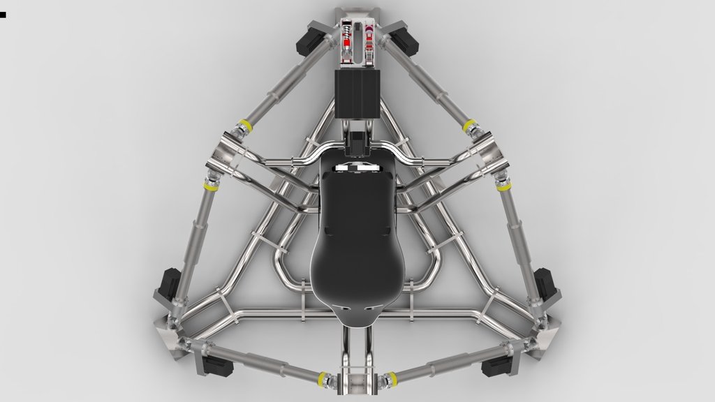

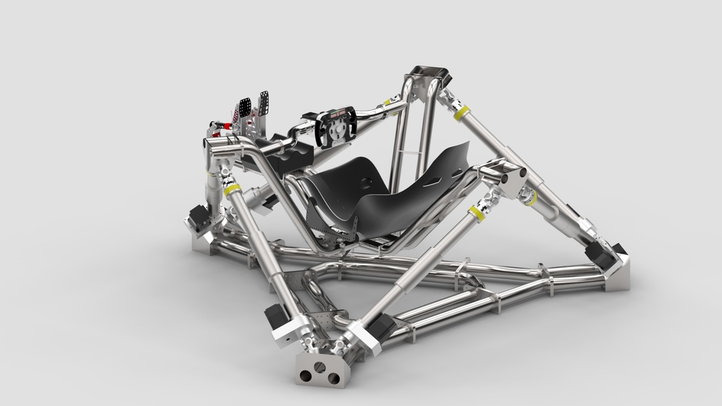

    Hi
    I'm not really sure if it's appropriate to make your first in this section about a new build but I had a bit of spare time the last week and decided to design a simulator. The idea here is to use the same chassis for F1 style, Rally/GT style and flight simulation. I went with a recessed stewart platform, costs are surprisingly low, however I do have access to all the machinery for the cost of only time.
    Anyway, for now I just have some pretty renders, note the steering wheel, seat and pedals are from grabcad.
    Specifications:
    750W motors
    400mm/s max theoretical linear speed per actuator
    +-300mm soft stroke (600mm total)
    +-350mm hard stroke limit (700mm total)
    Modular design for easy transport and adjustments. Low static platform weight (<70KG).
    2.8m x 2.8m open space required.
    Does someone here have any experience using projection/display/headset visuals and can compare which works best, I can build a VR headset into a helmet, I just checked and I can actually make a VR helmet but I'm looking for the setup that's the most fun (and motion sickness isn't fun).
    If anyone has any advice regarding steering wheel setups, I'm not sure if the high torque low speed 130mm 1KW 130mm AC servo or the lower inertia 86mm medium speed 1KW AC servo is better to go with, has anyone tried both and can you offer some advice?
    Any help, advice and tips people have are most welcome.

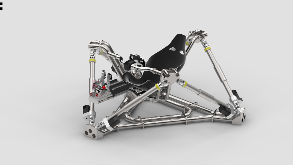

    [​IMG] [​IMG]

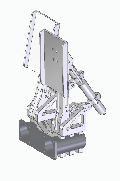

    Looks very ambitious, good luck in pulling this off.
    You'll also need to be careful that the pedals don't foul on the front two actuators as it looks pretty close?
    Seriously nice design though!

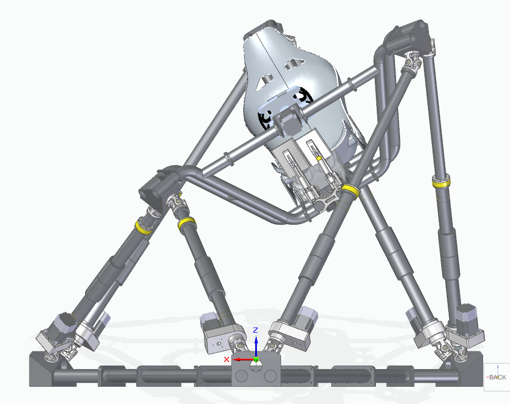

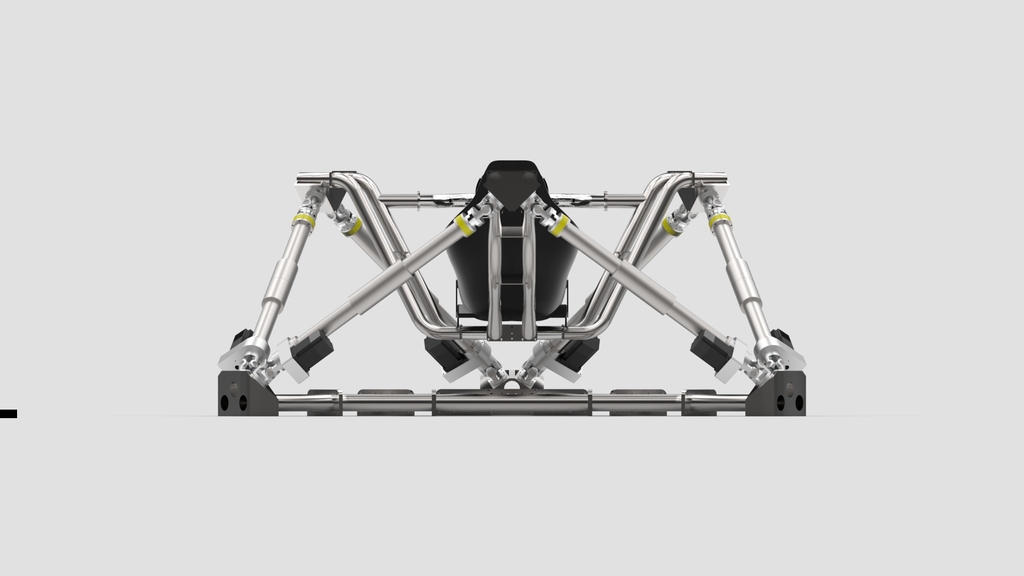

    Promising, although I find the jacks a little too horizontal!
    What is the amplitude of the movements on each of the three axes and at what angles?

    Thank you, you are correct. In the renders it is in an F1 seating position which pushes the pedals far forward and they can touch the frame in extreme positions(full forward pitch and full yaw), for F1 seating positions the end piece where the pedals mount needs to be half the length and the pedal box should be more compact or the soft limits should be adjusted to +-250mm to compensate (or both). This won't be a problem when in the other seating positions where the pedals are moved about 300mm or more back.
    Usually I get reasonably close to the renderings, the mechanical/electrical part are the easy bits, making a nice seat is going to be tricky for me.
    That motor seems popular with DIY users while the lower inertia smaller ones seems to be the one sold in the steering packages.

    +198 / 2 / -0
    They may cause some spikes lower down, but keep in mind using the soft limits they are not quire as bad, the renders attached are at full rest.
    On soft minimum 40 degrees to max 60 degrees per axis, hard limits are a couple of degrees less and more.
    Soft travel limit 600mm, hard limit 700mm.

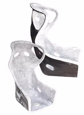

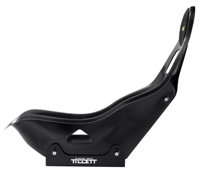

    Understood. Look forward to further updates - Re seat, may be easier to just purchase one (example below from Tillett) - not that expensive in the scheme of things.

    I've worked it a bit, adjusted the rear beam and moved everything back and also changed the pedal box... It clears now at full soft travel.
    I just found this for sale locally:
