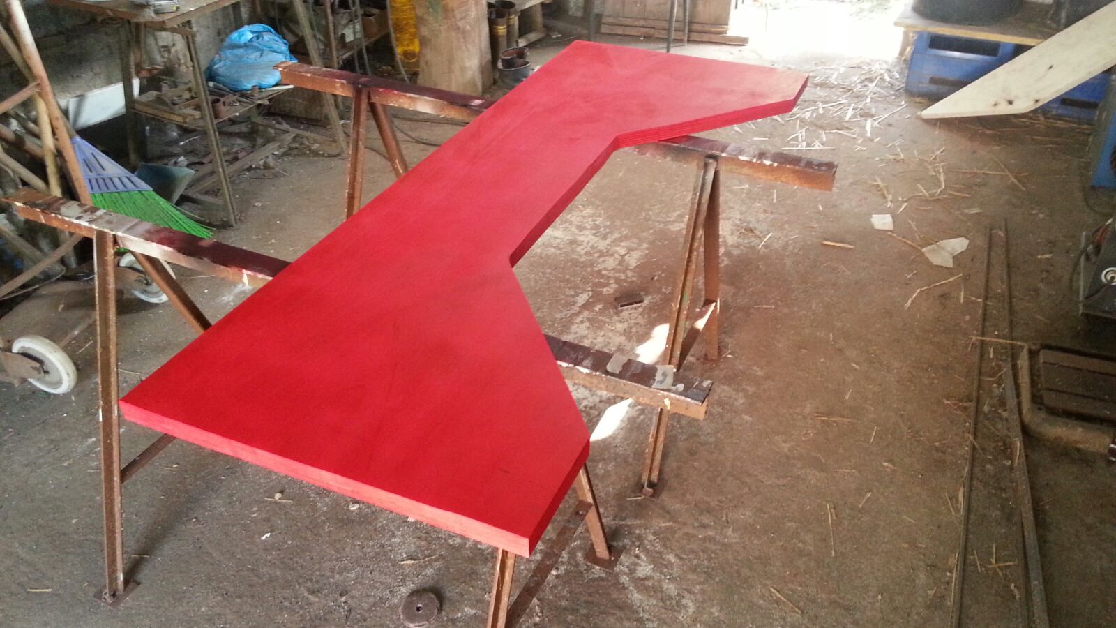

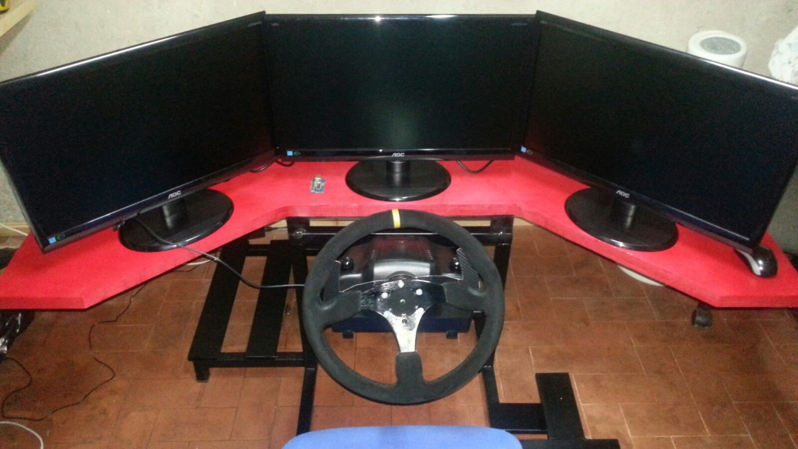

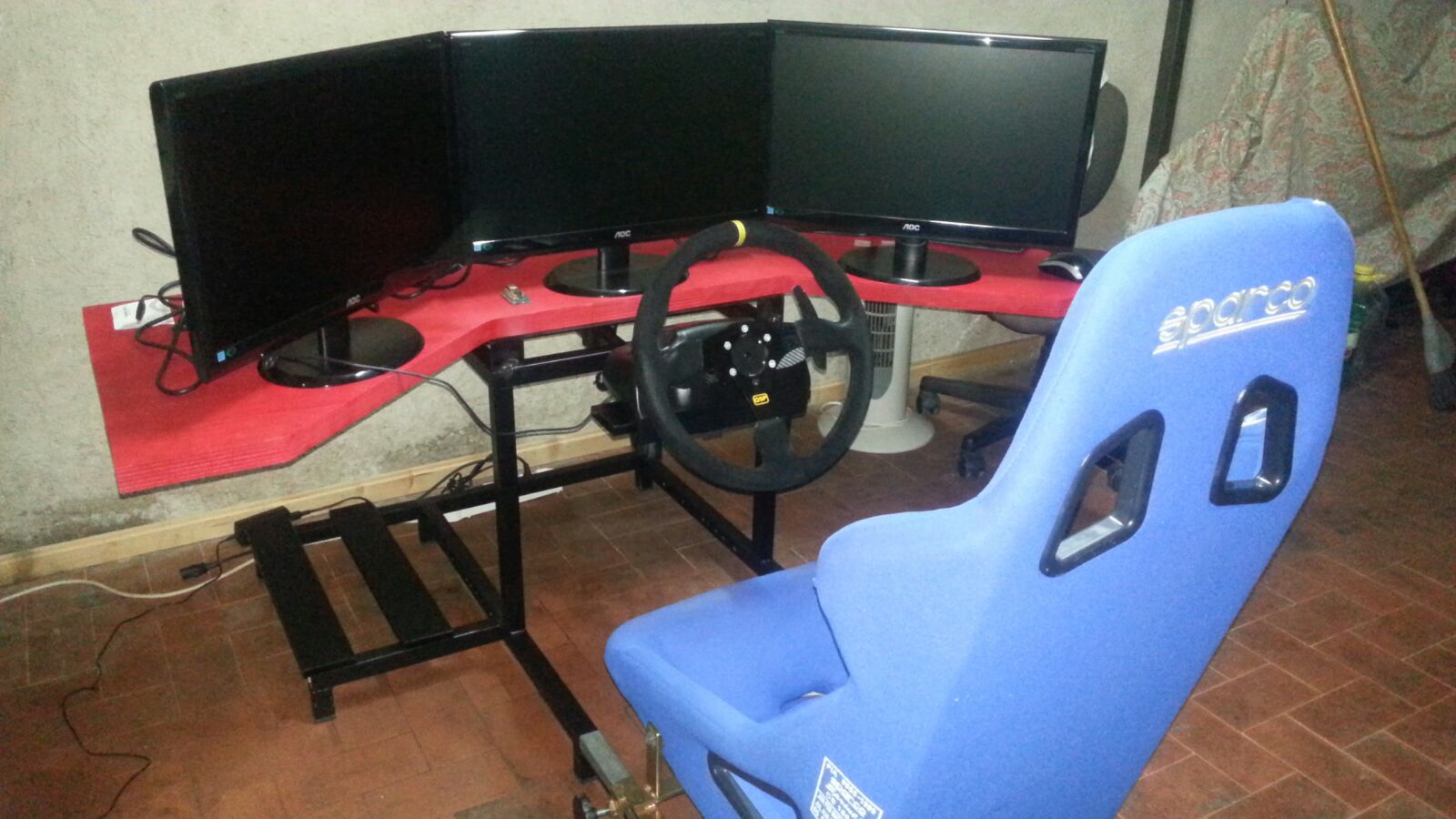

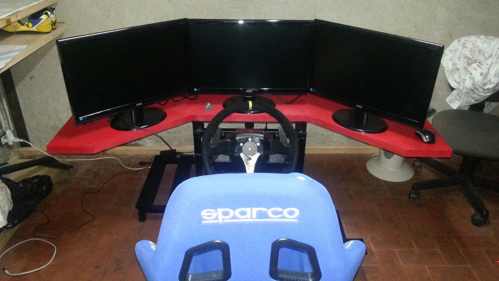

    Hello to all of you.
    This is my static cockpit. In these days i'm working to convert it to 2DOF. :grin:grin:thumbs

    Nice job on the monitor stand :thumbs
    So do you plan a shoulder mount design or something else and what motors and control boards do you have in mind?

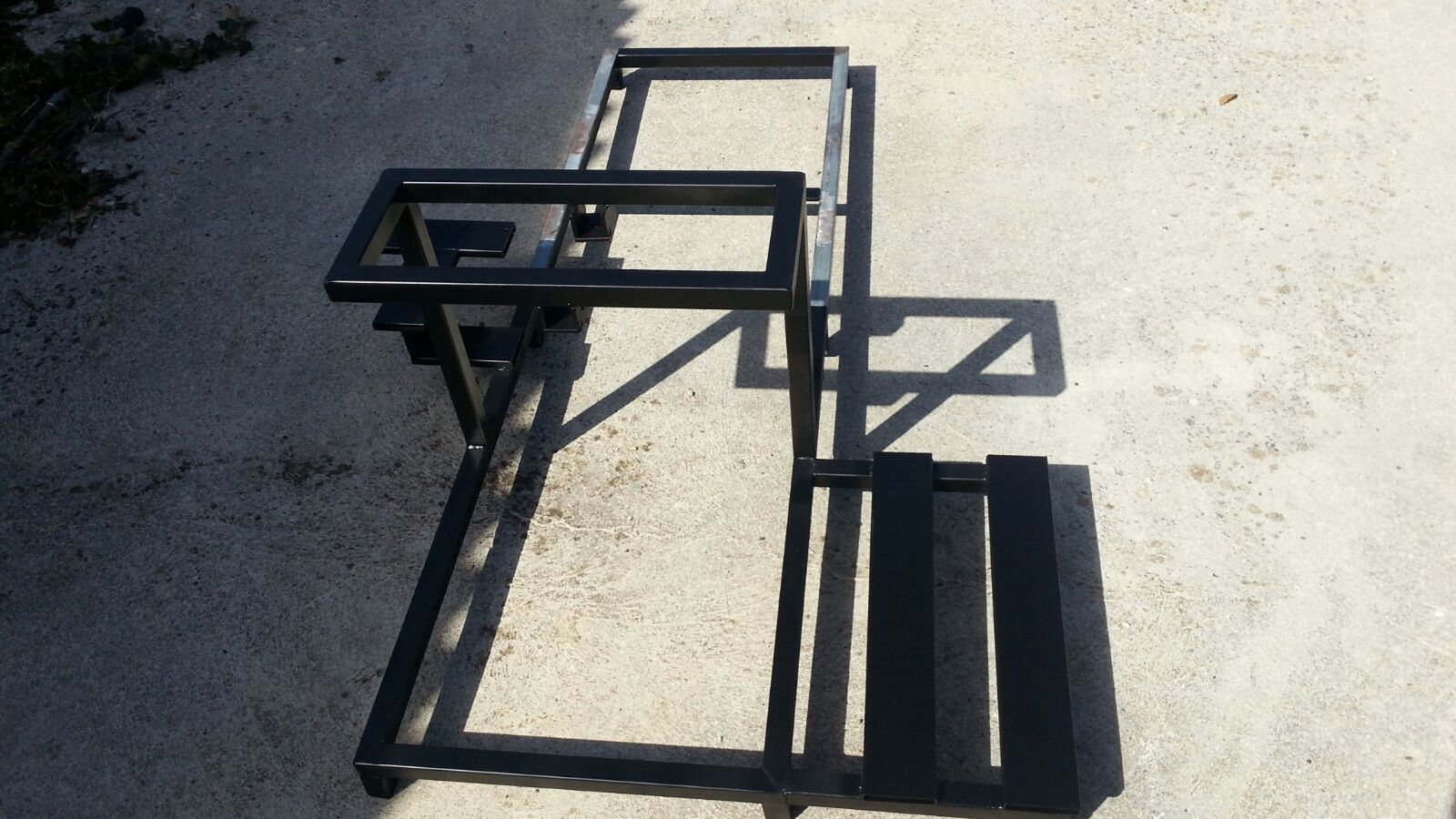

    Thanks @noorbeast
    I will to mount two wiper motors to the back of seat and i will to use Arduino UNO R3 and monster moto shield.
    This cockpit was designed only for static use. The only modify that i will do is raise the height for insert all of strumentation to the bottom. :)

    Hi @Stealthelius - I notice you have a fullsize wheel mounted on the G27? How long have you been using it like that? I've always been tempted to do the same mod but was worried the extra size would put strain on the gears and reduce the life.
    How does it feel to you?
    My G27 gets a beating with the normal wheel size! :)

    Hi @Archie. I've mounted a full size wheel in september. The feel and the strenght of wheel is too light compared to original logitech wheel, infact i will re-mount original G27 wheel next week also for don't damage a gears of wheel.

    @Archie This is a 330mm diameter wheel. IMHO the best compromises is a custom "light" wheel of 300mm of diameter ;)
