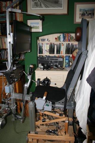

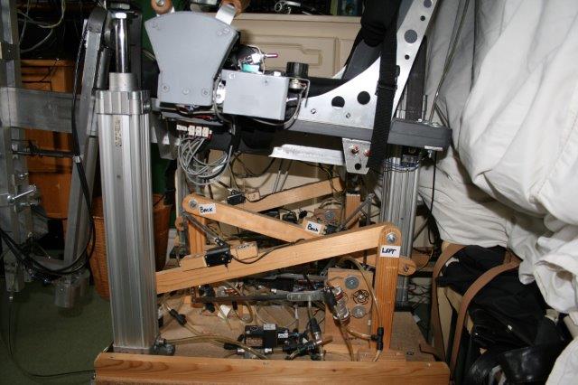

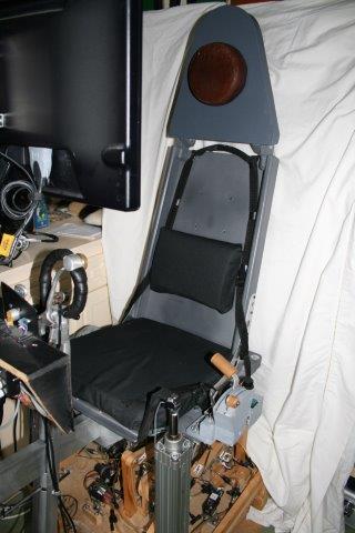

    I hope this is the right place to ask. My pneumatic flight sim motion platform is controlled by standard servo motors operating my air valves. Works a treat in IL-2 with custom software. I would like to run it on Cliffs of Dover and DCS World and I am hoping we can achieve this using the plugins. At present I use Phidgets boards, but am quite happy to swap to Arduino or Pololu Maestro or whatever is the easiest for a non-computer person like me to do. If someone could give me guidance on how to do this I would be most grateful. Please state the obvious as it will not be obvious to me. I attach schematics and a couple of photos as it stands.
