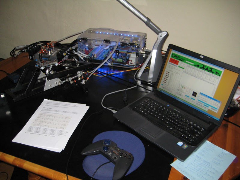

    Hello everyone
    I need help one week doing tests with the prototype of my simulator with everything connected with the matrix and valves I really doubt command will work.
    How establishing the initial position of the simulator (X axis shaft 50% AND 50%)?
    How the simulator returns to its central potion after conducting a movement?
    thank you very much

    If the calibration procedure has been a success, it centers by itself.
    Have you been able to move something yet? Are there lighting up some LEDs at least, when you move the sliders besides the cross in the software?
    Are you able to calibrate without error message?
    Give us some additional info.
    Regards
    Christian

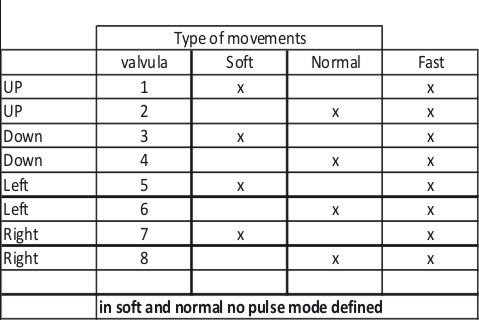

    Hello Christian
    The calibration of force-profiler is ok, my problem is the following, when I make such a move to the right, the machine does not return to the center, but that is as far left. Is it possible that the movements that I am introducing in the matrix are incorrect?
    i´m using 4 electrovalves festo MFH-5/3-E-1/8-B midle closed, 2 per axle to achieve the smooth movement but I am not even able to get all the movements correctly.
    Is there any file matrix like I need somewhere?
    Regards
    Txus
    attached a small video help if something

    It just goes back to center if you press the default button.
    The washout just works in game.
    You should decrease the pressure alot, to get slower movements! Use a valve or just press the air hose to reduce air-flow. Otherwise positioning is neraly impossible.
    which vavle matrix profile do you use?

    Hello Christian
    I have reduced the pressure of air at 6 bar perhaps a little more, the compressor has a pressure regulator at the outlet, the movements are now much more soft. positioning has improved quite close.
    Matrix valves not entirely clear I am using for the fast moving 2 valves for example the 1 and 2, in this same route, it would smooth the valve 1 and 2 normal valve, which I have nothing clear is how it should be done to control impulses to achieve optimal results. (what number of impulses must be used and how many millisecond gap, must be to get the movements smooth and normal?)

    Once again. There is NO pulsmode for your setup! Pulsmode is ONLY for single way valves!
    You have to achieve different speeds via different pressures at your valves.
    For example: every movement direction has two valves, right?
    You have to connect now to one valve full pressure of maybe 1bar, and to the other valve you have to connect maybe 0,5 bar.
    With this setup you would have 2 speeds, right? One speed with 1 bar, and another with 0,5 bar. If you combine them you would have even one speed more: 0,5 bar + 1 bar = 1,5 bar (theoretically, you cannot add pressure that way; just to show the principle behind the concept)
    So at the end you have 3 speeds via different pressures.
    Please make an additional vid with lower pressure to the valves.
    I could make an matrix profile for you. But to be honest, I would like you to make one by yourself, in order to learn how it works.
    I have made a matrix profile for 5/3 valves for a simforceGT already. You could have a look at it to understand the principle. Keep in mind that the SimforceGT hast combined axis, while your RnR setup has not.
    I think you will be able to work it out. Simhawk and I have been able as well ;D

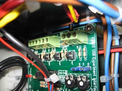

  17. lolilooping
    lolilooping New Member
    Jun 24, 2008
    9
    0Coins
    Hola el_txus, vengo a hablarte ya que tengo mucho visitaron tu lugar internet y eres español y aprecie los españoles. ¿As ti una fotografía del cableado de los potenciómetros? Conecto como el shéma y no va :(
    muchas gracias, un francês que habla un poquito el español :)
  18. el_txus
    el_txus Member
    Jul 22, 2007
    123
    Las Palmas de Gran Canaria - España
    421Coins

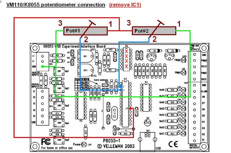

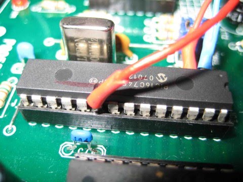

    Hola lolilooping
    Ahora mismo estoy usando otro cableado para los potenciómetros, con el anterior funcionaba pero el voltaje de +5v variaba porque los estaba sacando de A1 A2 de analog inputs de la VM110 te paso unas fotos y el esquema.
    del pin 20 del IC3 saco los +5v no lo he sacado del zócalo como los pines 2 y 3
    El negativo, GND de Analog Inputs
    Este es el esquema que estoy usando
    un saludo
    Hi lolilooping
    Right now I'm using another wiring for potentiometers, but worked with the previous voltage +5 v varied because he was getting from A1 to A2 analog inputs VM110 put some of the photos and layout.
    pin 20 of IC3 get the +5 v I have not taken out of the socket as pins 2 and 3
    King regards
  19. lolilooping
    Jun 24, 2008
    9
    0Coins
    ¿Realmente eso da eso?
  20. el_txus
    el_txus Member
    Jul 22, 2007
    123
    421Coins
    lolilooping
    Si eso es
