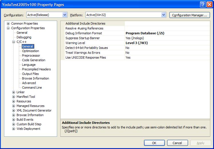

    Thanks .. I am using VC++2005 Express and none of the New Project templates had a UNICODE checkbox option.
    Are you using VC++2005? if yes, can you pls walk me through how to open a new project of type that allows to change UNICODE setting?
    The only unicode setting option I found is shown in attached pic, but changing it did not resolve the appl crash when making GetExport call.

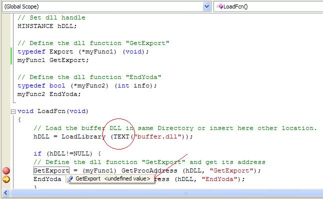

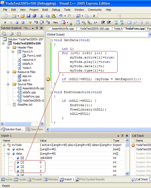

    Thanks again .. I changed the option to Use Multi-Byte Character Set. The appl still crashes when trying to make GetExport dll call.
    Couple of things I noticed:
    1) debugger does not show the address obtained for GetExport, like it does for EndYoda (see pic1)
    2) just before doing the GetExport, I try an initialize myYoda struct, but Watch shows access to array is offset by 1 (see pic2)
    Not sure if these two observations are clues to what's going wrong?

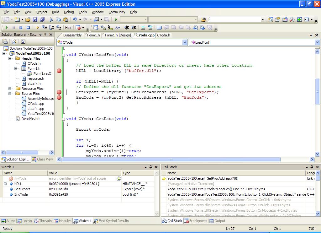

  6. liquid sky
    liquid sky New Member
    Apr 16, 2008
    9
    0Coins
    Think I had the much needed breakthrough!! both EndYoda and GetExport DLL fcns now get an address back from GetProcAddress (see pic).
    Also - GetExport call no longer crashes the appl.
    Your recommendation to encapsulate dll access within a class seemed to do the magic :clap:
    I placed break points before and after GetExport - the Export struct now cleanly initializes all elements.
    Still working on printing the GetExport data onto the form's listbox from within the class. Do you have a quick way to tell if the GetExport returns force feedback data from games (any game you may have) ?
    Solution attached; I'm very excited about latest progress!!
