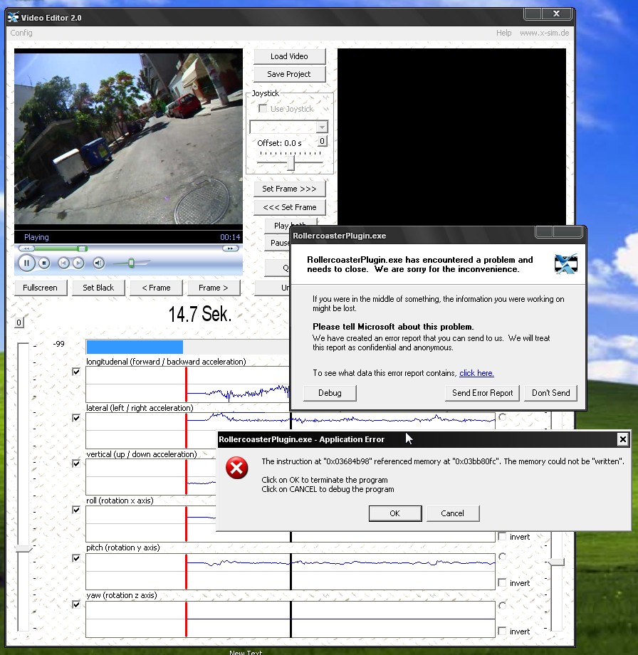

    I was trying to get video plugin working but it seems to crash very easily, or display black video image unless I drag around the window. The most annoying thing is that it crashes to desktop every time I try to get the video played full screen.

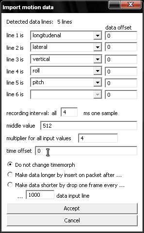

    Inside the zip file there is a photo of the settings I use to import the txt file that contains the motion data.

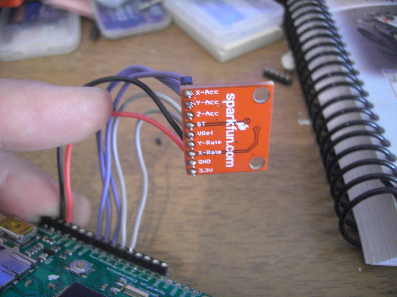

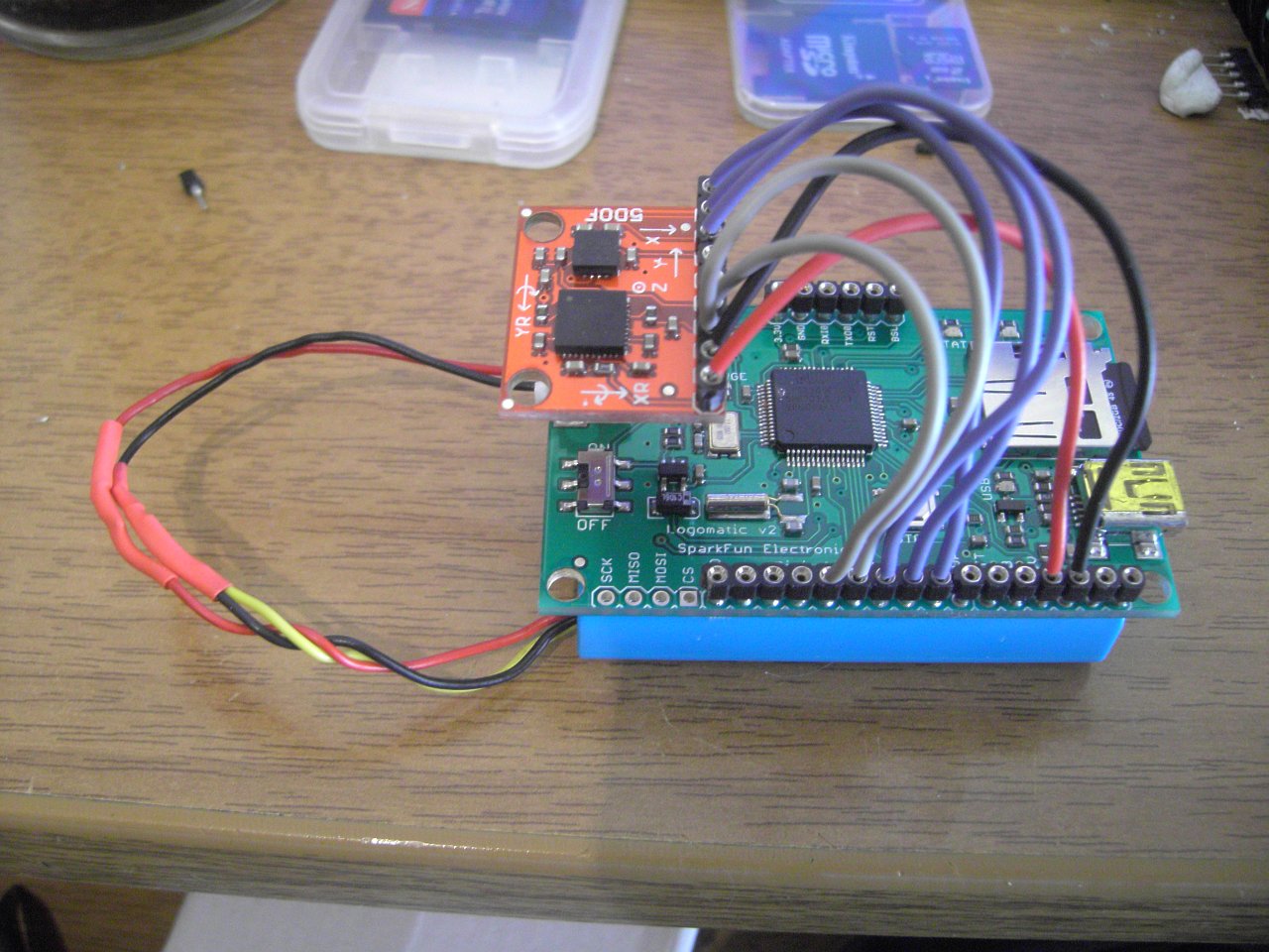

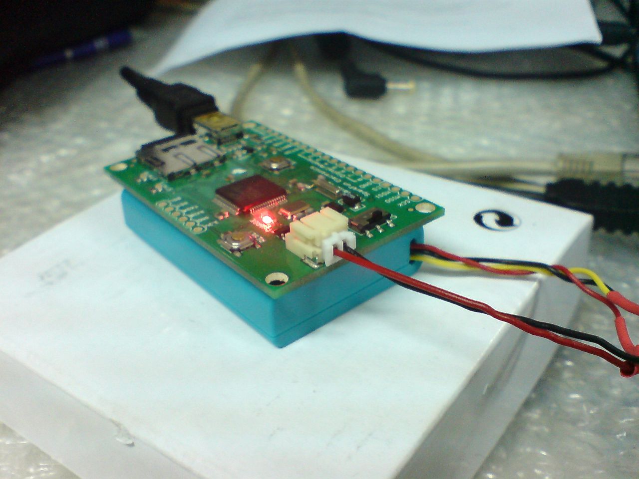

    For datalogging the motion data I use the Sparkfun Logomatic v2 and for sensors the 5DOF IMU:

    Anyone tested this yet? Can you confirm the crashes (like when pressing to view the video fullscreen?
    Or it is my windows video codecs issue? :sos:
    Regards, Thanos
  3. tronicgr
    tronicgr
    Oh, Thanks!!!! Disabling the overlay option in mediaplayer's options, really did the trick!!!!

    In order to make it work you should open the Video-plugin and load first the video Pict2756.avi. Then from the menu of the video-plugin window you must Import the LOG07.txt. In the configuration screen that appears when importing motion data file you have to choose some settings that declare the sample rate of the captures data and the amplification of its values if they are too low. These settings can be seen in the third file inside the zip called test motion video settings.jpg
    You may need to swap the Longitude and lateral data lines, as I had connected differently the sensor board from the default values in the video plugin. BTW in this test video I used a normal narrow type video camera, not the GoPro Hero Wide

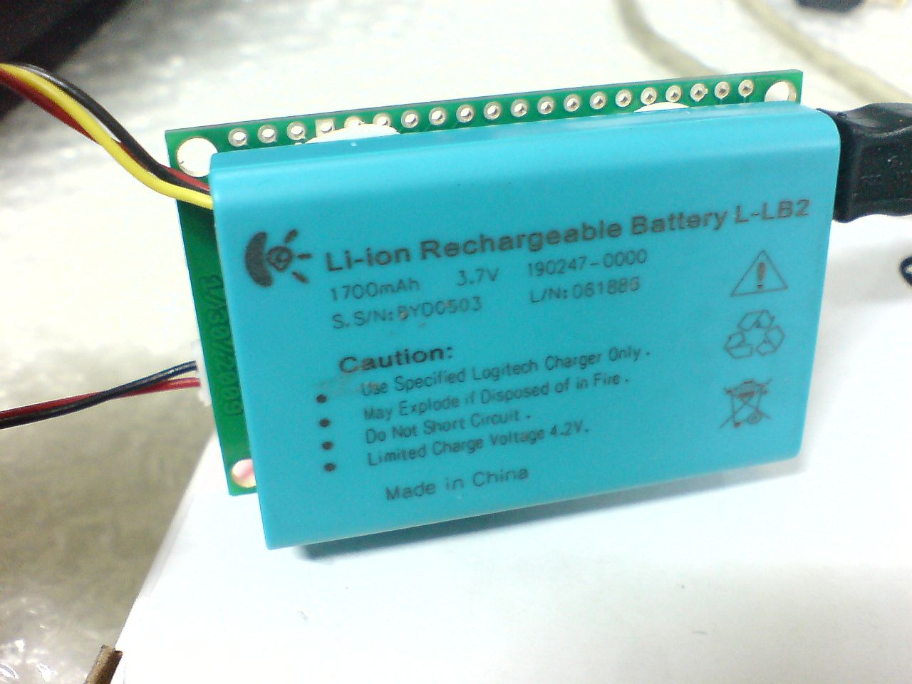

    About the Logomatic and the 5DOF IMU... The complete device consists only by these two little boards, connected to a 3.7v lithium from a mobile cell phone!!! The battery is charged over the USB cable when the device is off.
    If you turn on the device after you connect it on computer USB port it appears in the drives like a flash disk drive that gives you access to the MicroSD card contents. Now the really cool part is that Logomatic creates a TXT configuration file that is used to determine the number of ADC channels used and the rate of sampling. For 5 channels I could achieve 250hz sampling rate that equals to 4ms delay in profiler video plug in!!!! Almost as fast as my AMC cycle rate!!! The best part is that Locomatic has onboard voltage regulator and output pins for powering external 3.3v compoments. So the 5DOF IMU is powered through the Logomatic from the same battery!
    Here is the Logomatic's configuration TXT contents:
    Code:
    MODE = 2
    ASCII = Y
    Baud = 4
    Frequency = 250
    Trigger Character = $
    Text Frame = 100
    AD1.3 = N
    AD0.3 = Y
    AD0.2 = Y
    AD0.1 = Y
    AD1.2 = N
    AD0.4 = Y
    AD1.7 = Y
    AD1.6 = N
    Saftey On = Y
    I bought both Logomatic v2 and 5DOF IMU from Sparkfun relatively cheap from other similar products around:
    Logomatic v2 Serial SD Datalogger:
    https://www.sparkfun.com/commerce/product_info.php?products_id=8627
    IMU 5 Degrees of Freedom:
    https://www.sparkfun.com/commerce/product_info.php?products_id=741
    And you will also need this cable for the JST mini power connector of the battery:
    https://www.sparkfun.com/commerce/product_info.php?products_id=8670
    You can use any MicroSD card up to 2GB with logomatic. These cards are quite cheap these days!

    I still need some help with the video plug in. It keeps crashing for no reason on random. Here is the error message it gives, before the video-plugin closes:
    And another issue that is even more important at this time is how to properly sync the video with the data. It seems that even If I give the correct values in seconds in the offset box, it keeps the same wrong sync. What is used in Offset value? Seconds, Microseconds? What? And will negative values work too?

    i tried last night for some hours the video plugin with your g-logs and video daa.
    Results as follow:
    - no sporadic crashes, so i can not reproduce that. Maybe your video codecs are broken? You could try another xp installation to see if it crashes nevertheless.
    - The length of te video and the timeline of the g-data sequence starts and stops syncron with the movie, but the effects does not fit excactly to the movements. It looks like when the g-data stream is shrinked or stretched to fit to the movie stream but that can not be as the setting is do not change timemorph
    Recording interval of 4ms by the logger is correct?

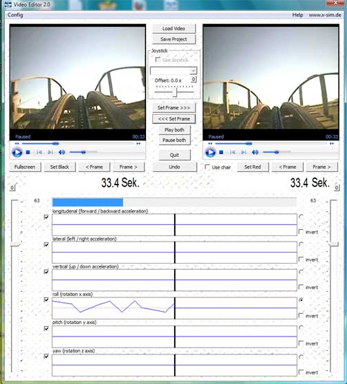

    having some challenges with the video editor 2.0;
    save project is pressed and a file is created with the extension .fs2 (same directory/file name as the video);
    when this file is double clicked the video editor opens but no video or axis data appears;
    here is an example of the beginning of a .fs2 file using only the roll axis:
    [FileData]
    Path=C:\Users\John\Desktop\Simtestvids\testvid1.wmv
    Duration=1159
    [Data]
    Block1=000000000000000000AB0000000000560000000000000000000000AB000000000056000000
    0000000000000000AB0000000000560000000000000000000000AB00000000005600000000000000
    00000000AB0000000000560000000000000000000000AB0000000000560000000000000000000000
    310000000000610000000000920000000000C20000000000F3000000000023000000000054000000
    0000840000000000B40000000000E50000000000150000000000460000000000760000000000A700
    the actual loading of the video and axis editing seems to be fine...
    here's a screen shot at the time of saving project
    have tried a number of different videos in different formats - same problem;
    also, X-Sim Wiki refers to the axis data file as an .fsm type file - not a .fs2 type, and indicates
    Also you have to load the Video plugin .rn2 simulator profile file in the profiler2
    guess I'm generally confused about using the video editor....
    any ideas would be much appreciated
