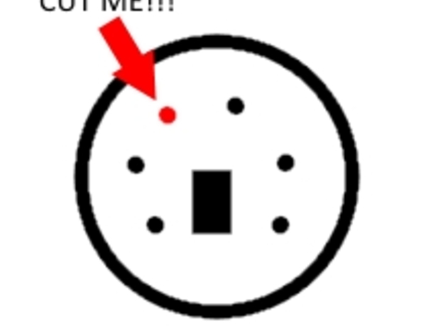

    OK, lets build this, so...
    TODO:
    1) Print3D the holder
    https://www.thingiverse.com/thing:1160307
    2) Make a Thrustmaster connection cable [ 5-10cm depending on preferations ], things to buy for less than 4$ in total [ for 4 connectors, including male and female ] mini DIN 5:
    http://www.ebay.com/itm/172589622963
    http://www.ebay.com/itm/172590003229
    3) put all things together with your TM Warthog Hotas and... done [ you have a 50$+ extender ]

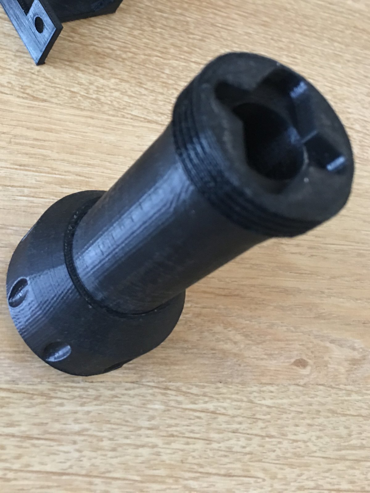

    On the bottom part the sleeve that holds the stick shaft is very thin. I had to print it at 100% fill to get it strong enough to not try to flex.
    The guy who drew it up did a great job though. The holes for the connectors are a perfect and tight fit for the DIN connectors from DigiKey. Some baking soda and superglue will lock them in beautifully.

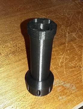

    I did the updated 1 piece, with 50% fill - seems pretty strong to me, although will see when I get it all together.

    I needed a bit more extension so was referring to the multiple prints where you add your own extension tube to go between the top and bottom fittings. The one piece job looked slick so glad it worked for you. Does the one piece lock and hold the stick handle in position with the little clover keyways or can things rotate?
  11. SeatTime
    2,573
    28,370Coins
    +2,844 / 39 / -0
    It's all locked in tight :). Added about 10cm, so perfect for me.
