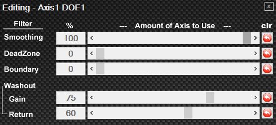

    I looked at
    https://www.xsimulator.net/community/faq/washout-gain-and-return.303/
    and my version just has washout alone.
    The gain and return look like they would help me get it to be more natural

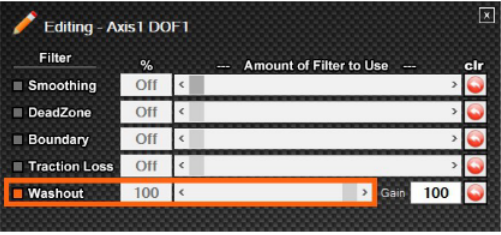

    I understand, but his example shows a heading of WASHOUT with GAIN and RETURN as the two settings that have adjustments for each. Mine is just WASHOUT alone.

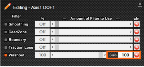

    This is the adjustment page I'm looking for. Perhaps WASHOUT = RETURN ?
  6. yobuddy
    5,282
    49,198Coins
    +5,093 / 18 / -0
    What @noorbeast posted above is the same thing.
    Return:
    Gain:

    It would have been an easier answer to just say, "the graphic has changed, the new one does the same thing."
  8. yobuddy
    5,282
    49,198Coins
    +5,093 / 18 / -0
    Please understand we were just trying to show what it looks like in the current version.
    And since not everyone here speaks English natively, helping people with pic's usually helps the current user, and future users also.
