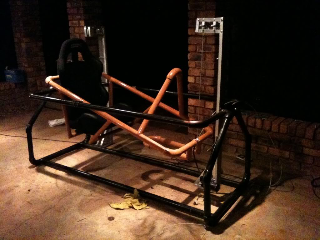

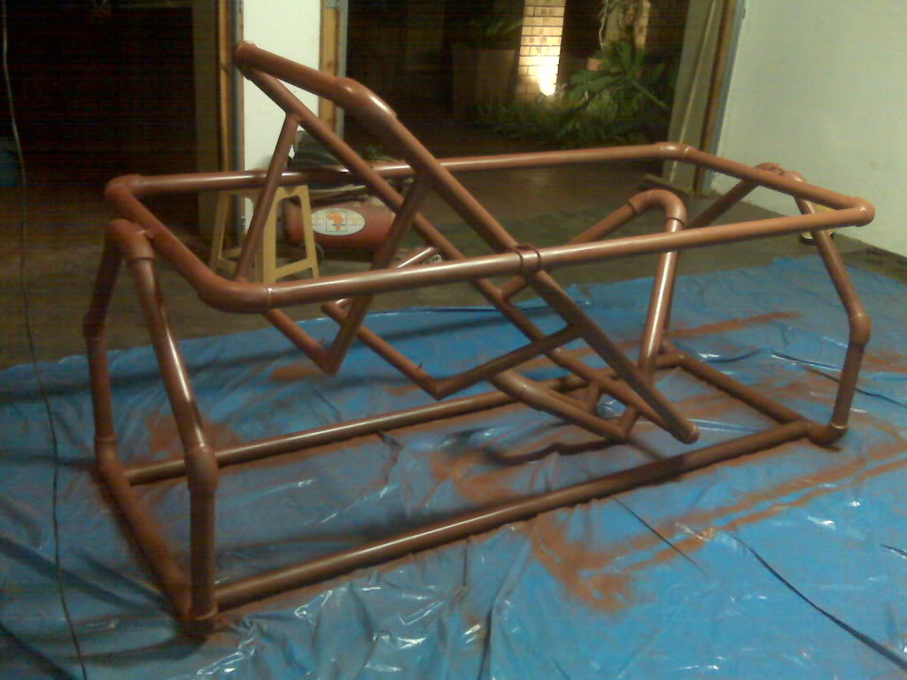

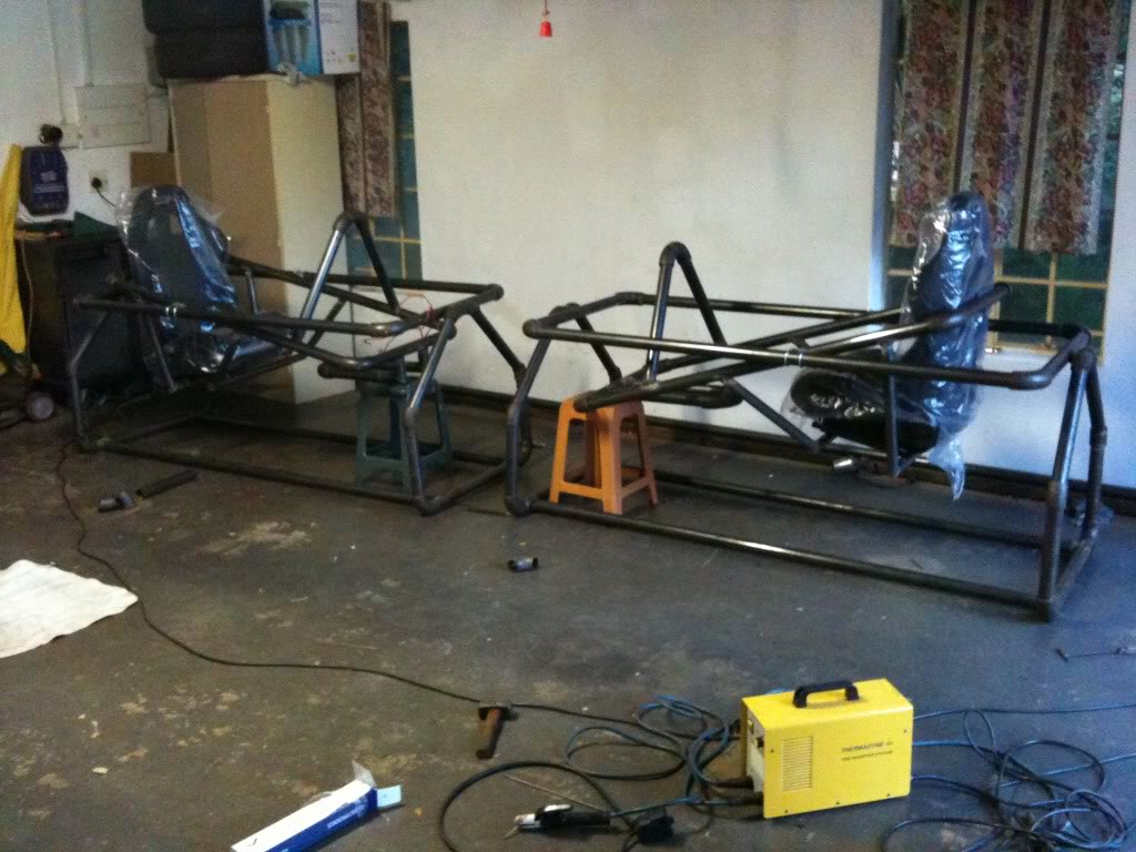

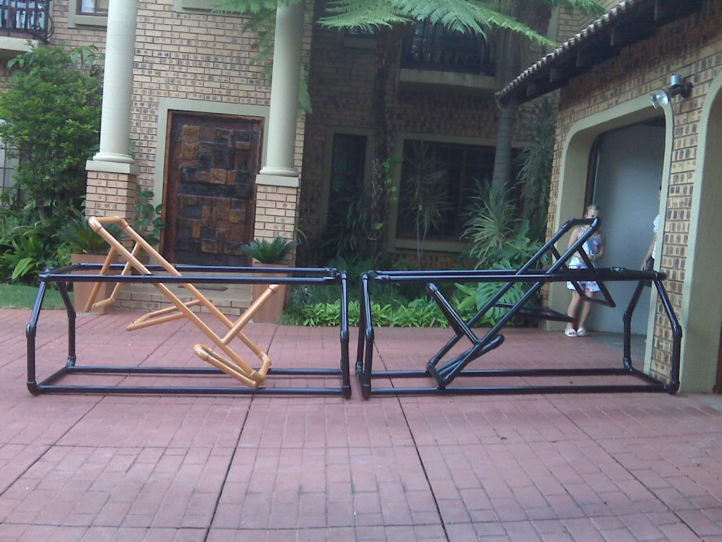

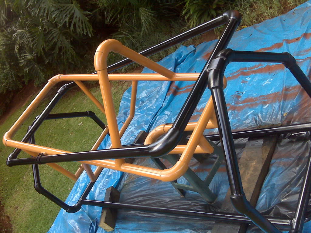

    Hi Guys, here we will keep the data and progress reports of our simulators. So far we have managed to build the circuits that TonicGr posted, and they are both working properly. We have also constructed the base of the frame, and today we will start bolting on the support structures for the motors, screen, keyboard, etc etc.
    Here we have the frames built and the seats fitted to get a feeling for what they might look like when complete:
    Then it was over to sanding, filling up and some more sanding as we prepared them to be spray painted. Finally that was done, and we managed to get the primer on.
    After drying we started with the color. I went for a bright orange for the inner frame, while Robert (due to the paint running out) did his entire frame in black.
    Next we will start with the motor mountings, screen mountings, and the rest of the stuff to finish them off, but the end is in sight :)
    Next update soon!

    Looking great! I really like the orange/black combo!

    Now, here is something BIG you need to watch out for when you are building a frame out of steel... The housing of the wiper motors are connected to ground, so when you mount your motors, you have to ensure that they are isolated, because when the H-bridge changes the polarity on any motor, guess what's gonna happen.. ;) You are gonna go flying out of your sim, that's what's gonna happen!

    For insulation use a harder type of rubber or PVC 2-3mm thick. Great insulators, cheap at any hardware store, easy to cut to any shape and it will help reduce vibration from the motors.
    And of course, ALWAYS check the electrical connection of your electronics! :D Especially the motors. You could take it apart and see if you can disconnect the housing from the (-) and ground it with the frame.
    Be VERY VERY careful not to short anything while you are building! Grounding your frame will protect you, but if something goes wrong you will probably shoot your electronics. Although you are not working with high voltages, the motors will generate enough to get you out of the sim :)
    And don't even think about playing with electronics on your doughters birthday. All this stuff will wait an other day, but her birthday is just once a year. Spend the time with the family because it is a lot more important than a stupid piece of electronics.

    Congratulations... seems to be a very clean project. :hi: and welcome to the joyrider's world
    I've been looking your frames, and although they are made with metal instead of pvc, your designs looks different from the original joyrider.
    I'm talking about the reinforcements placed at the base frame. Have you think about the vertical forces? Look at this img to show you what i mean (i've taken an old picture of my joyrider):
    I think those reinforcements were designed for distribute the forces along the tubes... note that the base frame will sustain all the weigth of the entire joyrider (plus lcd, steering wheel) and your own body as well... that's would be around 90-100kg. Add the Rotational inertia and you would end with more than the force your vertical tubes will handle.
    If you have calculated that, and you know it won't blend, perfect, i will keep my mouth shut :tape:
    Regards :cheers:
    knob2001

    Although steal is much stronger than PVC pipes, the welds can easily break or bend. It will strengthen the frame for longitudinal forces, and I also recommend it.

    Thank you very much for the comments and suggestions! We have tested the frames for the inertia and weight that we would potentially handle, and taking into account the fact that the tubes are 3mm thick, and we welded everything almost all the way, I am quite confident that extra strength is not going to be required. However, only time will tell. We twisted, jumped on and pulled them as hard as we could, and so far it all seems to hold up very nicely, but once the motors are doing the work, we will have to see what happens. As far as the motors go, I managed to disconnect the ground from the casing, and now I can turn each motor individually with it's own floating ground, so I am not stressed about that any more. The last part (and this seems to be a problem), is how to mount the 10 turn pots to make sure that they turn the full 10 turns when the pulley does only 1 turn. If I take a few close ups of our supporting frames, do you think you can throw some suggestions my way?
    I had a look at how Tommy did his, extending the shaft from themotor to outside the casing, and then using lego gears to turn the pot, and that seems to be good, but I am just wondering if there isn't an easier way to do it?
    Let me quickly run to take a few pics of all of this...

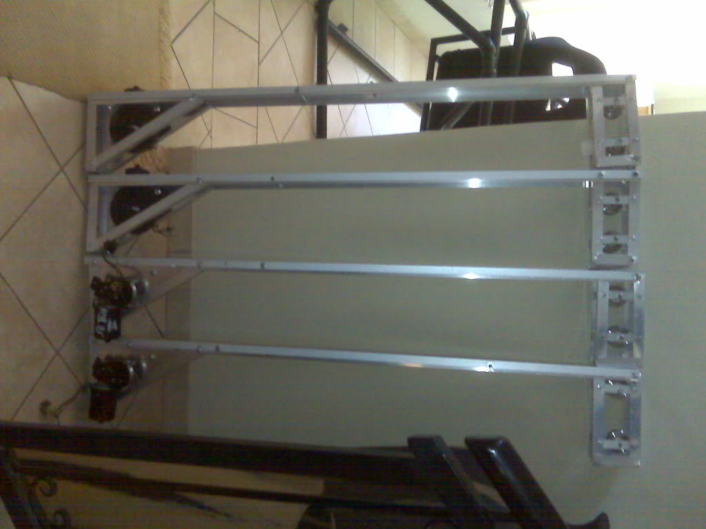

    Update time again. We moved our simulators to our different homes, so that we can be a little closer to our families while finishing the work we need. I have started the testing on the electronics, and Robert has been finishing the mechanical work on the frames for the screen mountings, etc.
    We also redid our motor mountings, because we needed to include the feedback pots (which will not be redone AGAIN for the third time). And we will also do it a fourth time when change from using pots to using hall sensors, but that's in the time to come...
    Anyway, on to some pictures:
    Here are the four completed supports for pulling the frames up and down. Notice the new and improved motor mountings, as well as the extra strength added with the enclosing of the angle iron inside the aluminum ducting.

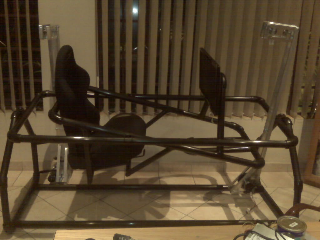

    This is what Roberts frame looks like now. He finished the screen mounting and also mounted his supports firmly.
    And here is a pic of my sim so far. Yesterday I used some old fan belt lying around (got the right one this morning), and connected the frame to the motor quickly for testing. It turned out that moving up was WAAYY faster than moving down, and my AMC got EXTREMELY hot while doing it through there. So there is some work to be done ;)

    You are building awesome simulator!! I like it a lot! I decided to make base for my simulator of a metal too!
    I see you changed proportion... Your sim is wider, am I right?
    May be you could share the plans of your sim with us? It looks pretty balanced!!
