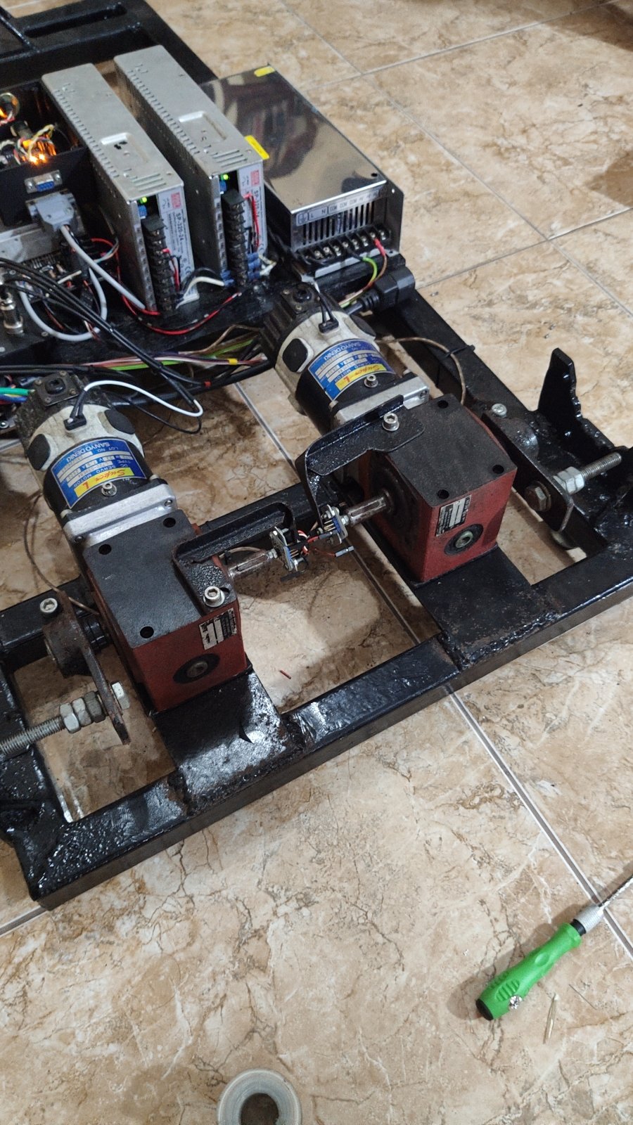

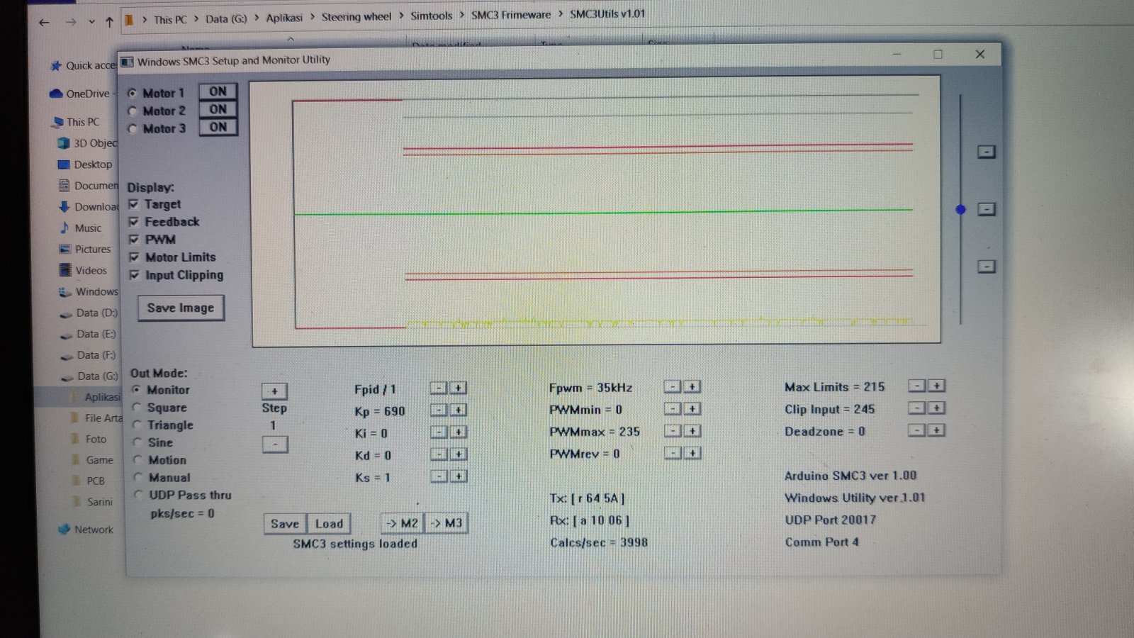

    I have problem with my motor wich some motor like a delay. I do same setting on smc3 utility. With same frequency also. But one of my motor get faster, other one slowly. Even i switch the motor, always motor 2 will get slowly.
    So the feedback cannot reach the target perfect. Not like a motor 1 will get more better, than motor 2.

    This is not tracking very well:
    How did you come to determine these particular settings?

    Yes sir, i just follow the tutorial sir, like on the KP mean, i increase also, and also pwm max until 255 still the motor slowly, only motor 2. But for motor one are good. I make pwm min to 80 still same sir. Before when i used bts7960 are good but the bts alwys shutdown when i get crash on the game, and now i make a diver, all good, i think the driver make like that, but i change the driver until 3 driver still same, and move the driver to motor one are good. How about the gearbox sir, inside with oil right, i put oil untill full, that make problem with the motor sir??
