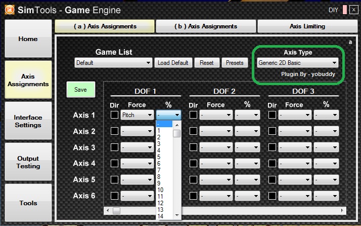

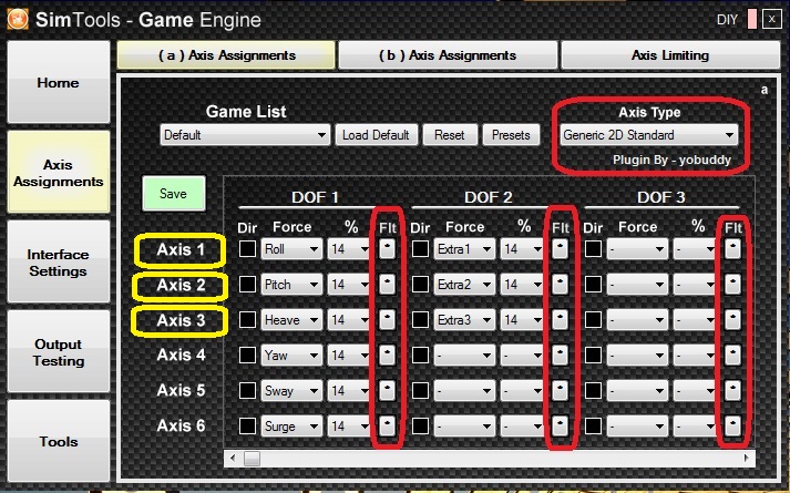

    I bought SimTools 2.0 Professional license, completely unistalled the 1.3 old version, installed the new version and started my 3DOF configuration for SCN actuators (that move when Game Engine start) but now... I have a great doubt.
    In the (a) Axis Assignments configuration, what type of Axis I must indicate?!?!
    Generic 2D Basic or Generic 2D Standard?
    Which is the difference between the two choices?
    ...and yet, with only 3 actuators I do not have also to configure the (b) Axis Assignments or do I have to do this?

    the basic are without any filters options ...
    the standard are having a filters buttons beside the force % ...
