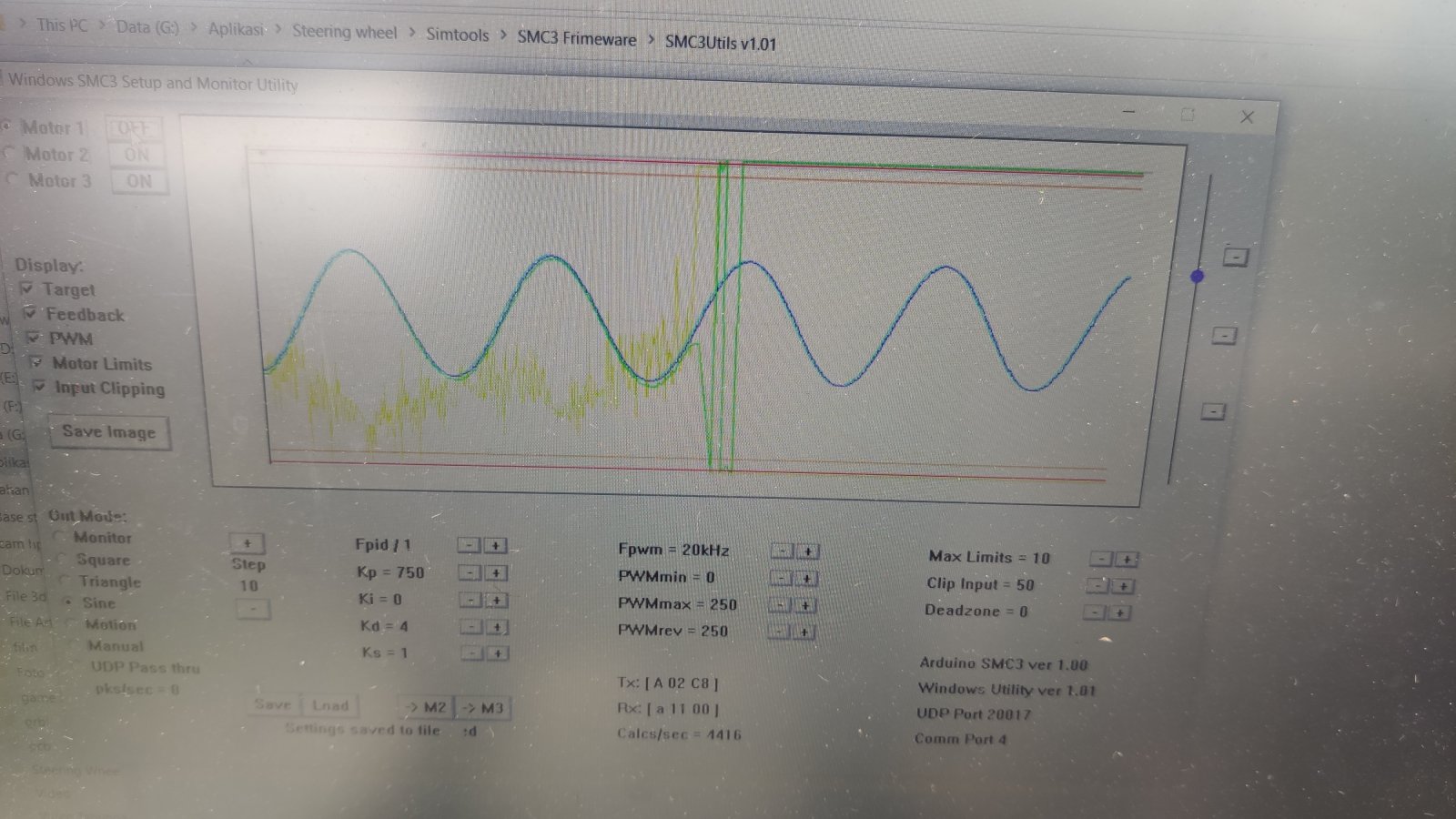

    Hi i set smc 3 like this.

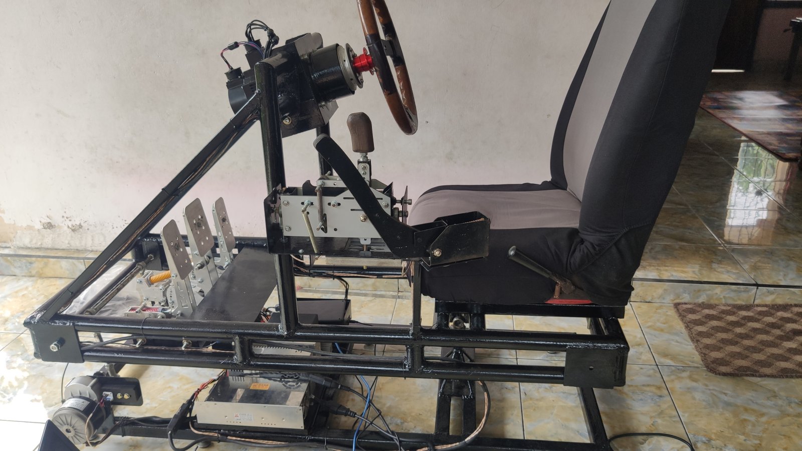

    And my set up like this.

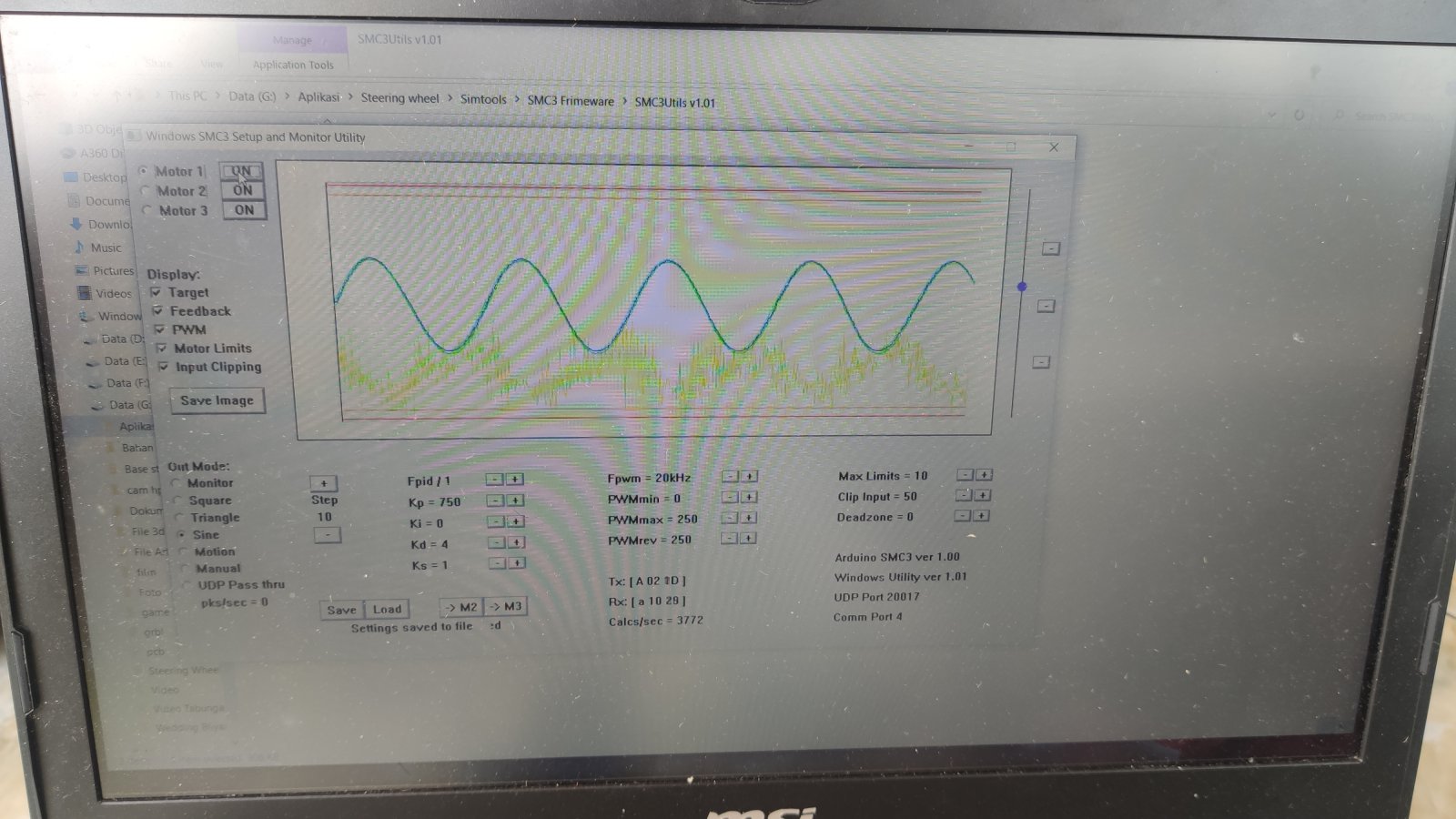

    And i run sine or everything on smc3 utility, but when i hold the motion the motor will off, like the motor not have full power.
    And smc 3 is like this.
    I used pararel of bts, and 24v 13A PSU.
    Mybe somebody can help me. Thank you
    21,009
    147,758Coins
    +10,872 / 54 / -2
    Kp seems to me a bit high, as does PWMmax and PWMrev, while Max Limits and Clip Input seem pretty low, with a bunch of other settings seemingly questionable, given those parameters.
    Much and all that I appreciate it is a pain, may I suggest starting from scratch, following the SMC3 setup steps exactly, so there is a known base for the likes of PWMmax (when movement starts), then members may be able to make further recommendations working from that known base:
    8. Set Kp to about 400
    10. Do the above for each motor

    I will try again sir,

    did you check your potentiometer? the green line is the feedback, and it doesnt look how it should look, try swapping the motor polarity.

    I think its correct the feedback going to targer, but i think because my motor is 300rpm, so too fast and low torque, for now i buy the gearbox for get rpm around 60 until 80rpm.
