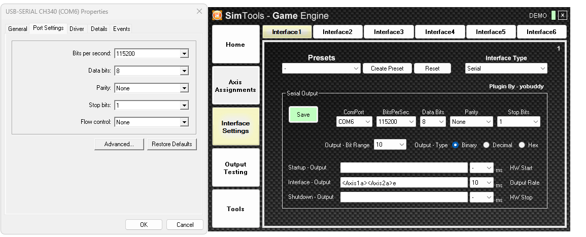

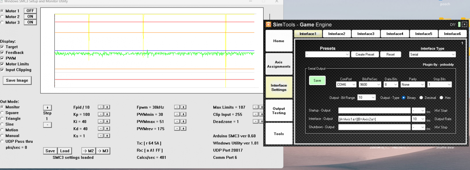

    I have my motors moving in SMC3
    But I cant get them to move in the output in the game engine.
    I was successful a few years ago with my first rig. But lost all the settings.
    Any help would be great.

    These are the recommended setting and axis format with no spaces:
    BitsPerSec - 500000
    Interface Output - [A<Axis1a>][B<Axis2a>]
