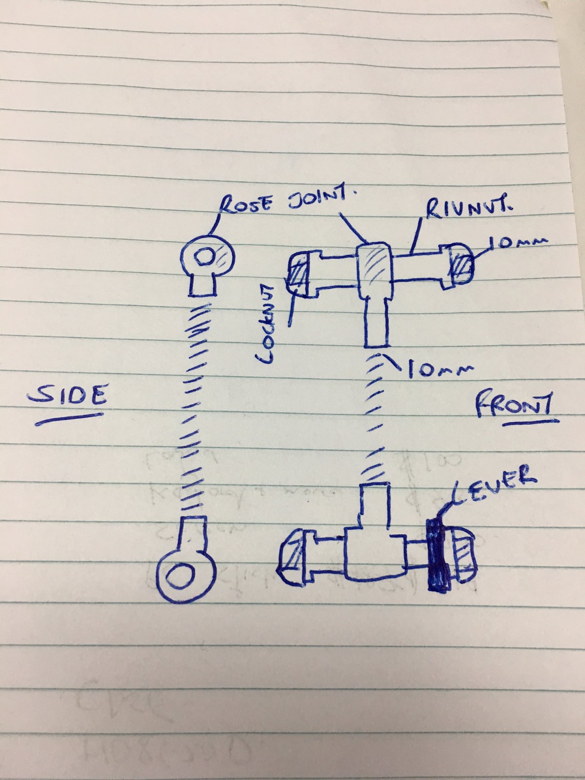

    my sticky point is how i'm going to connect this to the chair? i know i need some kind of linkage with a universal joint type bearing on each end but i'm having a problem finding anything on ebay or anyplace. maybe i'm using the wrong terminology. can anyone suggest a supplier, preferably in asia?

    @steveh2112 - Rose Joints are your friend.
    http://www.ebay.com.au/itm/M10-x1-2...468177?hash=item35fdfcc651:g:SR0AAOSwPcVVyWP3
    I used four of these, with M10 threaded rod from Bunnings, couple with some M10 Rivnuts to act as spacers to give me full movement.
    These are the Rivnuts I used:
    https://www.bunnings.com.au/kincrome-m10-10-piece-rivnut-set_p5910353
    Basically, put one on either side of the Rose Joint so the "slimmer" end is touching the bearing. Job done :)
    Failing any of that, type ROD END into Ebay for a whole world of possibilities / combinations :)
    The FAQ may help you as well.

    EDIT: Picture paints a thousand words.... Might make the setup clearer....

    great, thanks, that's what i wanted but didn't now the name, i was searching pushrod end

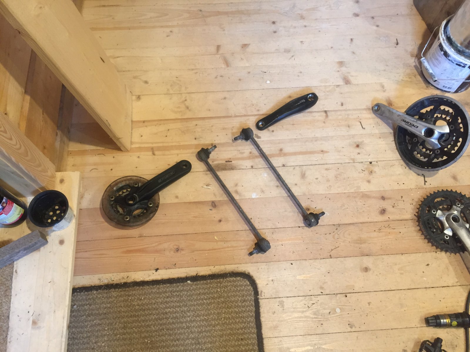

    Hey steve
    I got 2 stabilizer rods from a car from a local car garage. No variable length but 0€ IMG_5090.JPG
