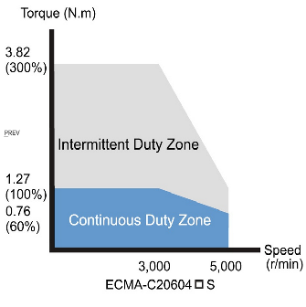

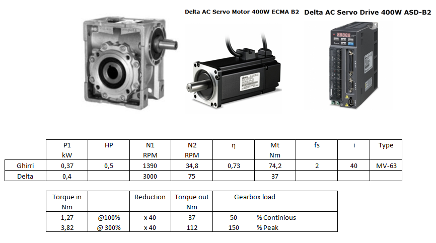

    I have been following various threads within this forum and still designing my first 2 DOF race simulator and if this is a success move to up-grade to 3 or even 6 DOF. That is why I want to experiment with these types of actuators to, if successful, just assemble a few more.
    Still struggling a bit with the actuators; 12Vdc PMDC's looks OK and are relatively easy to control; VFD's with a standard E-motor is a bit bulky and then I thought maybe a servo motor would do the trick, being small. I have looked at various options from 75Vdc up to this 230Vac example. What I like about this is that it does not hold as much current, so the wiring is relatively thin, but has some torque for its size. I need to pay attention with the voltage (230Vac) and the harmonic distortion using VFD's but that is just proper installation, which I am not uncommon with my industrial background.
    So I am wondering if this would work:
    Due to the variable load that goes through the worm gear it might give trouble, however I have seen enough nice designs that operate well with a window wiper set-up, winches or golf cart internals.
    My thoughts are to built a durable servo actuator with some grunt that I can feed from a mains outlet (20A).
    Does anybody have some points to share about this set-up?

    that is a very expensive setup! i saw a few VFD ideas on the forum but i cant see how this would be useful. you will need fast accelerations and declarations if you want a race seat style sim. but if you build a flight sim this could work. i don't know i'm suck with the design of actuators myself. still searching for ideas :)

    @tadythefish Why would it not be fast enough? The Ghirri info was given at 1390 but the servo can punch it to 3000 given it a secondary output of 75 RPM. I have deliberately chosen the strongest quality on a fs=2. With the grunt of 37Nm on a meter thus up the scale by a factor of 10 on a 100mm long arm. Let's do 75/60= 1,25 RPS generates a 400mm/sec (approx.) travel. That would be a respectable grunt for a race simulator if not mistaken. With in this calculation I already have incorporated the 0,78 efficiency and am made aware that the temperature will cause the oil to heat up causing some deviations in the positioning but if the temperatures over the gearboxes are some what equal it will hopefully balance out nicely.
    Concerning the cost I think it requires some patience to purchase something that will be industrial quality, durable and reliable. first testing with one to make it all work then I would like to step up, from starting with a 2 dof, in stages to a 6 dof. If it works this will be almost indestructible :D

    that is something that needs to be tested in rel life :) i don't have a lot of experience with AC drives. I did wire up and made them work but i never tested how fast can they change the direction of rotation. You would need to setup the drives for really fast acceleration and deceleration :) if you can make it work you can have a really powerful rig :)
