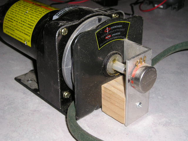

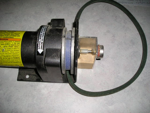

    I actually moded a winch motor a very long time ago that I still use for various projects today. :hi:
    Its pretty easy, just remove the cable wheel and cut the sides off of it.
    Insert a hole cut out out of HDPE ½” as a spacer and bolt it together.
    Then you put it back together with a belt and drill new holes for the base (see pic)
    You can even attach the pot right in the end on the winch motor if you get a little tricky. :thbup:

    I removed the clutch plates from mine, and switched the clutch gear for the output gear, which fits the shaft directly, but needs a spacer to replace the thickness of the clutch plate.
