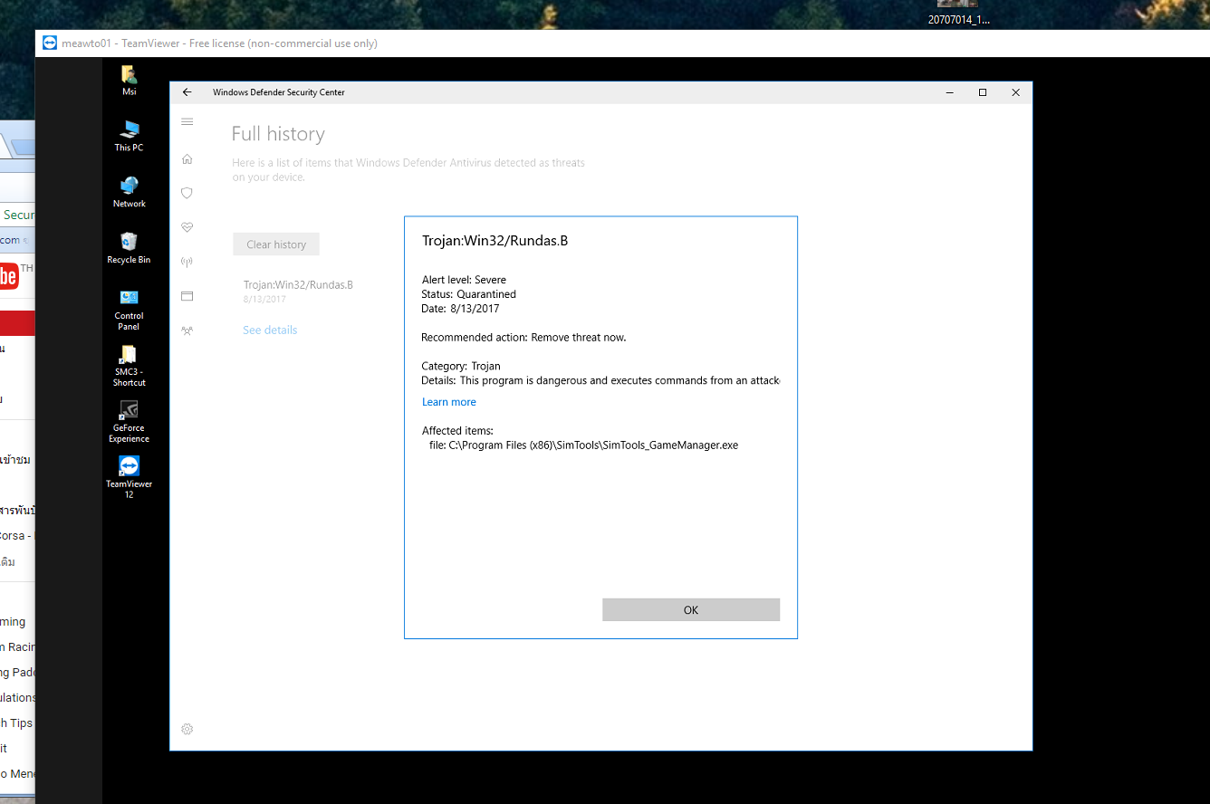

    today my PC and my client has problem with Game Manager has disappear. :confused:
    I have to remote to my customer PC and reinstall simtools again. but it's still has a same problem
    and now i have to turn off window defender to solve this problem.
    what happen ? :sos

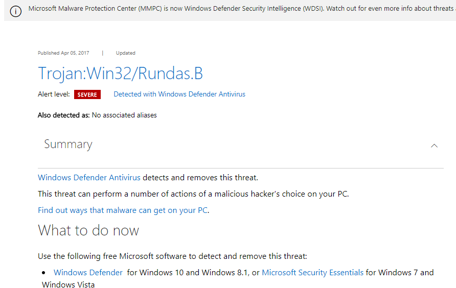

    Game Manager has the abilities to scan a games memory space so we can get the telemetry from games that don't supply any.
    He may have played a few different plugins that use memory hooking and it detected it is all.
    To fix this problem, just add it to the exceptions list for windows defender.
    https://support.microsoft.com/en-us...dd-an-exclusion-to-windows-defender-antivirus
    Let me know how it goes buddy,

    i'm add exceptions in windows defender and now i can play its :)
    but i have to do for all customer hahaha

    Or simply install avg free or avast, and be done with the problem.
    I service a lot of PC that use Windows Defender, never a good sign.
    Once v2.2 drops, if there are still (false positive) problems, I'll look into submitting v2.2 to each of them for review.
    I really think its just the beginning of the new "Adaptive learning" technology all the antivirus companies are pushing as the next big thing.
    I'm sure "Adaptive learning" technology will get better over time, but we will see it its fast enough for us. lol
