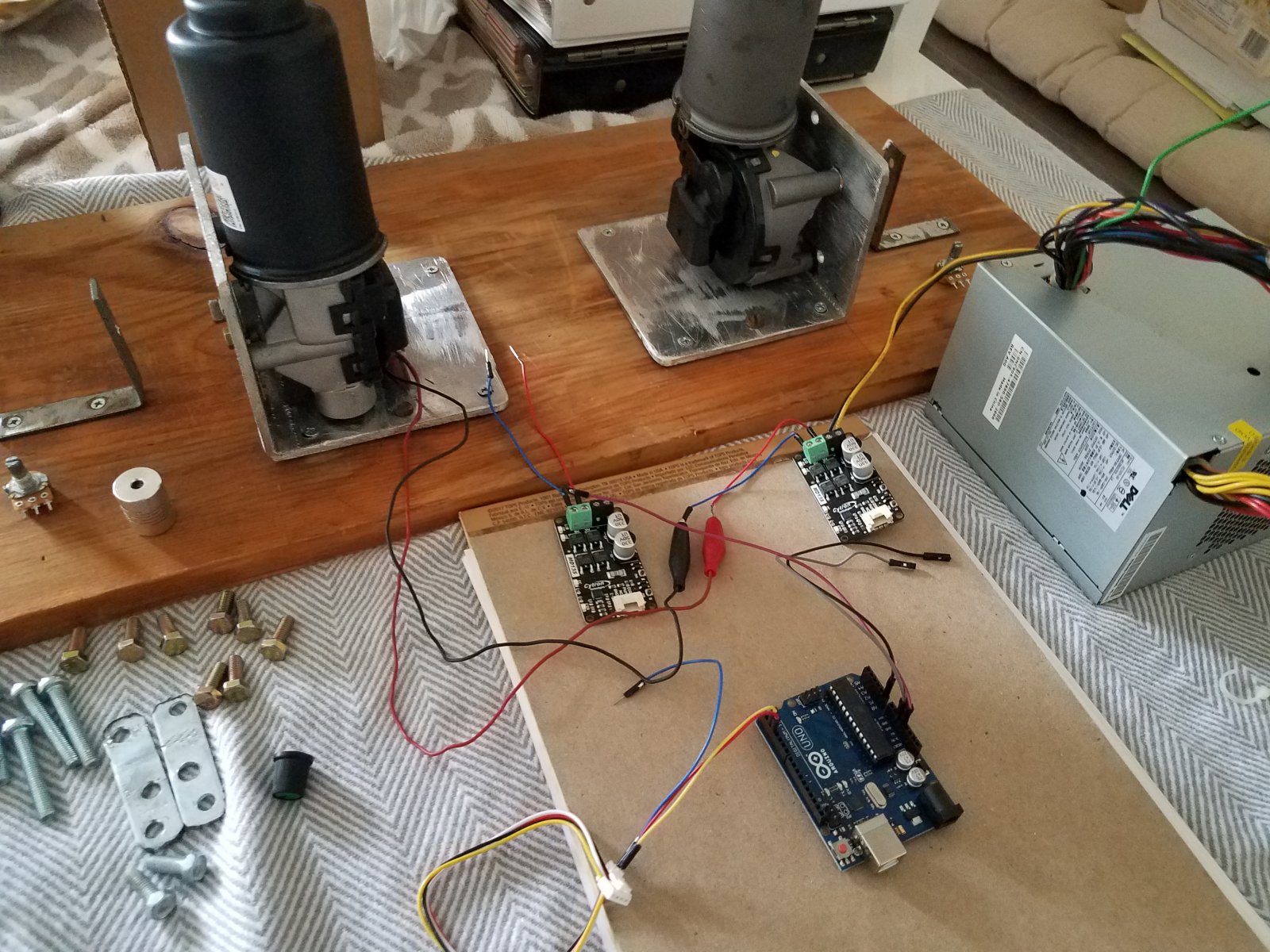

    Hey @Robbie Teengs , @Mike5050
    today I got my MD30, I've got a problem maybe you can help me solve it
    I wired it accordingly to the pdf by Robbie and as Mike did
    When I turn the PSU on, the ground cable from the Arduino to the Cytron overheats and melts.
    I checked the wirings many times, tried with both controllers and even without motors connected as soon as I give power I got the problem.
    With the jumpers set for int pwr and int pot the motor works fine,I an control it with the pts and buttons on the controller itself, and the kill switches work fine too
    Do you use a specific SMC3 version? (I don't think that's the problem though)
    Do yours have jumpers too?
    the white ground cable is the one that mets down (I tried connecting it to the other grounds on the Arduino with the same result)

  20. Robbie Teengs
    Robbie Teengs RobbieT
    Feb 11, 2016
    30
    Director
    South Africa
    372Coins
    +11 / 0 / -0
    Hi Blame,
    I am not at all informed regarding the MD30 and therefore will not be able to give you any advise. One thing that does concern me regarding your info and pics is that you have the pots not running attached to the motors. When I was setting up my system I also had overruns and all was OK after I connected the pots to the motors.
    The normal SMC3 was used with no problems.
    Sorry that I cannot assist you with your problem.
