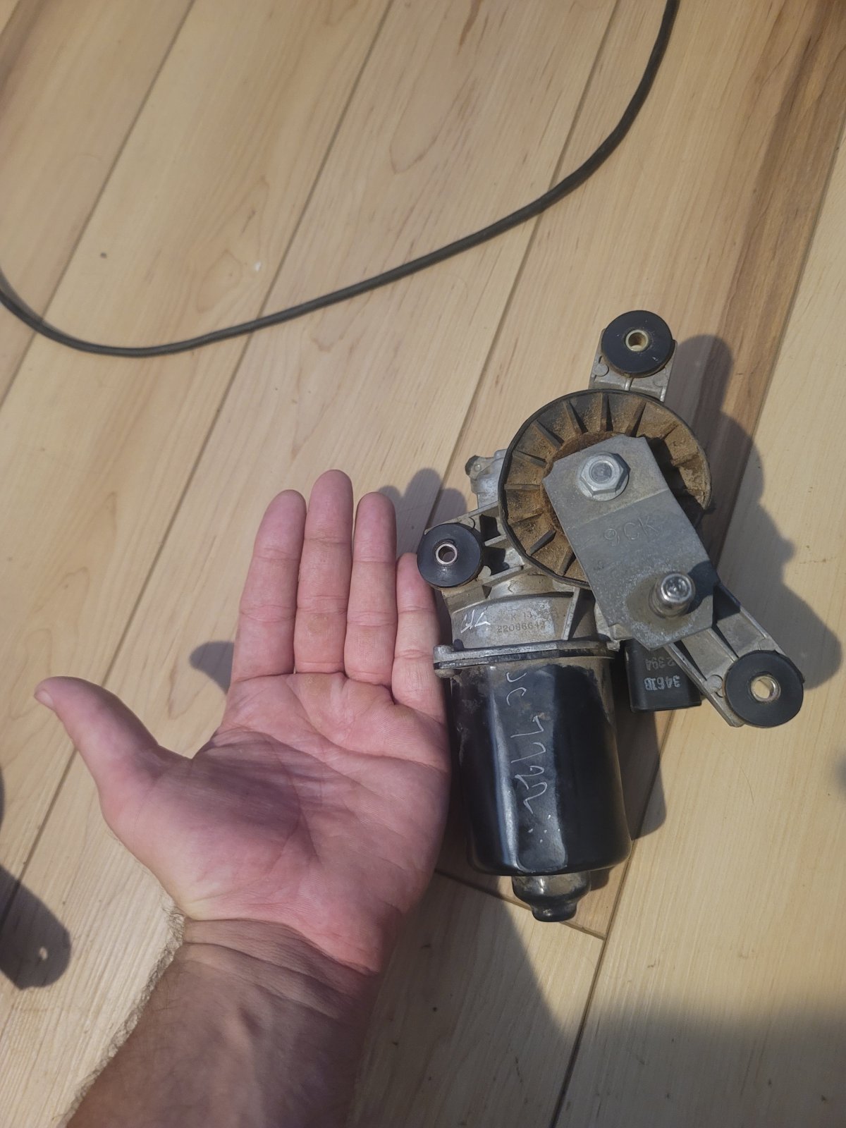

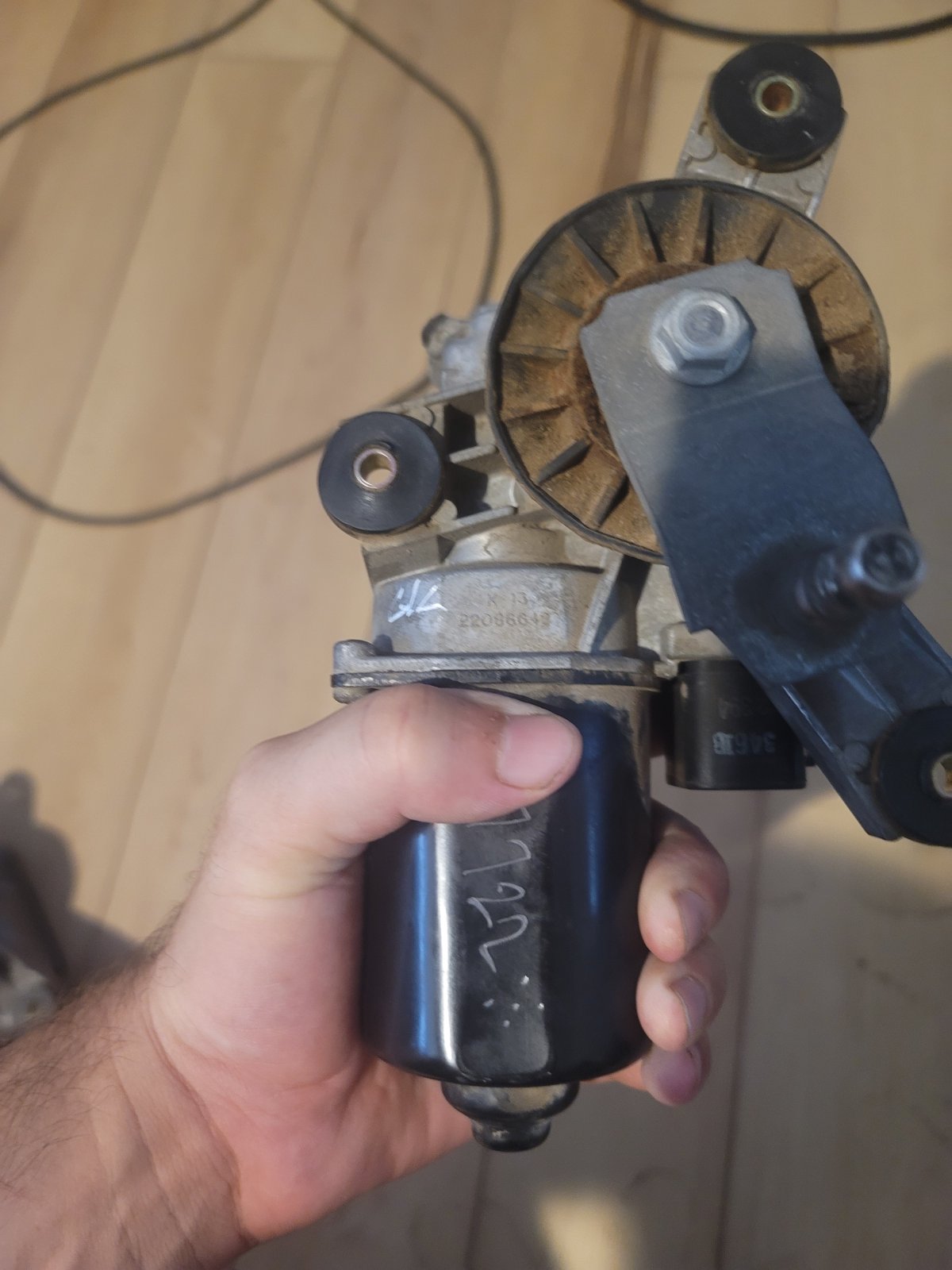

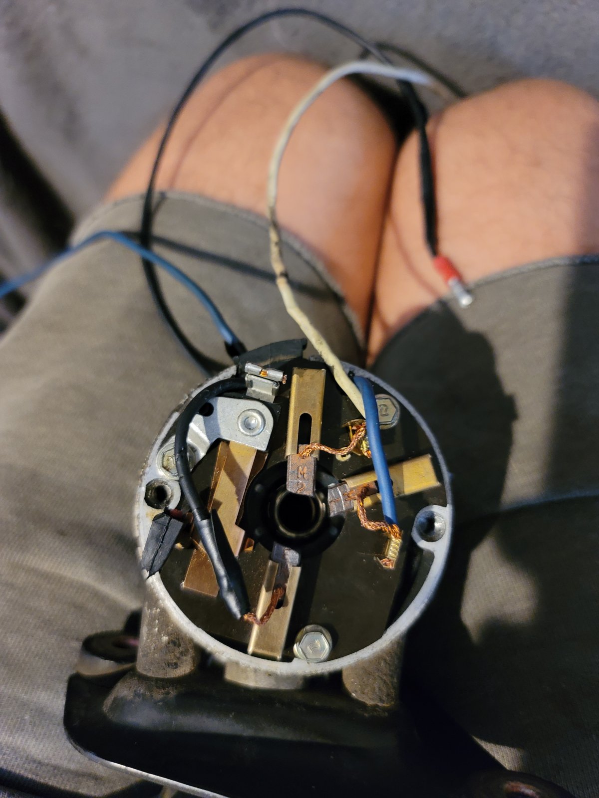

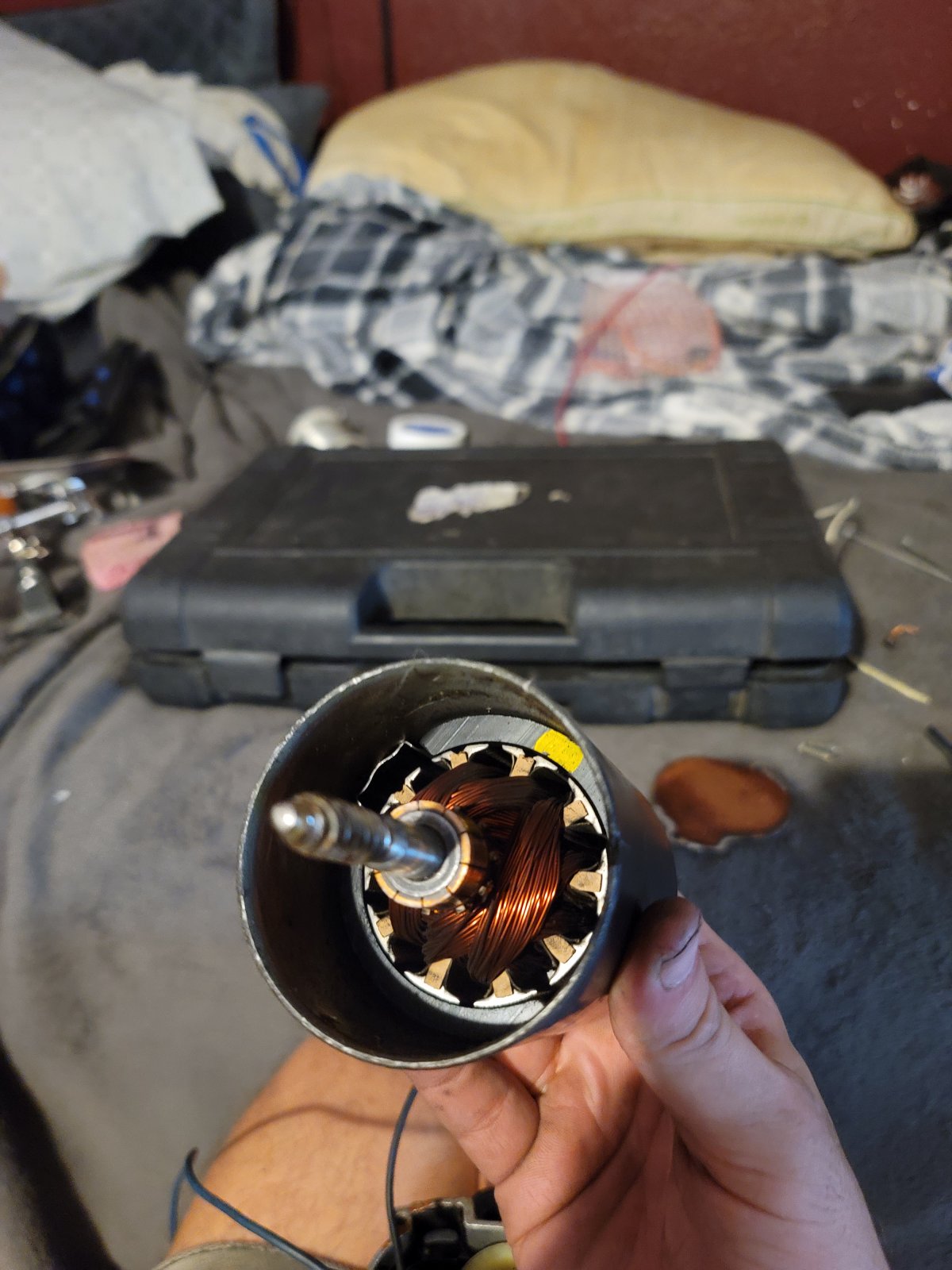

    Hello, my name is Adam. I have been lurking on this website for quite some time now and I finally decided I NEEDED to have a motion sim. 8 months ago I built a wooden 2 dof full frame motion simulator with wiper motors from 90s ford trucks (pick and pull) 2 random tie rods (same junk yard) and a steering shaft u joint. This later evolved into a u joint/driveshaft from a Toyota pickup and 2 motors from a mobility scooter along with an upper frame redesign. Here is my journey... sorry I didn't take very many pictures
    My first job was to ground isolate the wiper motors and it was one of the most difficult. These motors have a shaft that runs all the way through the motor housing but is connected to the "cap" along with the magnets. All this boils down to the fact that brushes don't come out with the cap but the shaft does so the brushes shoot out of their housings (spring loaded) when you disassemble the motor. After removing the ground to case I had to figure out how to get the motors back together. I ended up using sowing thread, tied around the wire connected to the brush, to compress the springs and keep the brushes held back so I could reinsert the shaft/cap combo. After it was inserted I cut the thread to release the brushes back onto the shaft. I also removed the slow speed brush from the motors.

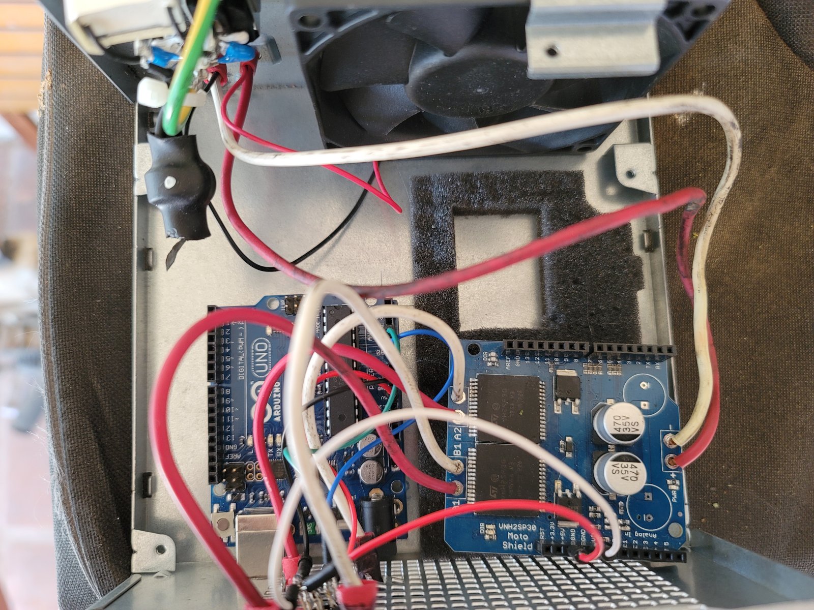

    Next I wired the electronics, an Arduino and a Monster Moto that I purchased some years back on a false start attempt at building a motion sim, but the MM failed immediately. The motors twitched once in SMC3 but never actually ran. I bought some IBT-2s and a couple new Arduinos ( I burnt the original one because I didn't isolate it from my metal case I housed the electronics in...) and wired them up in an old dell power supply case I gutted. I works!! The motors turn!
    It took me an embarrassing amount of time to under stand that the potentiometers will stop the motors from spinning if you actually connect them to the shaft. I couldn't understand why I couldn't stop the motors when I tried to put it level with the center line in SMC3 but it was supposed to?!? That's when I learned about the preciseness of a hall effect potentiometer. So once I hooked those up to the motors using a ton of hot glue and rubber tubing and oriented the motors correctly I was all set to build the frame.
