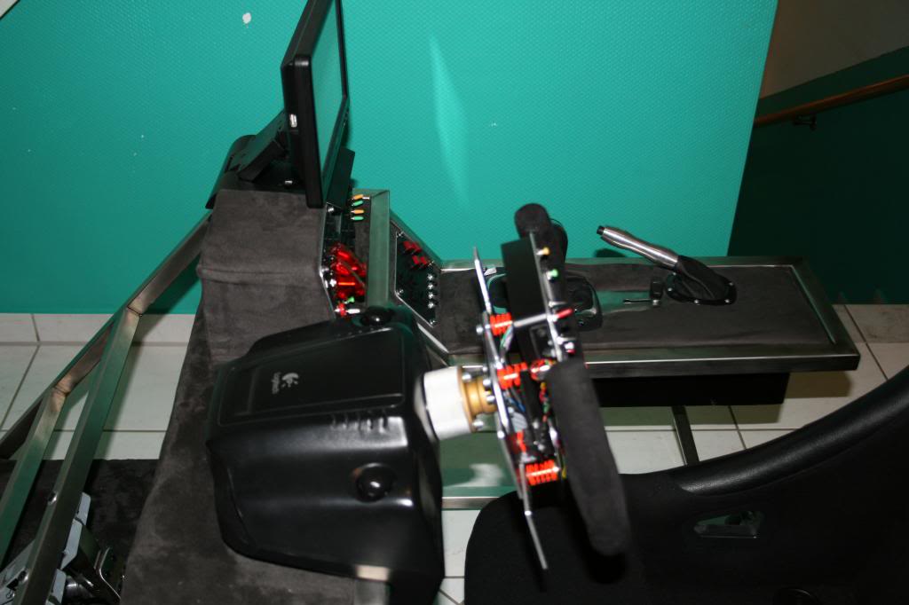

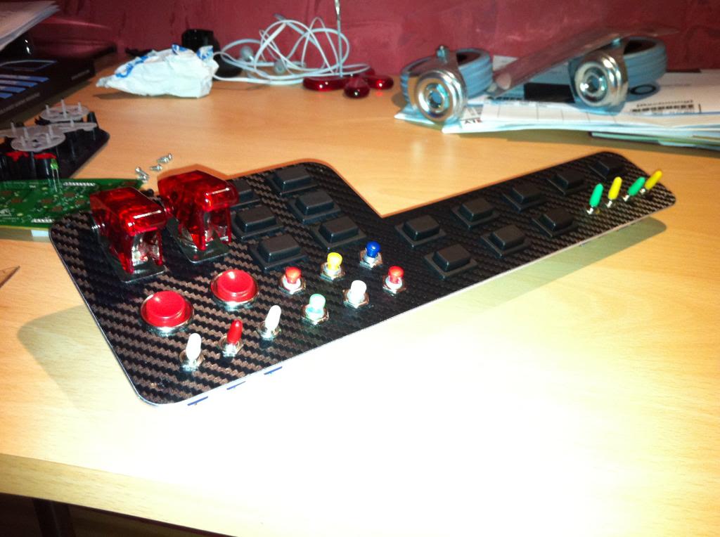

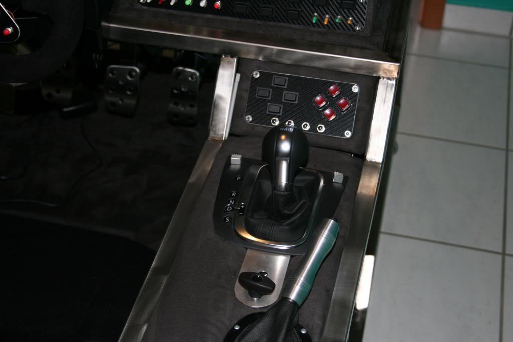

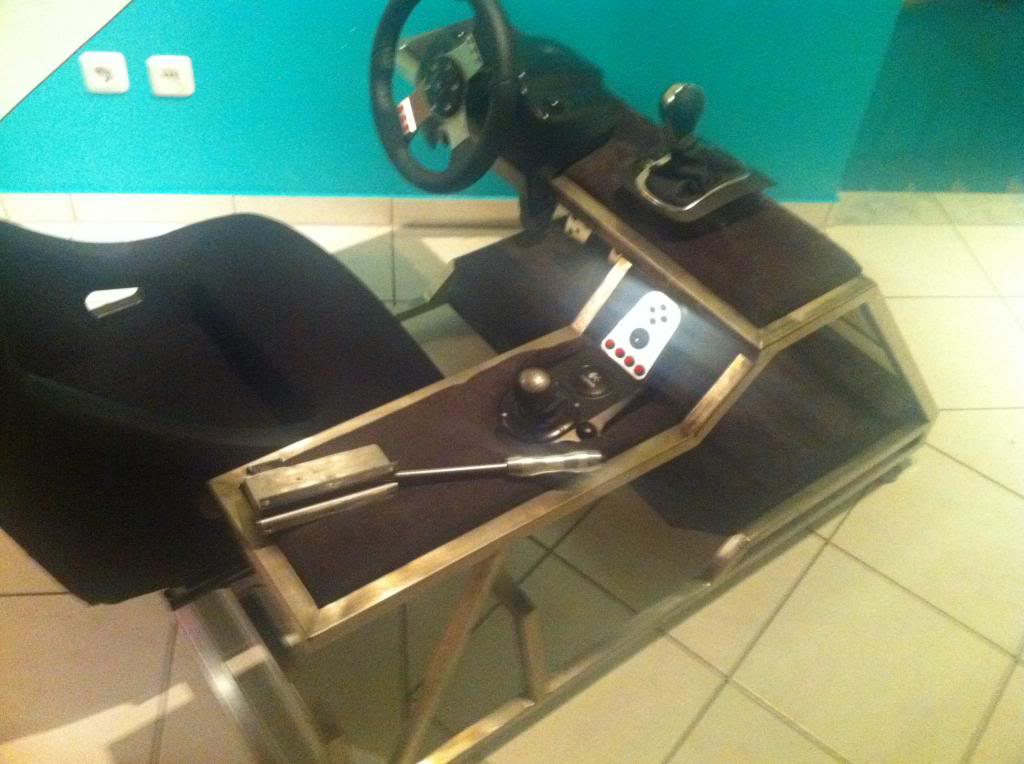

    Hi guys,

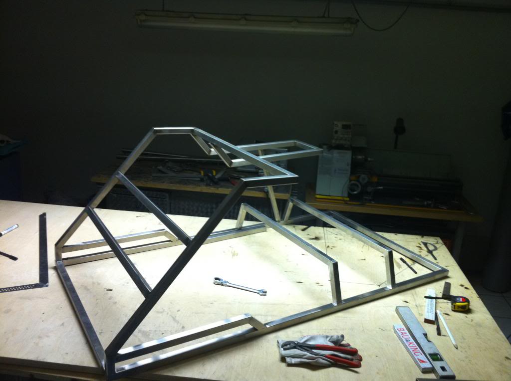

    its time to show you my Rig. I decide to do this before i will to disassemble the whole rig, to build a new one. Actually i have to say, this status was v2.0. It begin with a normal static rig and ends with the first test and impressions of a 2DOF Motion Rig.

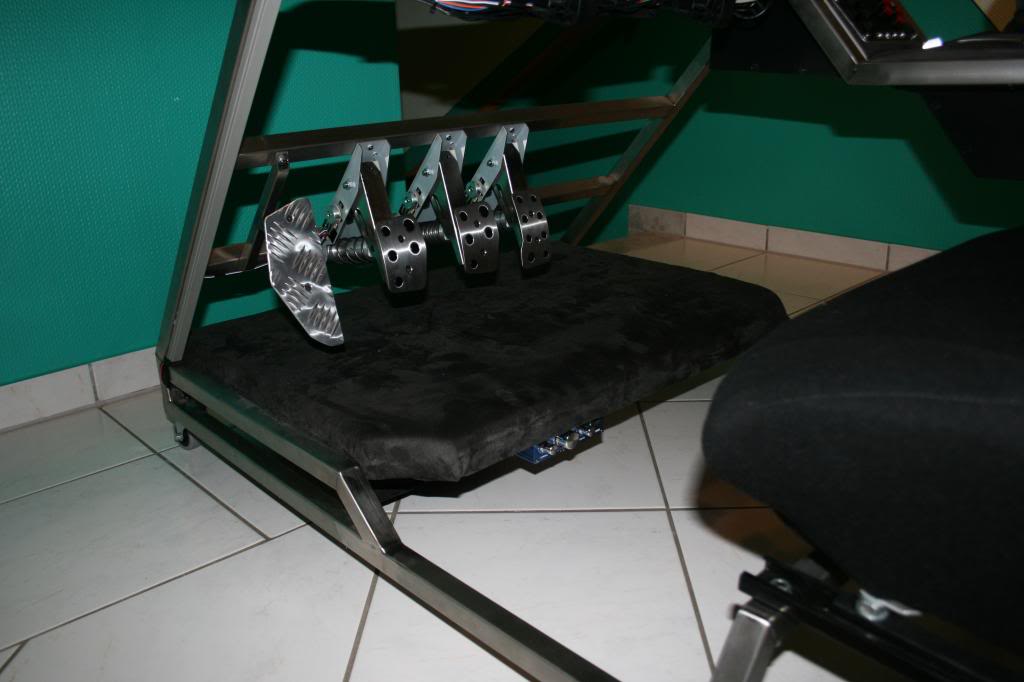

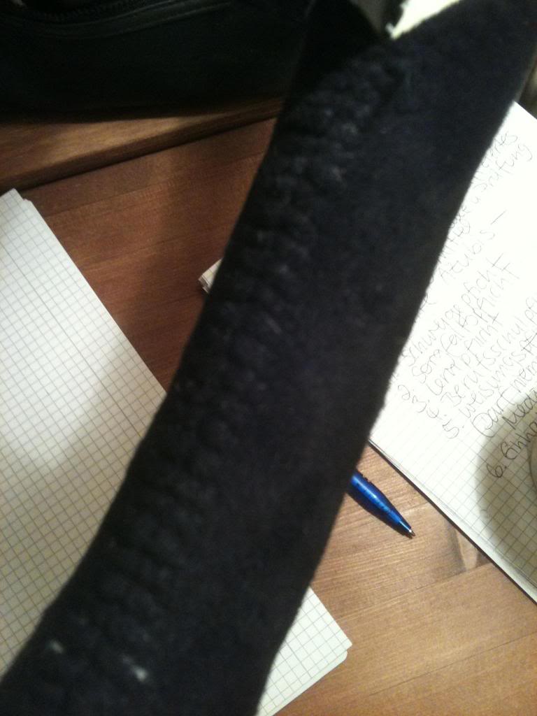

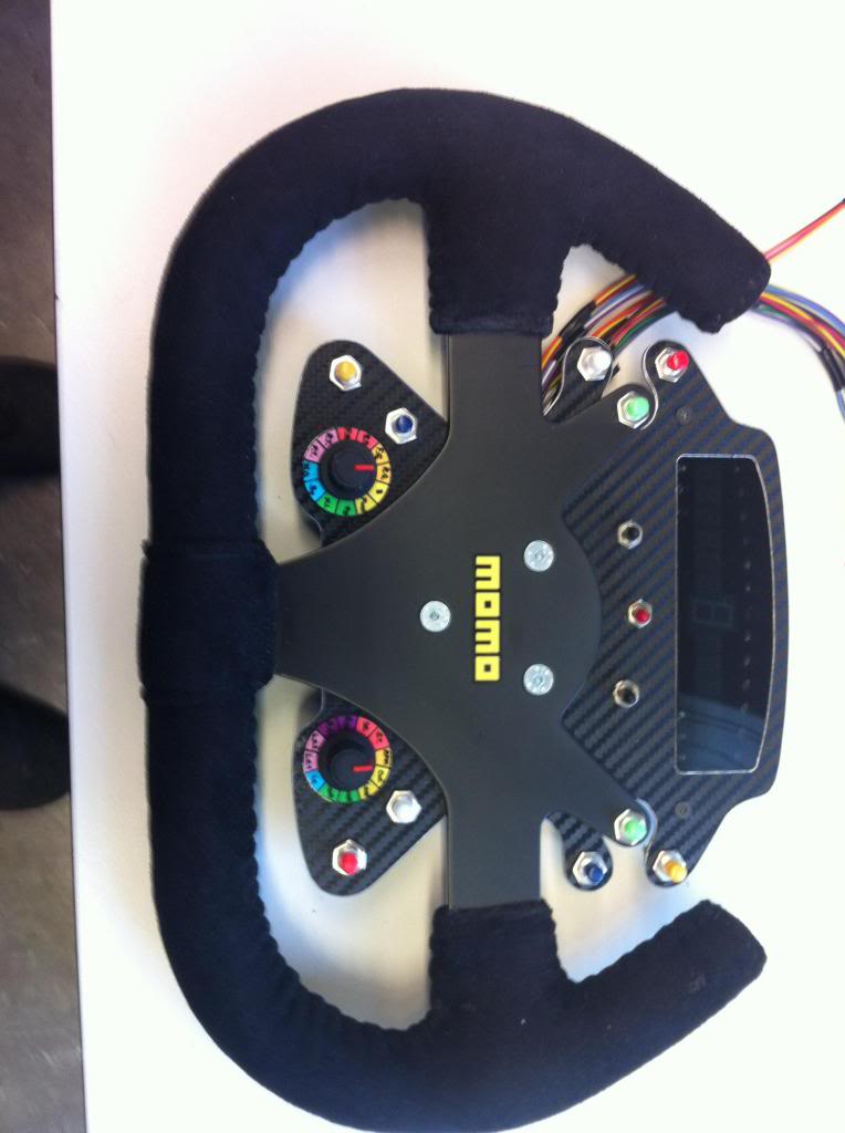

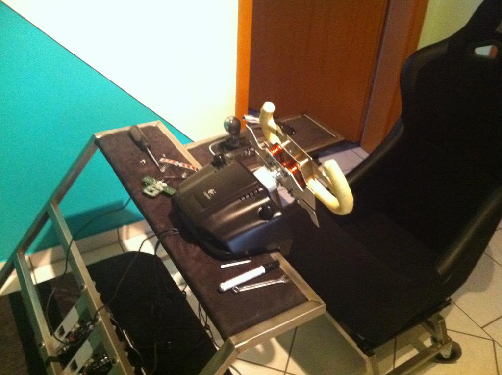

    I also modified my G27 with an formula Momo Wheel and insert a SLI Pro Dash display by LEO Bodnar. Furthermore a brake mod with a metallic cylinder was integrated for stronger brake mode.
    I have shown my rig on many other forums, and the people find the design useful for their own plans, so i think it would be good to show you guys here the old picture, before to build a new one. All of the modifications i done, was all handmade by myself, also the momo wheel too.
    The main point a decide to rebuild the rig is, to have a the screens for ever at the rig for a better FOV. The second point, i would have the trationloss upgrade. Moreover i decide to upgrade the motors and change the interfaces to pololus jrk's for better and faster movement! For more informations, see my topic in the motors and controllers section.
    Ok enough of the texts... i think pictures tell us more than 1000 words...

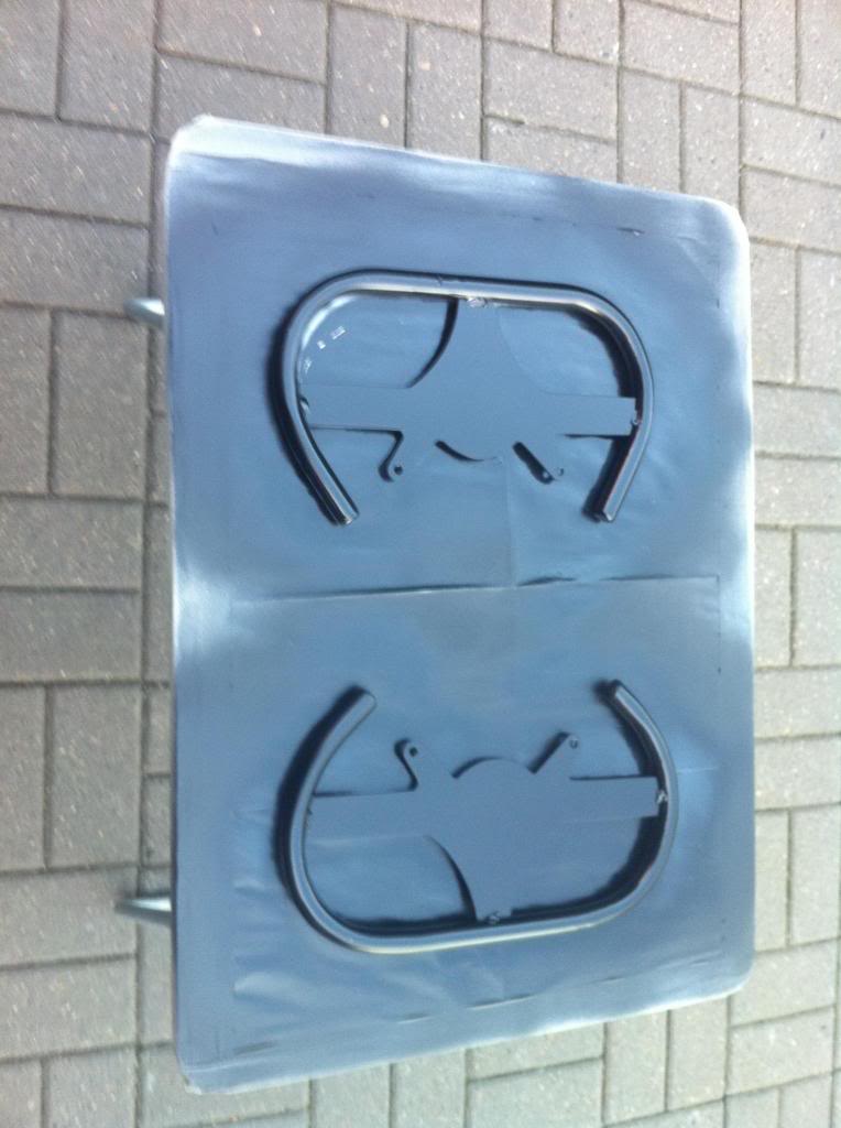

    How it begans...

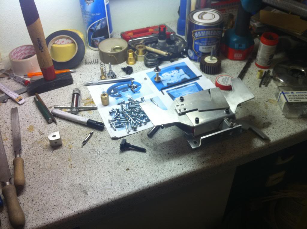

    let the modifcation begins:

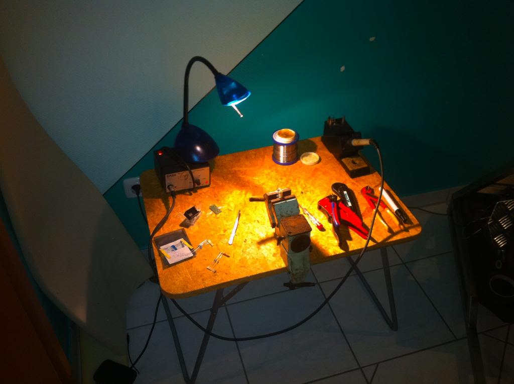

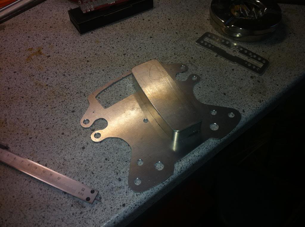

    my workplace for that time... theretime i was living by my parents...

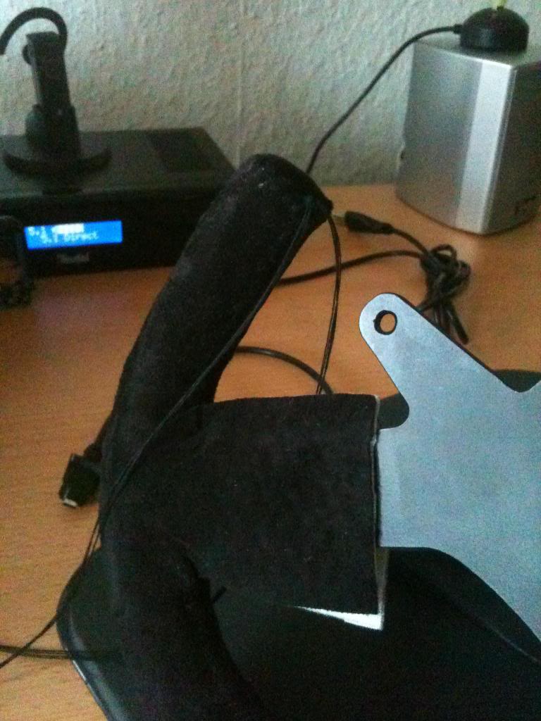

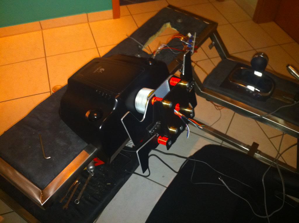

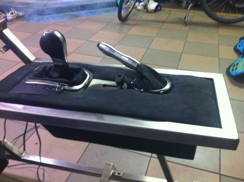

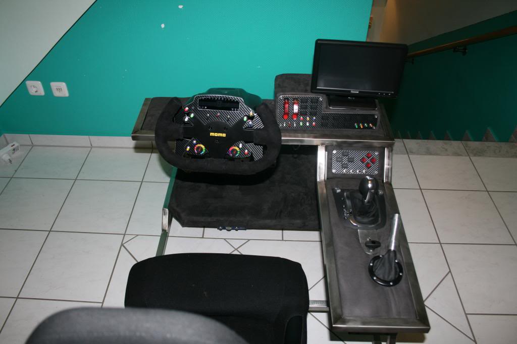

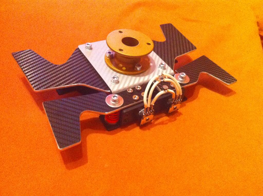

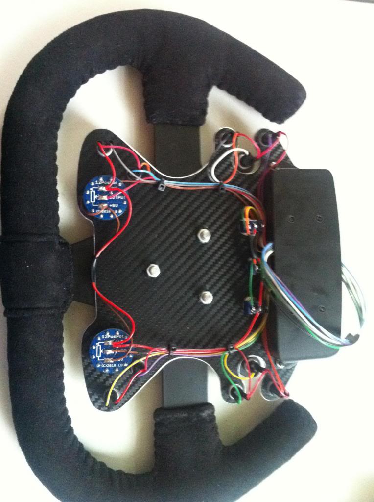

    Know came the wheel plate with the SLI Pro mount:

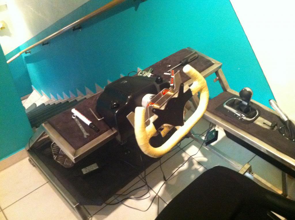

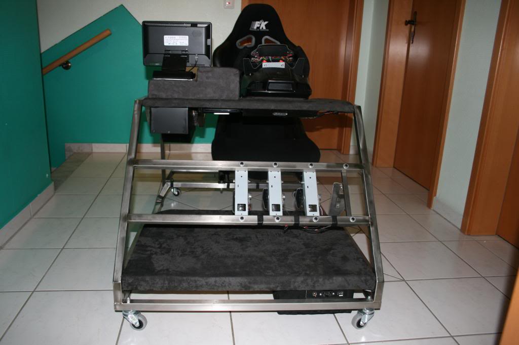

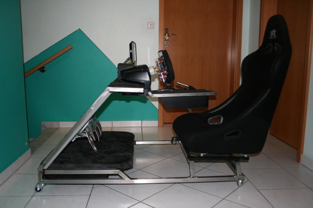

    Now came the final shots of the Stage 1 process, that was in the year 2013...

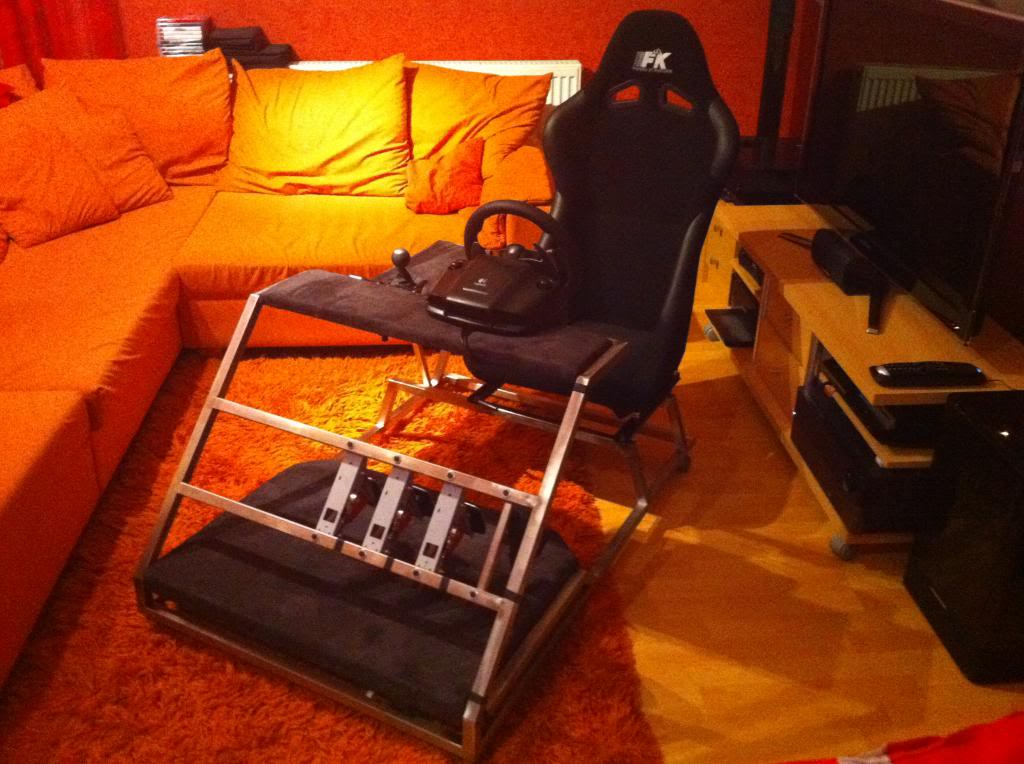

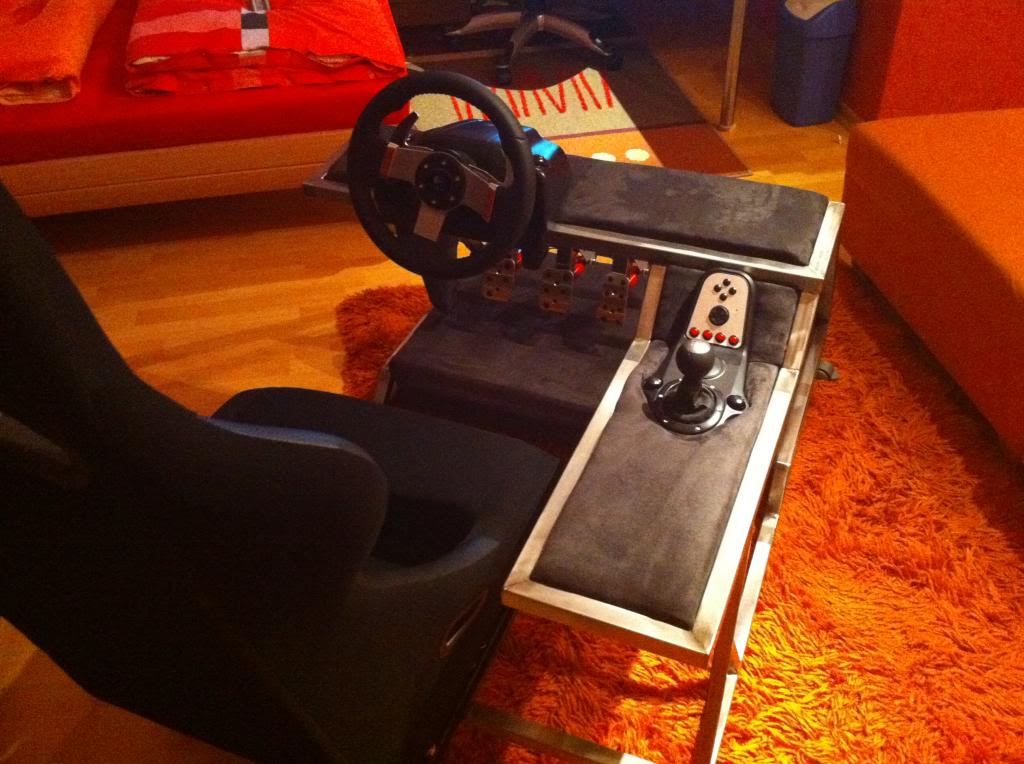

    Theretimes i was my little baby that i pulled every time in front of my 46" TV for racing...
    After i found the motion section in diffentent forums like these ones, i decide to upgrade my baby
    with wiper motion for the first movements in form of a 2DOF system.

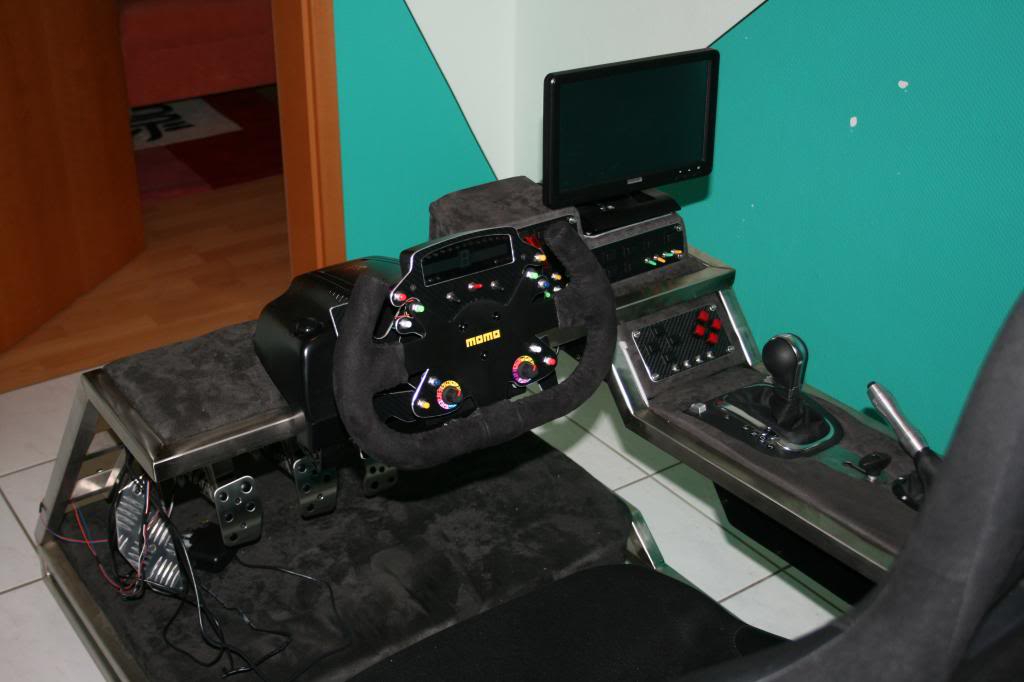

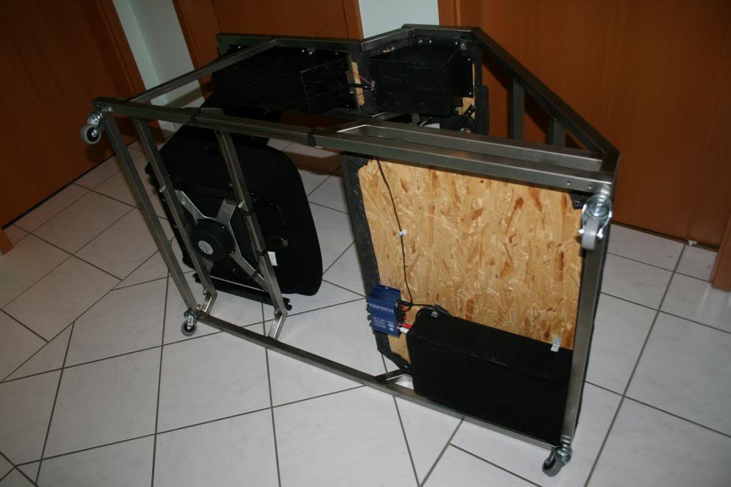

    And now some picture of the last modification and motion update till last month. Actually the rig
    is not exist like at the picture, it is only the frame and the seat here. The motors and the Motion
    Control Box i will store for a mini motion seat for my little brother or i will sell them... i don't know...
    If someone is interested in their please contact me...
    Yes that is it, that was my rig since 2012 till last month. Hope you guys enjoy it and leave some comment

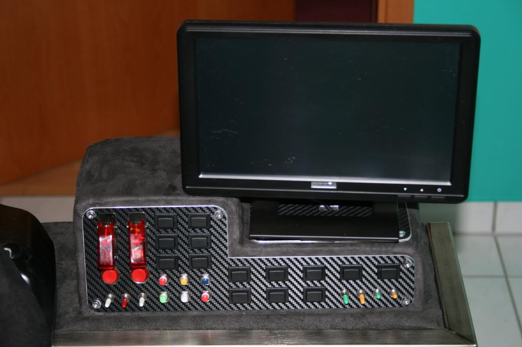

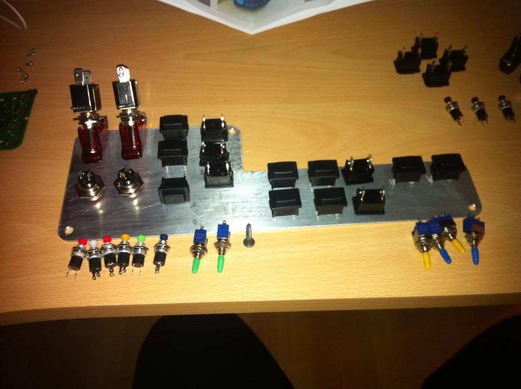

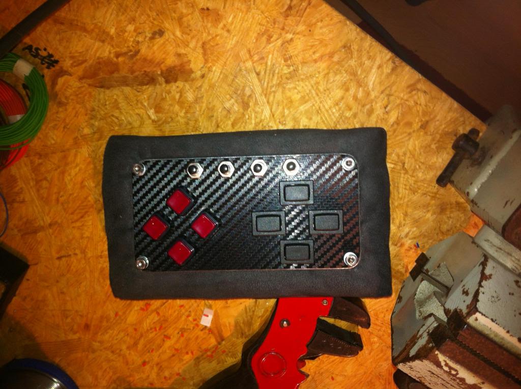

    You have done a great job on the peripherals and dash. Out of curiosity what do you map the various switches to and in what games?
  4. WowaDriver
    WowaDriver Waldemar Jost
    Mar 4, 2014
    59
    Bachelor of Science and Engineering
    Hannover
    1,127Coins
    +42 / 0 / -0
    Games i play are iRacing, AC and pCars. The switches you mean the 3 under the dash on the wheel right? The red one is only a hardware unblocking for the green push buttons. At that time i played with my mate a lot nfs shift and there you have the option to use NOS like in Fast'n'Furious ... see it like a child dream :D... The black ones at the wheel i did understand the possiblity of the leo sli pro dash wrong... thought it can handle switches like that... and the green and yellow ones at the button box are unblocker and blocker for the 2 pots of the g27 shifter... if i block the pot the h-shifter doesn't work and i unblock the 2 buttons i inserted there to have an sq. shifter. They only block and unblock the GND... For the sq. shifter you can see at the pictures the mechanism
