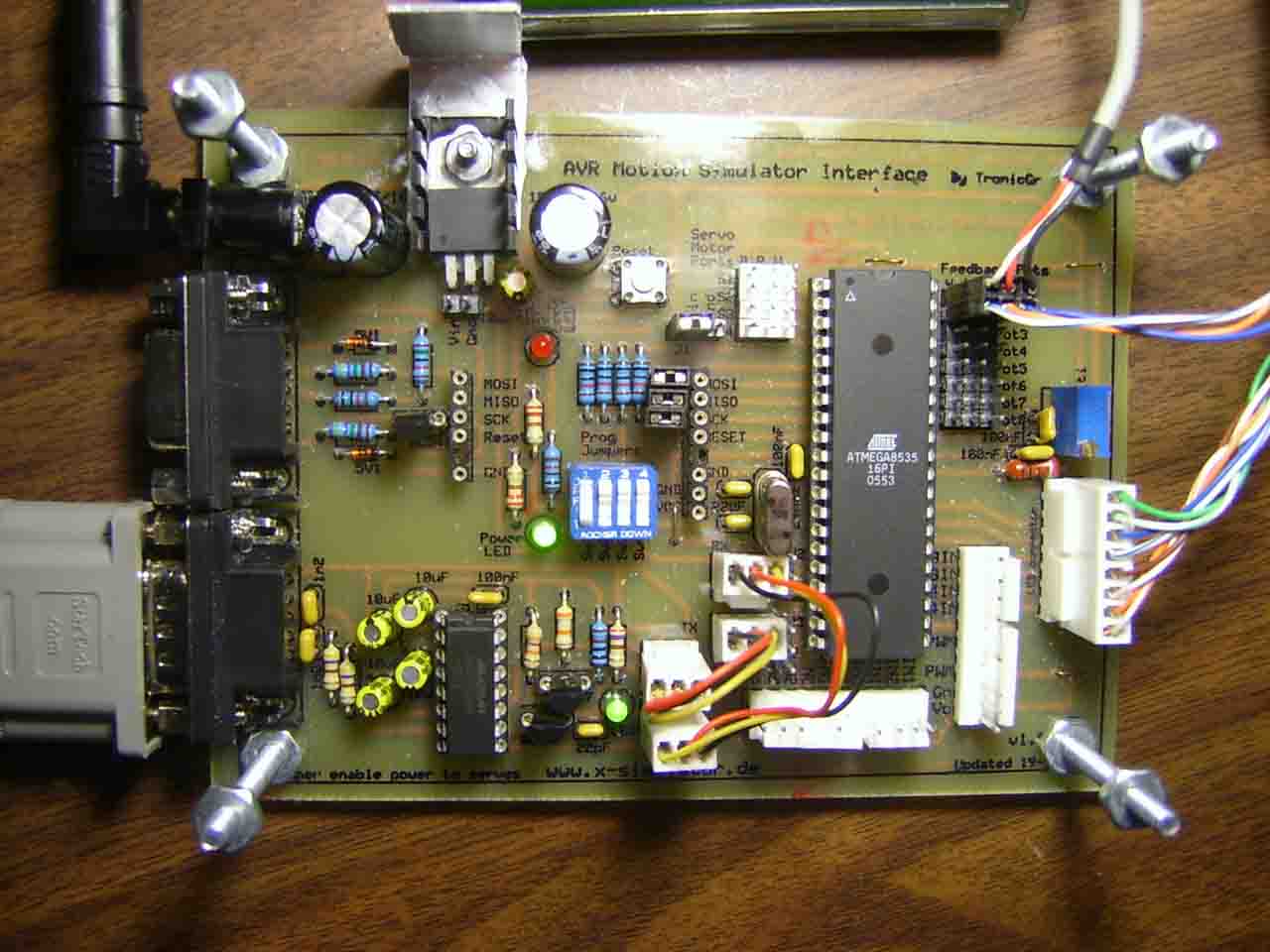

    Hello. I am a complete newbie at this sort of stuff with a little knowledge in circuit components etc. I have just finished the AMC1.5 and HBridge boards. Everything seems to be working perfectly. However, I have been following Tronic's video guides and noticed he was using version 1.8 of the Profiler. This seems to be completely different from the 2.1 thus I am at a loss as to what to do next e.g. cable connections, profiles etc. I have searched the forums for any updated instructions for the latest version but have come up empty. I am REALLY excited about moving on to the building of the frame work but am afraid to do so if I can't get the motors working. Can anyone help. I feel like a 5 year old asking questions to college proffessors here so please forgive my ignorance. Thanks for any help you can provide!!!!

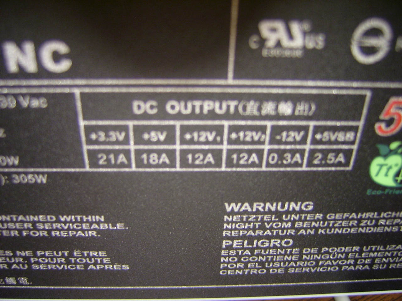

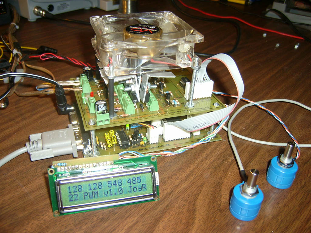

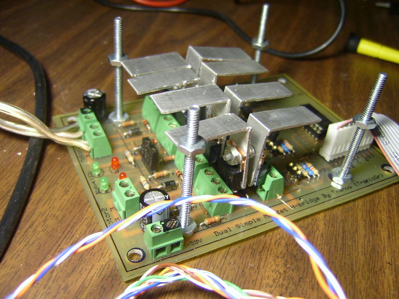

    Update. Went for a test run and this is what I got. Upon reaching around 400 on the LCD the motor attempted to turn but just clicked as though it didn't have enough power and the Green LED barely came on and sort of flickered until I went beyond the 400 reading and then the motor stopped. When I went back to the 400 reading the same thing occured. No reverse action. Any ideas anyone...ANYONE? I have posted some photos regarding the power supply I'm using to the DSMhb. DSMhb PS Output_sm.jpg
  6. tronicgr

    Hmm, on the 3rd photo that shows the DSMhb, it seems that two of cooling stripe pieces are touching to each other... they should not touch at any case!!! This will cause short-circuit, and probably kill the mosfets...
    Did you tried the other h-bridge?
    I have never had to use computer PSU on my DSMhb so I don't know how the computer PSU reacts on way that h-bridge returns to the source some of the power!!!! Some PSU have load sensing circuits to prevent that!!!
    The only PSU unit I ever used was an 24V /400W one from surveillance cameras (Switching Power Supply)

    Thank you VERY MUCH for the quick response. I am getting very anxious to see it in action. As for the MOSFETS I do know the screw heads are indeed touching. I will fix that today. As for the PSU I think I had read in an earlier post that you were using these but then switched to the car battery for their capability to handle higher loads. The wife isn't to happy about the car battery in fear that it may leak acid. Couldn't convincer otherwise. So now I am looking for othe alternatives. Any suggestions? In the mean time I will do some more research on this topic. Thanks again!!!
  8. tronicgr
    tronicgr
    The cooling stripes should not touch those that are next to them no the one that is in the same row. I use a single screw to hold both cooling stripes in the same row. They sit on the same potential and they don't short-circuit...

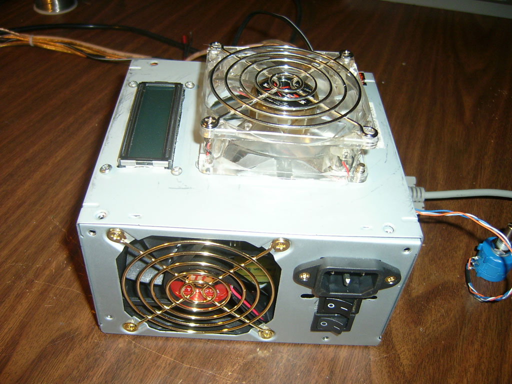

    I'm SO excited. Just received my parts to finish the DSMhb. Got everthing up and running and all looks good at this point. Thanks again to Thanos for the boost of confidence.
    So now, I was wondering if anyone had a profile setup for FSX to use with Force Profiler. I'm assuming this is to be my next step (Connecting it all to the software). I did find one that Chris did but was designed for the SCN5. Could I still use it if I were using the wiper motor setup? When I loaded it in Force Profiler I received an Interface was not found. I'm not exactly sure what the exact steps are I would take to use when configuring Force Sender and Force Profiler.
    One other note; I only have one computer; AMD64 2.7Ghz dual-core with 8GB of ram running Windows XP with SP3. (Used to run Vista 64Bit but had problems) Would I still need to get another computer or is it possible to use only this one. I understand it to be better to run the Profiler software on one and the game on the other but my funds are limited when it concerns purchasing another PC. I also understand that XP only recognizes 4GB of ram.

    Nice Work and Great lateral thinking Love the idea of the Old PSU case :) great stuff
