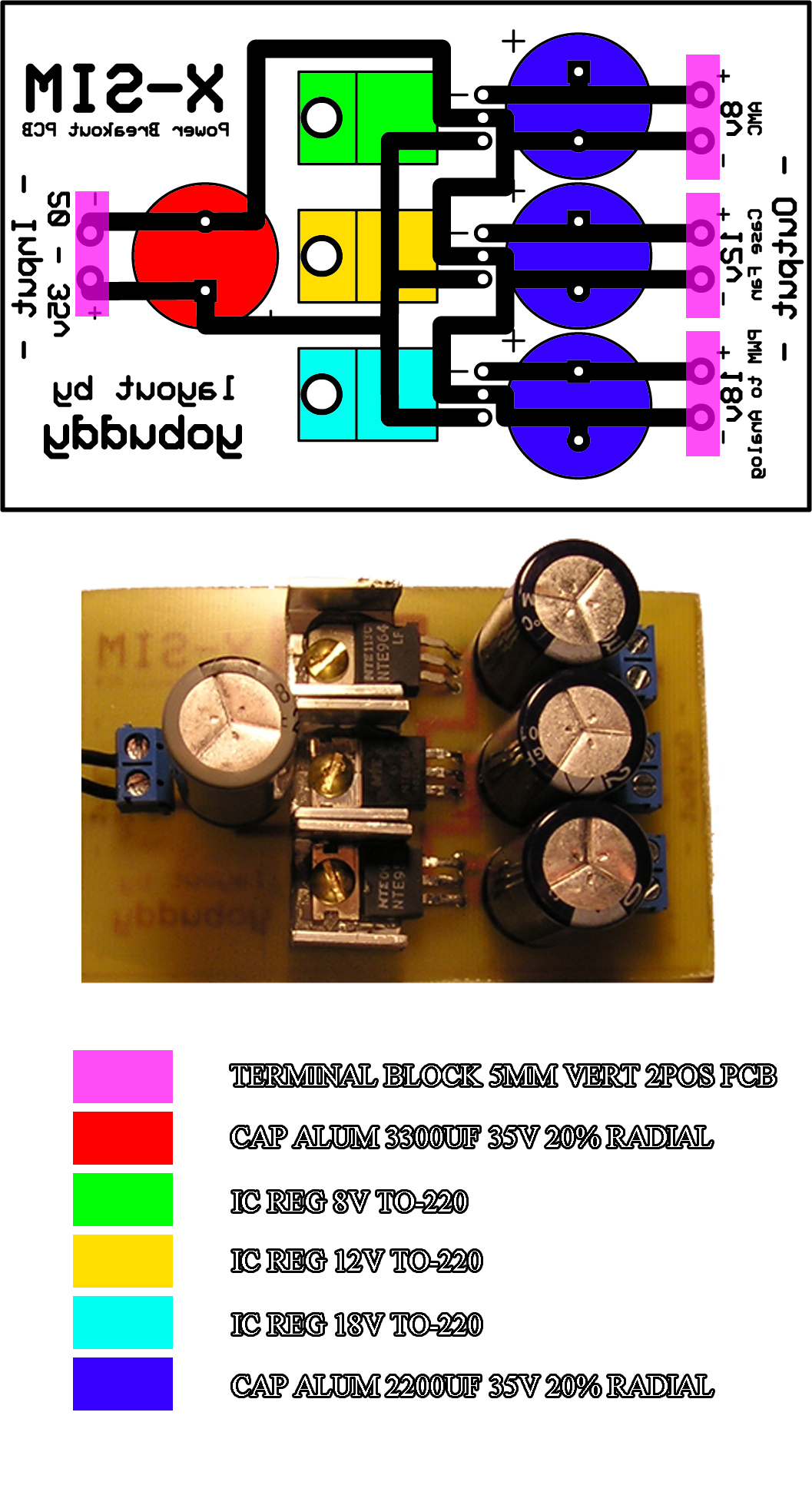

    My new X-Sim related Project is going to take multiple power inputs, and since I do not want to use multiple power packs, I made a X-Sim Power Breakout Board!
    I figured some of you may find it useful so I decided to post it. :cheers:
    Key Notes:
    -Replaces multiple power packs with one (suggested 24v) 20 – 35v Power Pack! (Or a couple of volts over your highest voltage regulator used.)
    -Multiple power filters for very clean supply lines.
    -Can supply you with 3 different voltages from one 3.5 x 2.2 inch board.
    (You can change the voltage regulators to what ever suits your needs.)
    How To:
    PCB Layout:
    X_SIM ~ Power Breakout PCB.pdf
