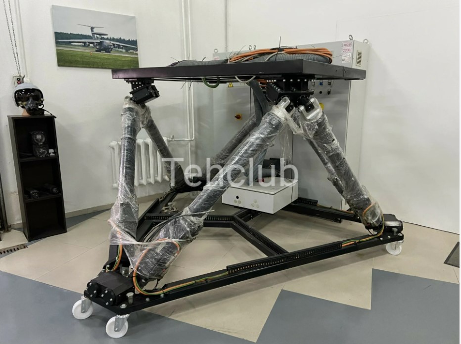

    My friend has a 6dof X620-EA platform from XesaSystems.
    Here are some technical specifications:
    - Dimensions (L×W×H): 3900×2450×2950mm
    - Weight: 1900kg
    - Centre of Mass (L×W×H): 1700×1200×1400mm
    - Pitch: +/- 23°
    - Roll: +/- 23°
    - Heave (usable): 650mm (+/- 325mm)
    - Payload: 2000kg at 550mm in height from C.G.
    A friend of mine has successfully used this platform with X-Plane Flight Simulator and Microsoft Flight Simulator, but there are no plugins to support other simulators.
    XesaSystems support is not working because the company has ceased operations.
    I really want to try to control the X620-EA platform with SimTools or FlyPT Mover.
    In the near future, I will try to visit my friend and study the platform in more detail.
    At the moment, it is known that the platform is driven by six actuators with servos. The controller is a Siemens PLC.
    Has anyone worked with XesaSystems platforms and software?

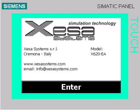

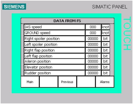

    Here are some images of the Siemens PLC touchscreen from the platform's technical description:
    I will receive detailed information about the engines and drivers soon.

    2. Do not remove the Siemens PLC and use the X-Sys software that was supplied with the platform upon purchase.
    Based on the information we were able to find, the X-Sys software can receive UDP packets from third-party simulation software.
    Then you can try to use, for example, FlyPT Mover as a "third-party simulation software" by setting the output string of the required format in the UDP port that the X-Sys software listens to.
    All that remains is to find a protocol by which the X-Sys software will interact with the third-party simulation software.

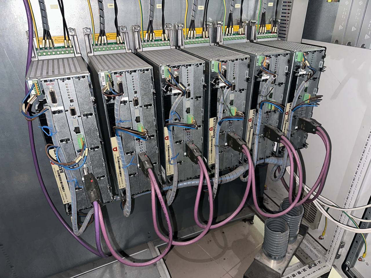

    Servomotors: Baumuller DSC 071 S64U20-5 TENV
    Drivers: Baumuller BM4423-ST1-01200-03
    Controller: CPU S7-300
    PLC Siemens TP177A
    Drivers are controlled by the PROFIBUS protocol
    I will continue to search for information

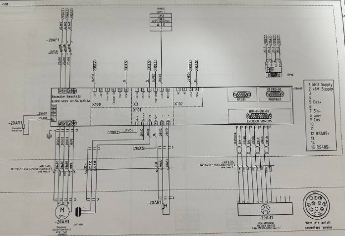

    Found a picture of the connection diagram. The diagram shows that there is a RS-485 port.

    Hmm, I can find a "Kurzanleitung" (quick reference manual) in the download area at Baumueller. The connections of the motor, encoder, brake and safety signals are mentioned there. But unfortunatelly, I don't find any information about the command signals. Your schematics show "X1 Profibus" and an RS485 connector next to it. Maybe it's in the software/parameter manual.

    In the Baumueller documentation, the RS-485 is mentioned in the description of the encoder connector (page 211 bmaXX-bm4000.pdf).
    The additional DB-9 connector is listed as Ethernet/RS232 (pages 201-204 bmaXX-bm4000.pdf).
    I didn't find the same driver in the documentation as in my photo.
