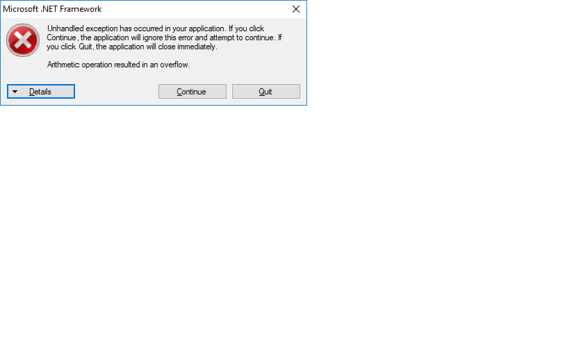

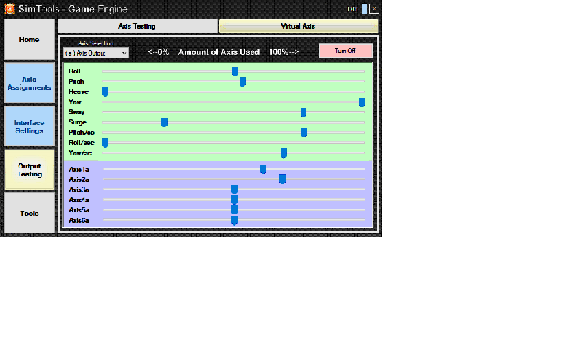

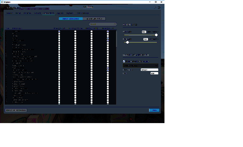

    I am using the Xplane plugin and it works fine when running Xplane. When I start Xplane through Flyinside I get errors (see attached) and crashes the game engine. I have checked the data output options in XPlane settings and they are the same as when not running via Flyinside (i.e only the recommended check boxes selected and no extra ones added) as I read this causes issue.
    For example if I try to turn on the virtual axis for testing I get errors (see attached).

    The issues are only when using through Flyinside.

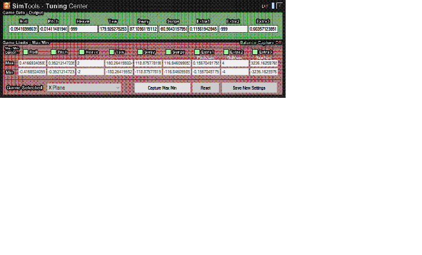

    Is this a known issue and if so how do people who use the plugin with Flyinside get around it. Also the extra2 and Heave values when using in Flyinside are -999. Again fine when not using Flyinside

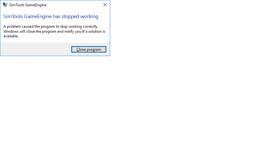

    On the times I can get it to work after a few minutes this is the error I get when it crashes. Untitled4.png

    Being that you got a "Arithmetic operation resulted in an overflow." error.
    It sounds like Flyinside alters the output data somehow.
    But let's wait to see what other are doing, as I'm not currently using this title.

    Updated X plane 11 last night and the data output settings in Xplane UDP speed was on 20 so changed back to 99.9 and it is now working without errors.
