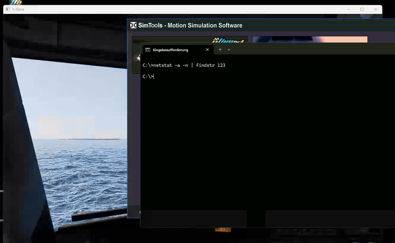

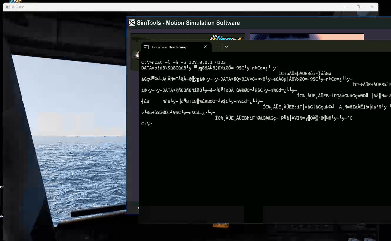

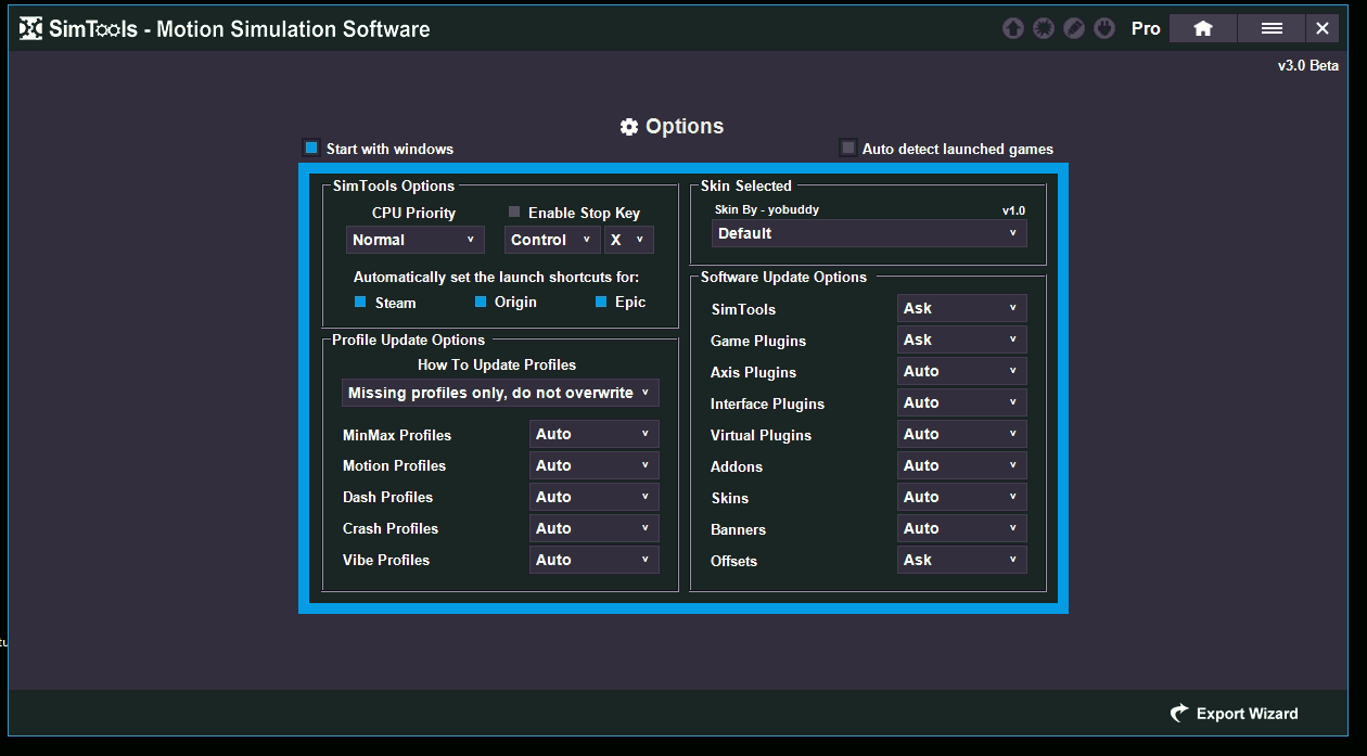

    I cannot get the xplane 12 plugin to listen on UDP/4123.
    When I look at the output of `netstat -a -n` no process listens on 4123. When I listen on UDP/4123 using netcat I get telemetry data from xplane. Dragging the steam://-link from the desktop onto the plugin associates it (it is visible as steam game in the configuration export) but pressing the play button doesn't start the game either.
    What am I doing wrong?

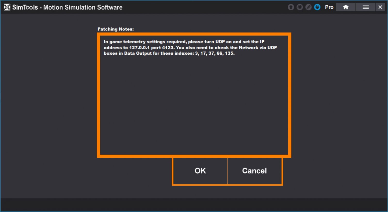

    Have you configured the required in-game settings:

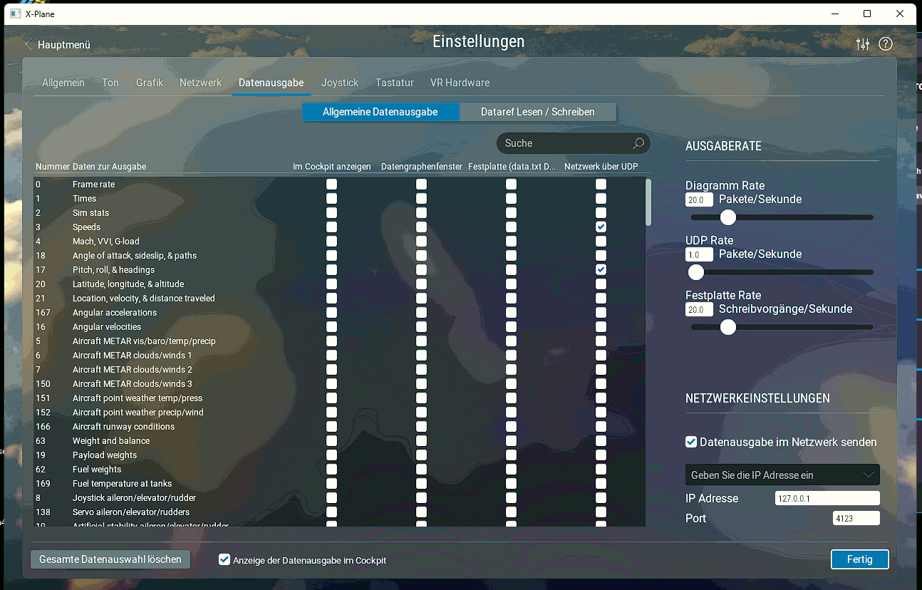

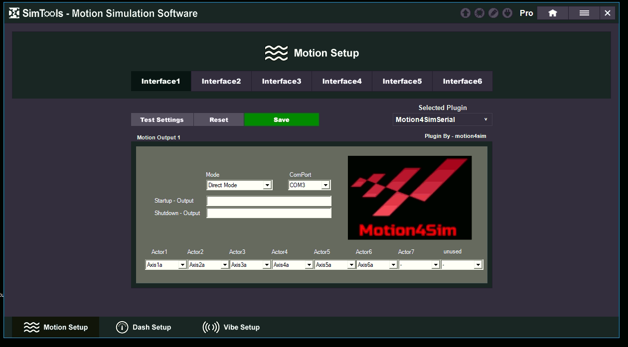

    836 shows the interface configuration
    837 the simtools options page
    838 the xplane data output configuration

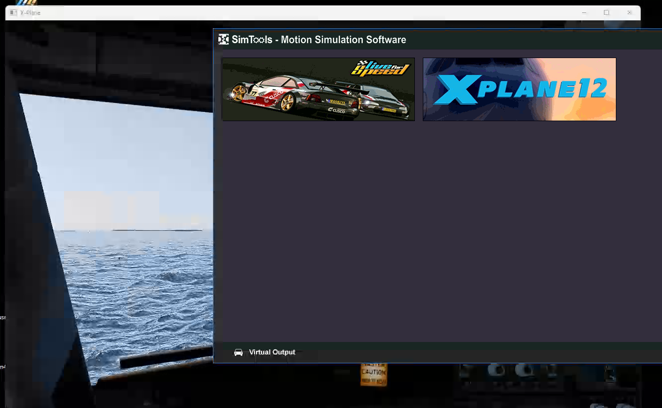

    839 that simtools doesnt detect that xplane is running
    840 that xplane is definately sending telemetry to 127.0.0.1 4123
    841 that nothing is listening on 4123 (neither simtools, nor is any other process blocking the port)

    looking for the 1000th time at the settings i now recognize that "auto detect launched games" was turned off.
    when i turn it on it detects that games are running again. when simtools detects that xplane is running it also starts to listen on 4123 and receives data again \o/
    how is this supposed to work without "auto detect" if at all?
    21,620
    151,377Coins
    +11,035 / 56 / -2
    Off the top of my head I am pretty sure you can manually start the plugin by hovering over it in the SimTools home screen, and double-clicking play.

    yeah - i didn't try to double-click since everything else uses single-clicks :) sometimes it's the small things
