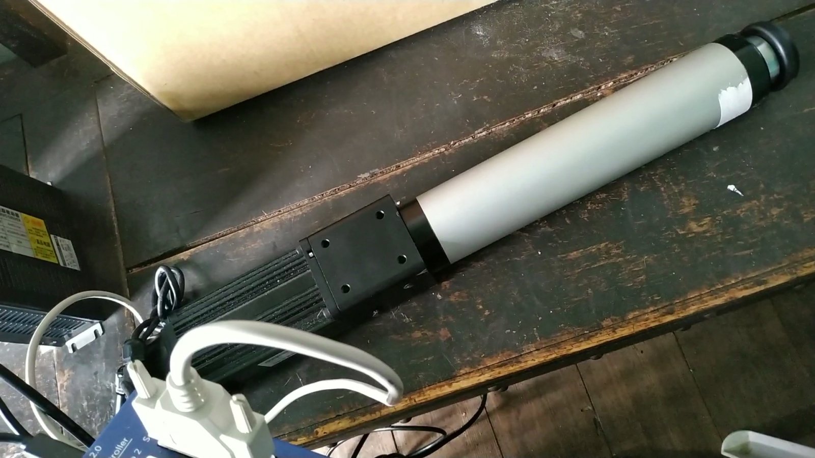

    Well, the first components for the mean machine :grin arrived and looking to see how it works and tweaks to be made...
    A photo of the first kicks :cool:
    @Thanos your controller looks great... looking to see how to optimize it.

    @Thanos I have a strange behaviour, (have 4 actuators) when I put the controller on, the actuators 2, 3, and 4 move 2/3mm forward and nr1 is stand still at Zero position.
    What might be?

    Yes checked manual, been looking till now your videos...
    Thr strange is that only one is calibrating, the other three doesn't make it. Has soon I connect them to your controller it makes C then P automatically. If I use the nr 1 it calibrate.
    Checked all the cables, servos settings,...
    Don't know what might be...
    Have any idea?!
    All of them are servo AASD-20A, servomotor of 1Kw 80ST-MO4025

    Well @Thanos , after checking all parameters in drives, wiring,... I was having the same symptoms.
    So, had made a reset to Servo Drives, program like in the manual, and now finally it's working.
    Something wrong must had been done when they had programmed in the factory, because I introduce the same values and they are performing well.
    Thanks for the support

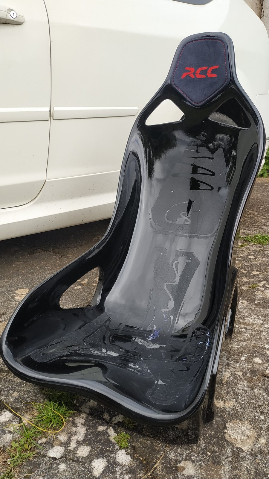

    Well another piece of the "puzzle" arrived, what is a simulator without it...

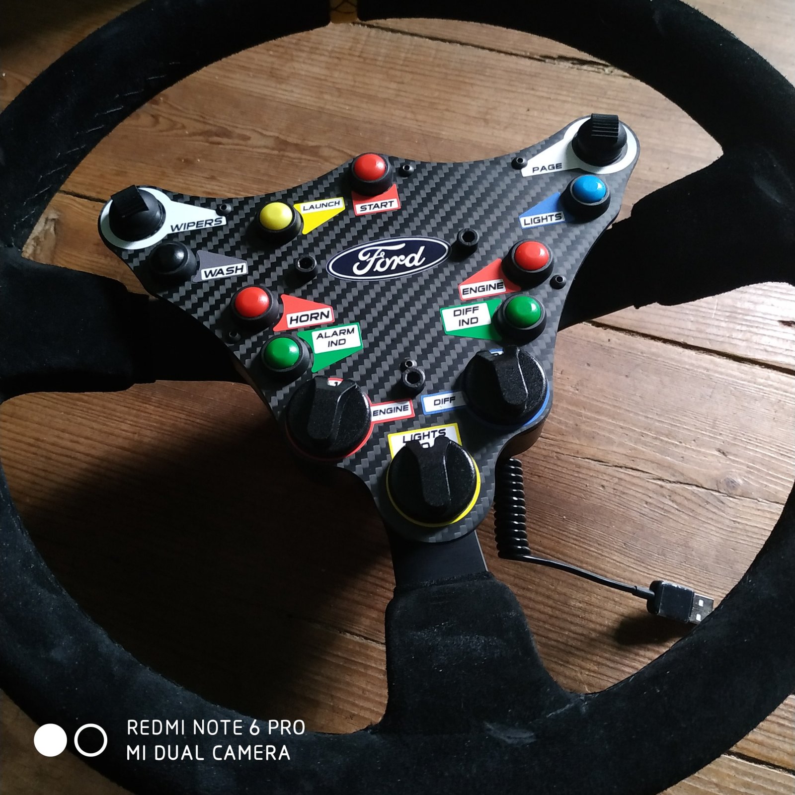

    Hi everyone,
    An update, just to notice that a new component arrived for the cockpit of my platform.

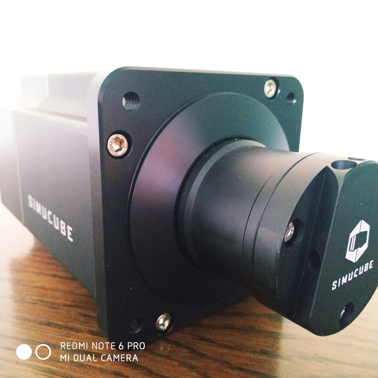

    Saw that there is a sort of Bluetooth HID controller that can place in the wheel, so that can use the wireless feature of the Simucube2 Pro
    Anyone knows where to get these controllers?
