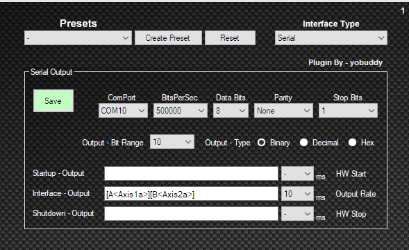

    So it defiantly just your Arduino disconnecting.
    What is your output rate for the Arduino?
    Maybe set it to 10 for a test?
  9. Cartman_SP69
    Cartman_SP69 Member
    May 17, 2018
    60
    IT
    South Africa
    384Coins
    +15 / 0 / -0
