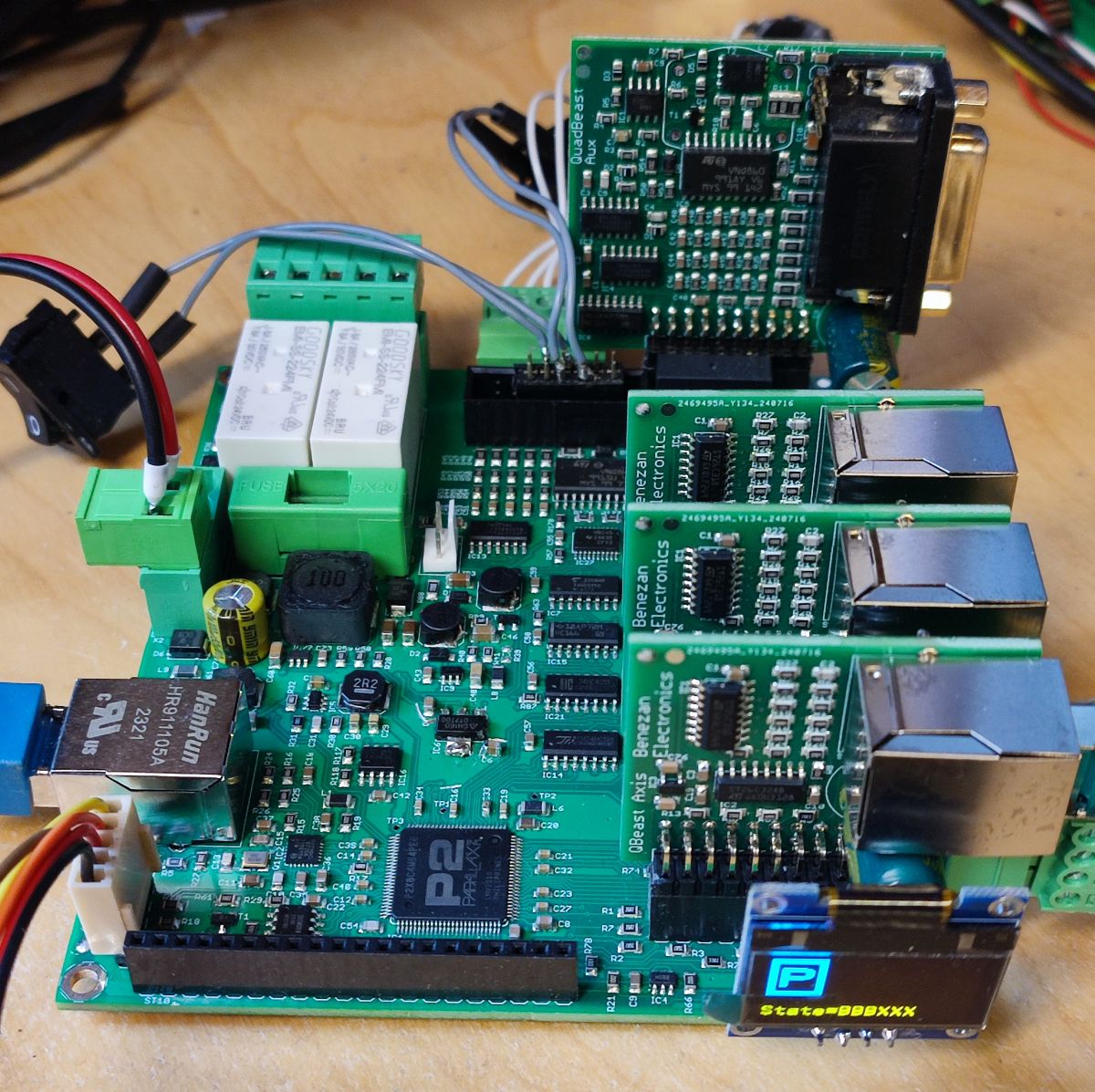

    Ther is currently no real reason why I started this project other than "because I can". It basically receives data from FlyPT Mover and converts that to step/direction signals to the motor drivers. So nothing new that some other controller couldn't also do, for example the sim4motion board. But I'd like to have a bit more control over some features and I see it as a challange to try to get better performance. And I don't feel comfortable doing a "beggars dance" to get answers to my admittedly numerous and possibly annoying questions. So I decided to build my own.
    It might look a bit ugly and over-complicated. To avoid having to build everything from scratch I took the motherboard from a CNC controller I've already designed and only changed the daughter boards. Originally there were stepper motor drivers. I replaced them by small boards with differential line drivers which are connected to the servo drives with RJ45 patch cables for the step/dir signals.
    Some specifications:
    • 24V power supply
    • 8-core 200MHz CPU
    • 100Mb/s Ethernet port for UDP connection
    • up to 5 axes, 2MHz max. step frequency (new: now 6 axers)
    • 4 outputs, 9 inputs 24V
    • safety support (Estop, STO and brakes)
    • OLED status display
    I know, 5 axes are too few for most users. But that's a limitation of the current motherboard, not the processor. The CPU has plenty of resources left over (pins, timers...) so as soon as I need it I can make a bigger board.
    Today, I ran the first test. I can receive data from FlyPT mover and move one motor with the sliders in the RIG window. Homing, moving to neutral position and parking also works.

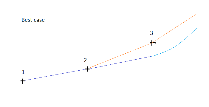

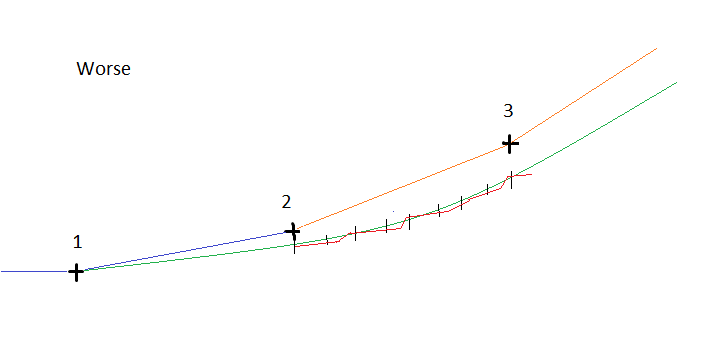

    I've been thinking about this for some time... So the best thing we can do is this:
    We get position data from the sim software, say every 16ms (black points marked 1,2,3). As the real world is analogue and continous we have to interpolate between thise discrete points somehow. The problem is we can't see into the future. So at the moment we get point #2 we can calculate the current speed and extrapolate that into the interval from 2 to 3. But we do not know the value of #3 until that time has passed and we get the actual value.
    So at the time of #3 we find out that our "guess" (the blue line) was wrong and we lag behind and have to catch up. It doesn't matter if we have some sort of "intelligent" algorithm or just apply a numerical filter. The result is a curve that has some unavoidable time delay and ideally has no sharp corners but instead smooth bends. All we can do is to try not to make it worse than necessary.
    As I already pointed out in the FlyPT Mover thread if we are not careful jitter can have a bad effect. For example, if the 16ms interval is divided into 8 times 2ms at first it looks like an improvement (green line). But if those additional data points are transmitted with unpredictable delay of +/- 1m what we actually get is the red line. The position deviations don't seem very big but look at the slope angles! The angle = rate of change of position = velocity can change by a factor of 3:1 or more!
    The irony in this is that the better the servos are the worse the control loop behaviour becomes. Cheap servos only count pulses and apply heavy filtering to reduce aliasing effects caused by that quantisation. There reaction time is so long they don't even notice the jitter and noise in the velocity. But good servos have a high bandwidth (>1kHz) and calculate velocity feed forward by measuring the frequency of the command input as inverse of the time between pulses. This results in a fast reaction time, low following error and stiff response. But it also makes them sensitive to signals of bad quality.
    Anyway... Transmitting data packets at a rate close to the timing jitter and transmission delay (2ms vs. 1ms) is no good idea, IMHO. We have to smoothen the errors out later, anyway. So the high data rate is only a waste of bandwidth and CPU power. I think this is why your turkish customer with the big Boeing cockpit got better results after reducing the data rate.
    Using "high quality" servo systems for sim rigs seems also like a waste of money. They might have some advantages like probably making additional transducers (bass shakers) unnecessary as they have enough bandwidth well into the audible range and could take over that task. But it's most likely not worth the trouble.

    Thank you for the demonstration. Such behavior was what I expected, that the data is always ahead of the motor positions and the servo or Stepper driver, since there is also an MCU inside, calculates that.
    Our goal is therefore to send continuous data sets without jitter, and our approach is to send a pulse train to the current position.
    Yes, and that's exactly what we do. The M4S sends the upcoming pulses every two milliseconds to the drive and thats it. So we can also create bass shakers with the AASD drivers with frequencies up to 500 Hz without any issue. i know there are other drivers in the market can do lower but they also cost a lot more money.
    What I have to admit now is that the M4S code always waits for the packet from FlyPT before incorporating it into the calculation. Therefore, there may be a kind of jitter in that process, it is.
    possible.
    But the issue is also known to me, and I have routines running in M4S that do not wait for the signal from FlyPT and continuously incorporate the incoming data with a filter algorithm. but 2 years ago as i was testing this on my sim there was no difference in the feeling so i didnt change it.
    But as I mentioned before, my approach was to split the signal more finely and smooth it out, which is why we send the pulses every 2 milliseconds instead of every 16 milliseconds. And it works as best with the servos used from the community here.
    the m4s generates the pulse train with the hardware timers/pwm inside the mcu (enable hardwaretimeimg for higher frequencies) otherwise its interrupt driven. Pulses generated by hardware timers are as precise as it gets.
    If we send the pulses with a higher delay maybe the simflying comunity will have smoother sailing feeling in long moves, the sim racers will not be satisfied, as they will lose details in the motion they like it really hard .

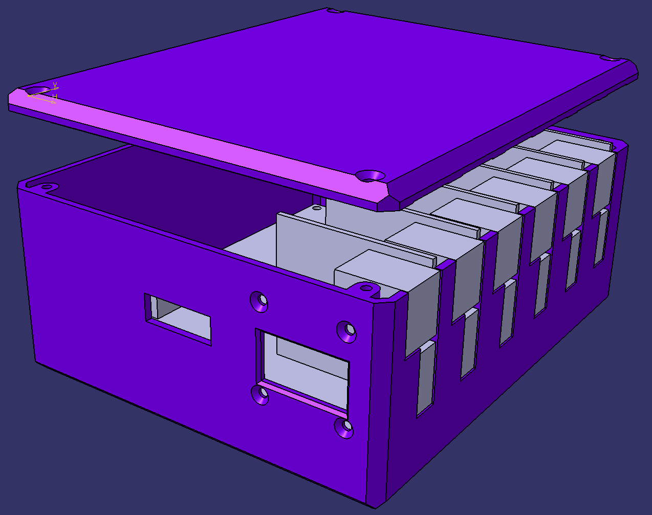

    I just made a drawing of a casing for my board:

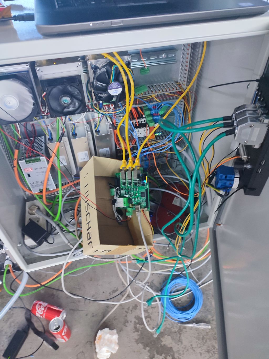

    We had problems with the 3D printer finishing the casing in time so we had to hook up an improvisation.
    P2-motion-controller_ratsnest.jpg :D
    The black box on the right side is the M4S controller that is now replaced by my new board in the cardboard box. After some minor problems with one of the servos faulting due to a popped connector we got the homing procedure going and could connect to FlyPT Mover.
    WOW! :o: The difference is like day and night.When we connected the controller to the simulator software for the first time I pushed the throttle with the brakes still engaged to make the plane slightly tilt forward. First, I thought it didn't work. I had to look at the motor shaft couplings to see that the servos were actually spinning. Everything was totally silent. We have used the exact same tuning of the servos and the exact same settings in the Mover except that we replaced the serial output with UDP.
    But the behaviour is totally different. No more whisteling and grunting noises, no vibrations. Every tuft of grass on the runway could be felt while rolling on the ground and it was a perfectly floating glide while in the air. We had big grins in our faces.
    :grin
    However, there still seems to be a bug in the homing procedure. The parking position above the home switches is multiple cm too high and not equal on all actuators. I have to fix that.
