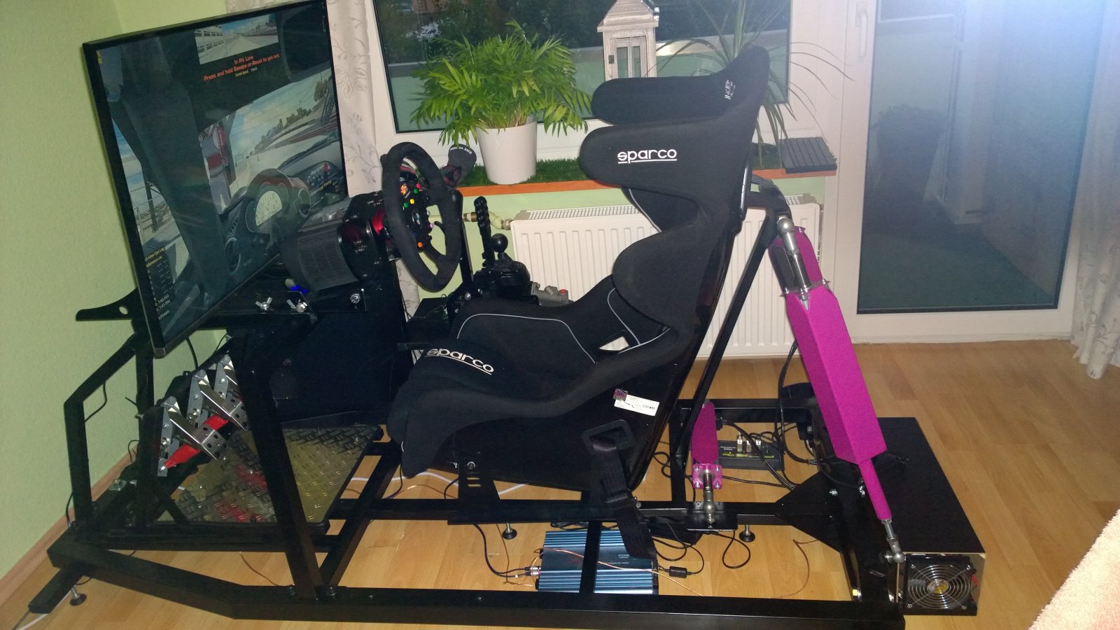

    WP_20170104_16_50_52_Pro.jpg 15942110_10153904296092242_433952546_n.jpg IMG_0951 (Custom).JPG Ok guys this is one awesome site if anything theirs just a bit to much information i am really finding myself in need of a bit of direction.

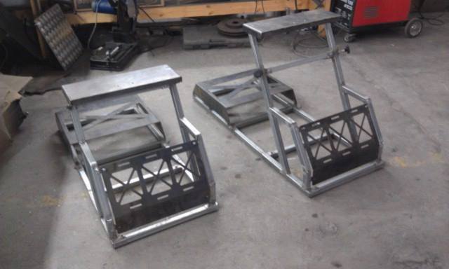

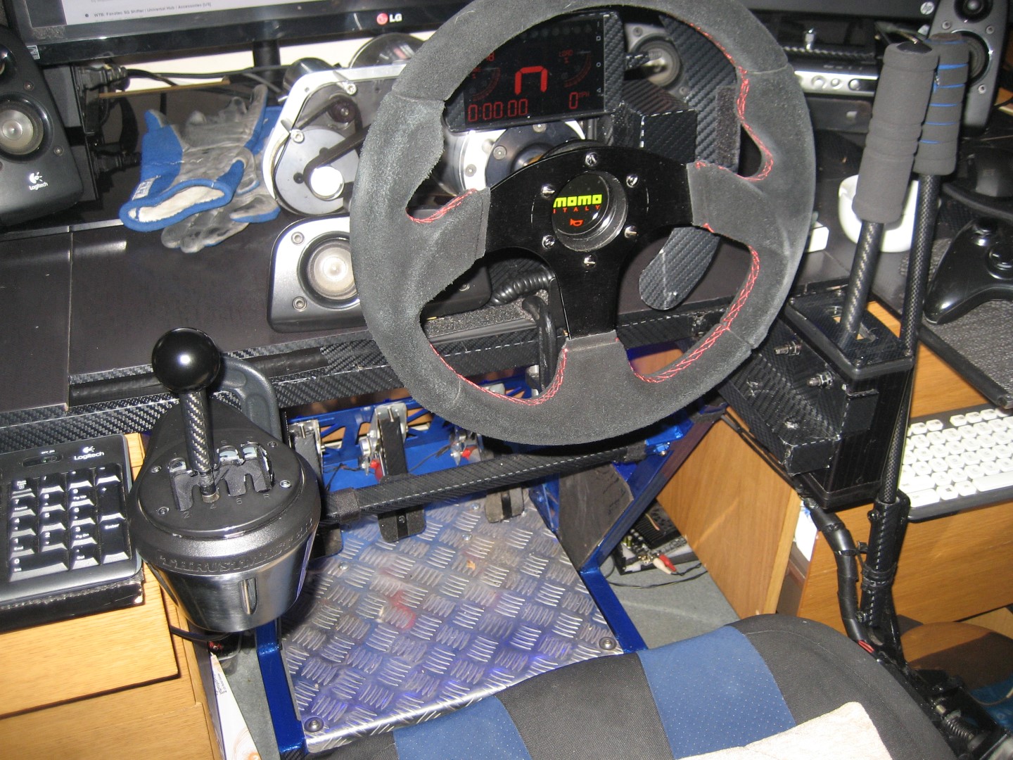

    I am mainly involved with rally sims Dirt Rbr etc so would like to incorporate rear slip into my design, i have 2 rigs basically the same design one i use which i use the back end and pedals part and one i have complete.
    The design of the rig lends itself to motion so would be a good base.to start with i would like to incorporate just the seat element then later if i like the idea will progress to 2 extra fronts.
    I like the design of this platform and have contacted frex for a quote for the parts included here.However i would like to have a idea as to if i wanted to achieve similar results with DC motors what would be the equivalent needed parts to achieve a similar result
    Any help would be much appreciated.

    Here is a basic list for a 2DOF DC option, which would likely out perform and outlast a Frex system and which you can add additional DOF to like traction loss.
    You would need some decent DC motors with 25:1 or 50:1 wormdrive gearboxes, depending on final design, something like these: http://www.ebay.com/itm/GEAR-MOTOR-...384?pt=LH_DefaultDomain_0&hash=item51bd392f00
    There are other potential sources for DC motors: https://www.xsimulator.net/community/faq/dc-motors-shopping-list.32/
    You need 2 JRK 12V12 control boards (simple to set up but a bit more expensive): http://www.pololu.com/product/1393/
    Or an Arduino and 2 Motor Monster or similar boards (cheaper but a bit more work to setup).
    2 potentiometers, I use Hall sensors as you can't break them if over rotated, they have good resolution and are very durable: http://au.element14.com/bi-technolo...fs/sensor-hall-0-2v-20v-to-10v-pin/dp/2319662
    2 flexible coupling of the right size to connect the motor shaft to the pots: http://www.ebay.com/sch/i.html?_odk...0&_nkw=flexible+coupling+10mm+6.35mm&_sacat=0
    2 HP Server PSUs: http://www.xsimulator.net/community/threads/how-to-modify-a-server-power-supply-for-12v.5774/
    An old car tailshaft to use for the universal joint.
    Some switches, fuses and wiring.

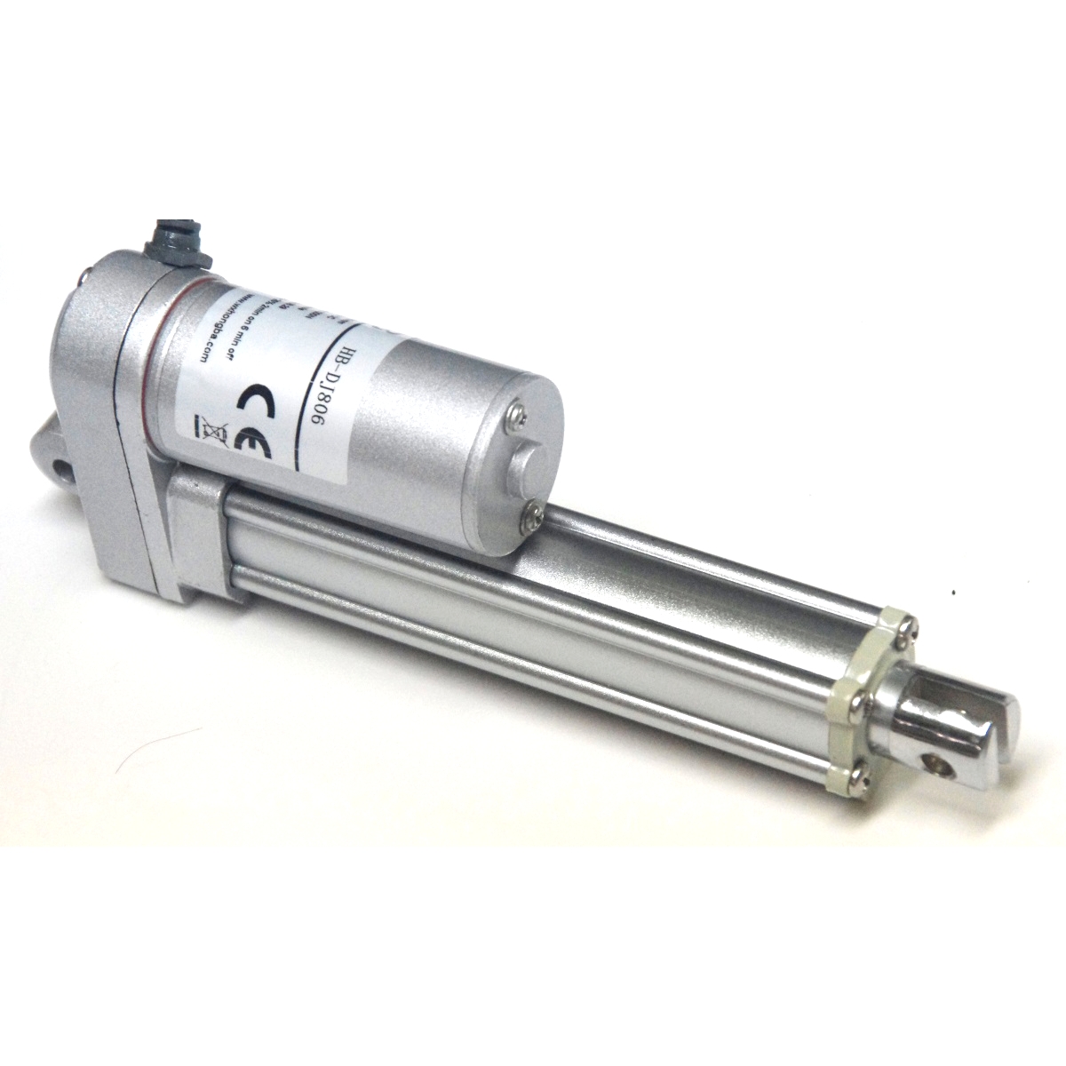

    hmm 1000 bucks for 2 dc motor setup doesn't shout out bargain i am still wondering why the dc motor powered unit in the design of a actuator isn't popular and there 80 euros
    surely it would be ideal for motion setups or am i missing something.

    Look at the specs (5mm/s), most do not come close to the speed of what is needed for good motion 200mm/s+.
