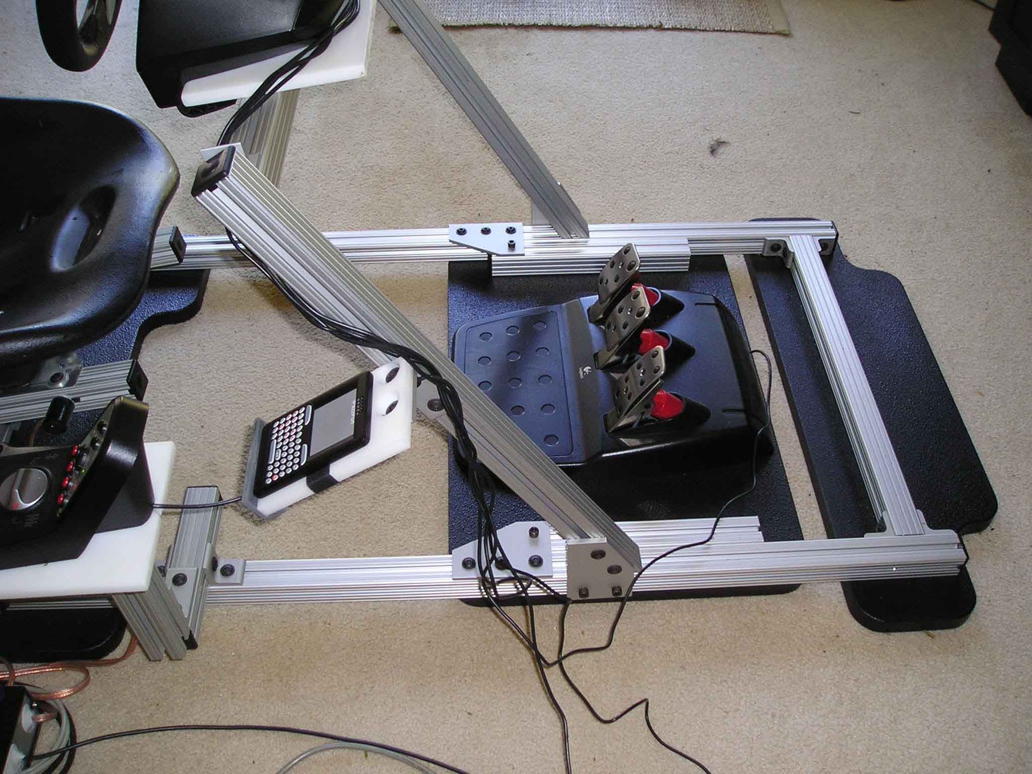

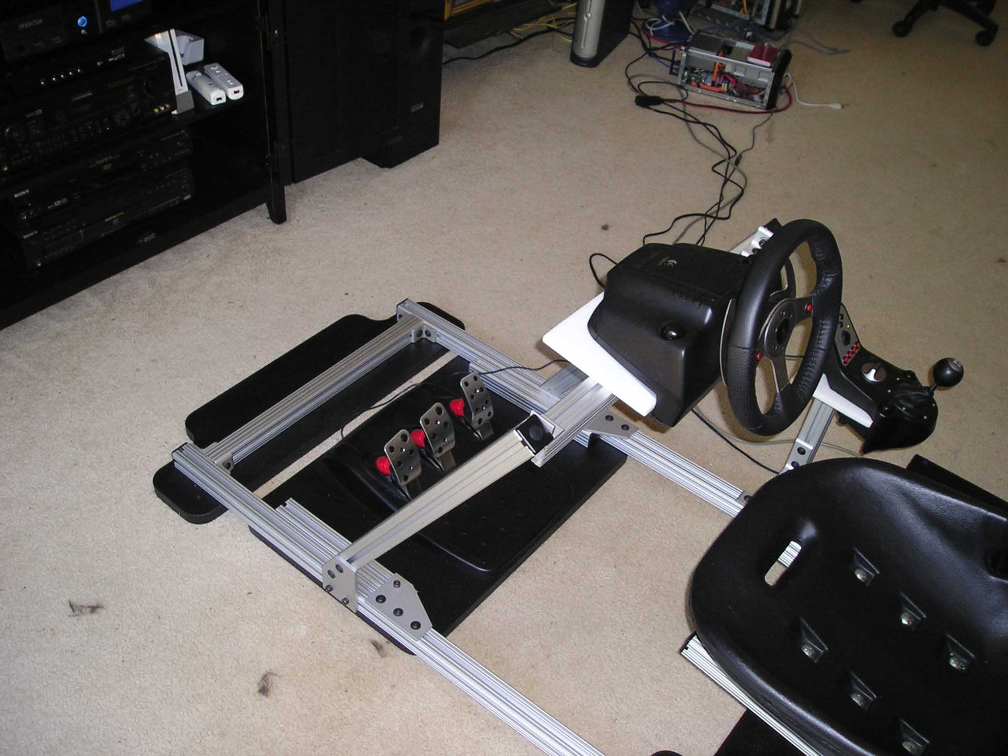

    What’s up everyone?
    I just wanted to open a post on my new SimforceGT simulator.
    There are a few custom features that I will try to explain over time.
    For now – Ill post some pictures to give you an idea of where I am going with it.

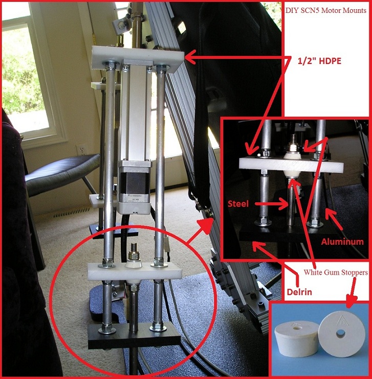

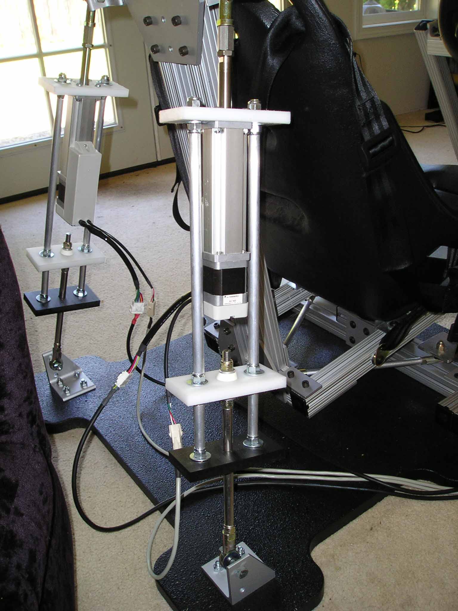

    The best upgrade I did to this sim version is the MDF base sprayed with bed liner!
    Almost zero vibrations to the floor!
    The built in dampeners in the motor mounts help too!
    My wife sleeps 12 feet away from the sim, and I can play all night long! lol :yippiee:
    Man I need some sleep! lol
    Anyway the good stuff
    Hope to have some vid's soon!

    The spray on truck liner is a good idea. I still can't imagine that it won't hop around and flex the board, but I'm looking forward to the vid and cooresponding motion profile.
    If this mechanism stops the flexing and jumping, then it may be a good alternative to steel.

    Regarding the plastic pieces. I have some of this material at home as well, and this stuff is quite rigid. One can drill screws into it even. I wonder that it dampens at all btw.
    regards

    The base is made of mdf (stiff wood) – the same stuff they make speaker boxes out of.
    Then it’s covered with bed liner.
    The HDPE plastic is just for the steering wheel and shifter mount.

  12. yobuddy
    5,372
    50,264Coins
    +5,147 / 18 / -0

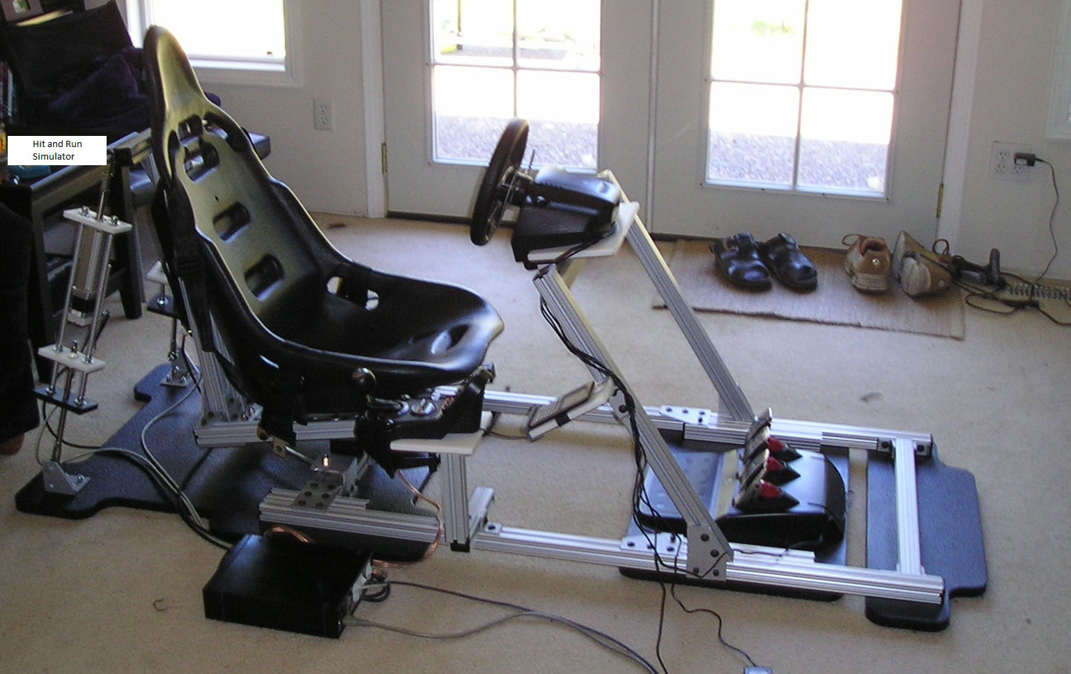

    Here is an up close look at the DIY SCN5 Motor Mounts and shock absorbers. :hi:

    Great Sim yobuddy,let us see how your chair rocks! Even with dampers I can´t hardly imagine, that your wife is able to sleep in near of that thing - i speak from my own experience :)
